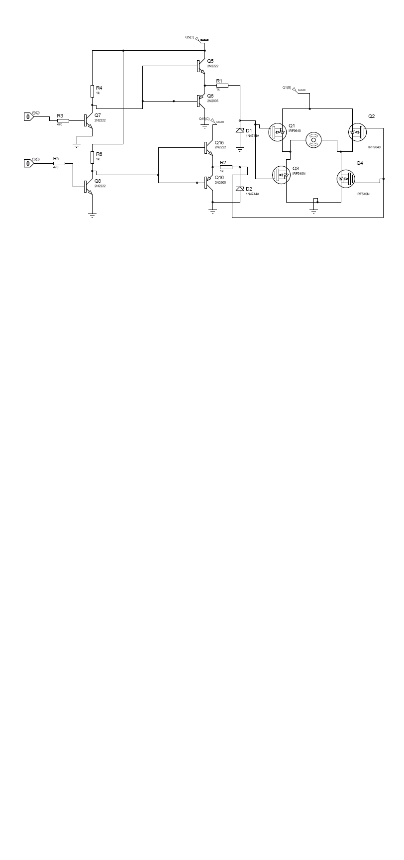

I think the driver circuit for the Mosfets should be like this:
thanks dknguyen
i understood the problem i reversed the C of the PNP's to be E
audioguru , thanks

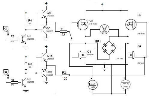

you choosed 22ohm , low resistacance to compensate the input capacitance of the mosfet ? to make it switch fast in fast PWM frequencies ? or what was the purpose ?
Yeah, he chose the 22ohms so that the gate capacitance would charge faster so you could switch the FETs faster. You might not need them at actually- only if your FETs turn on too fast and make too much noise or other problems.
There is a difference between the voltage that a transistor can withstand across it's primary terminals and across it's control (base/gate) terminal. SO a 600V transistor can withstand 600V across C-E or D-S, but it can only take a maximum of 20V at B (or G). He's asking because you might be thinking of powering your gate driver form the same source as your motor and if the source is too large you will destroy your transistor bases/gates. Check your datasheets for all your NPNs, PNPs, NMOSs, and PMOSs.
If the Mosfets don't switch very quickly then for a moment the top and bottom ones are both turned on and short the power supply. It is called the shoot-through current. Mosfet driver ICs have a small delay to prevent it.
The 22 ohm resistors should be very close to the gate of each Mosfet (4 are needed for your circuit) and stop the Mosfets from oscillating.
thanks for the reply ,
so its a hardware delay then right ?
the input to the transistors will be 5/0V from a microcontroller and the supply VCC to all transistors is 24V
Yeah, an RC-type timer thing with the gate capacitance and your gate resistor.
THat 24V supply will destroy the gates and bases on your transistors. Use a 12V or 15V regulator (depending on your MOSFETs and BJTs) to provude the power to your gate drive so you aren't driving the bases and gates beyond their voltage limits.

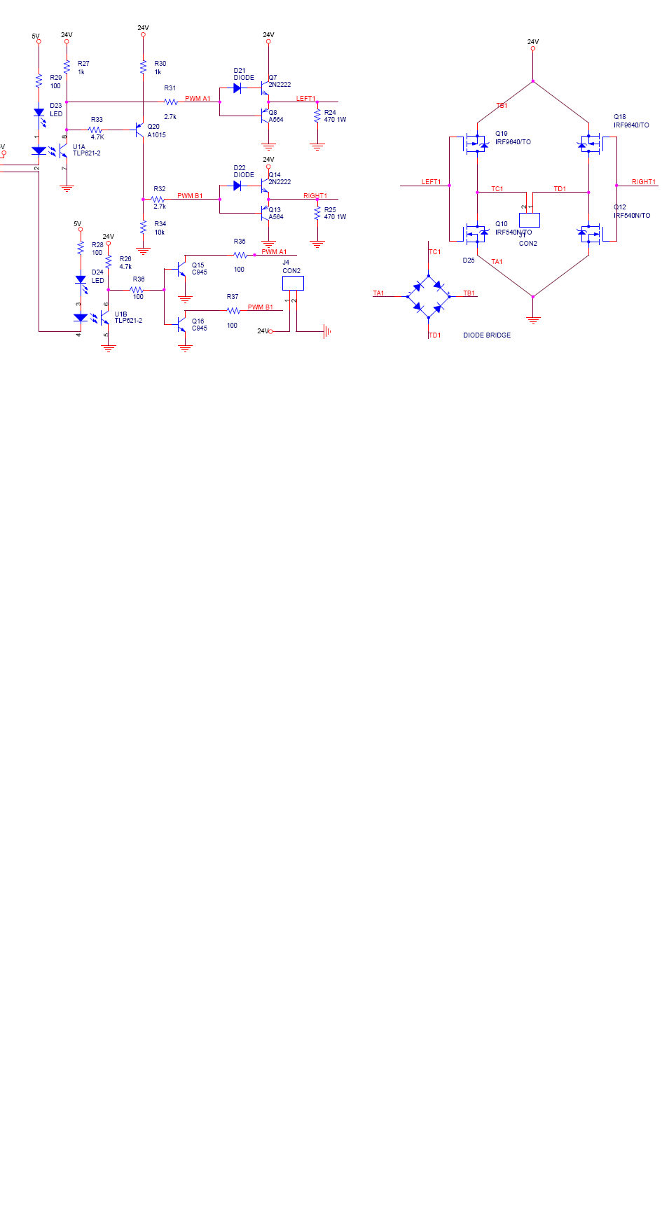

i saw this design and the designed used it and its worked and he used a 24V supply as you see , what's the difference between my circuit and this ? and which is better ..
That circuit has the PNP transistors the correct way around, yours are backwards.
The diodes and 470 ohm resistors reduce the max gate voltage to about 22.6V for the N-channel Mosfets. The gate voltage for the P-channel Mosfets is 24V.
But the absolute max allowed gate voltage for both Mosfets is only 20V. They are spec'd with 10V.
What about putting a 12V Zener diode at the Gate of each mosfet ?
