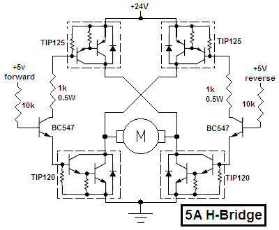

I used the same circuit and changed the P Mosfets to PNP TIP147 Transistors and N Channel Mosfets to NPN TIP142 transistor and the circuits doesnt work in the simulator ...

You must change the circuit to use darlington transistors like this:

thanks, can i change the tip mentioned to tip 147,142 to handle more amperes ?

thanks, can i change the tip mentioned to tip 147,142 to handle more amperes?
Of course. But then then base current is doubled so the 1k resistors must be changed to 470 ohms/2W. The base current for the BC547 transistors is also doubled so the 10k resistors should be changed to 4.7k.
The TIP142 and TIP147 each have a max saturation voltage loss of 3V at 10A so the motor will receive a minimum voltage of only 18V and the darlingtons will heat with 60W max.
