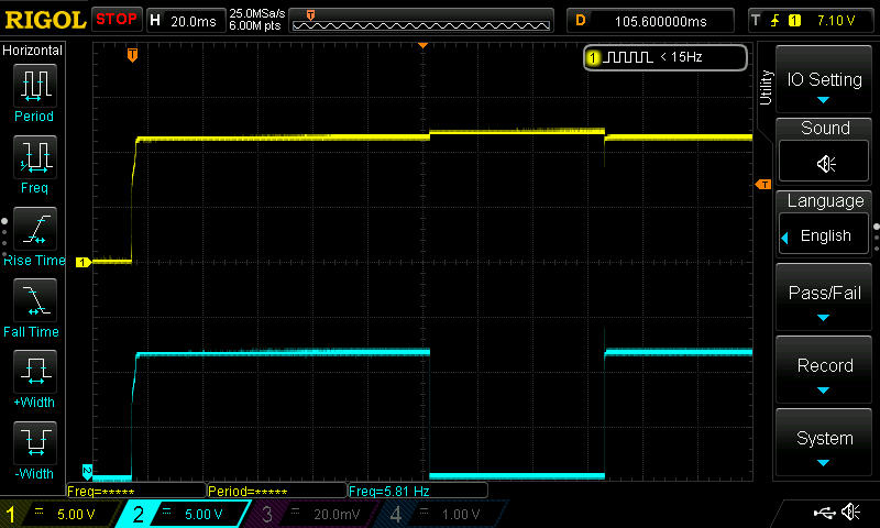

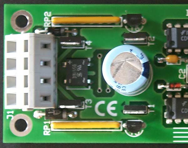

An H-bridge with discrete components (mosfets) did work in a prototype board, then also in a manufacured PCB, and in a another PCB version (same layout for the bridge) it refuses to oscillate. Difference with the new PCB is a slightly further positioning of Q17 (13mm). Tracks measured and ok, signals arrive at Q17 and its drain. When only using Q19 and Q18 oscillation is ok, when Q21 and Q20 inserted, no oscillation and high current draw. I make sure the 12V is applied only a second or so to avoid blowing the mosfets.
Source is a 555 timer with approx. 10Hz output.
I replaced the mosfets, still the same.
The trigger signal is 12V pp.
What could be wrong?
