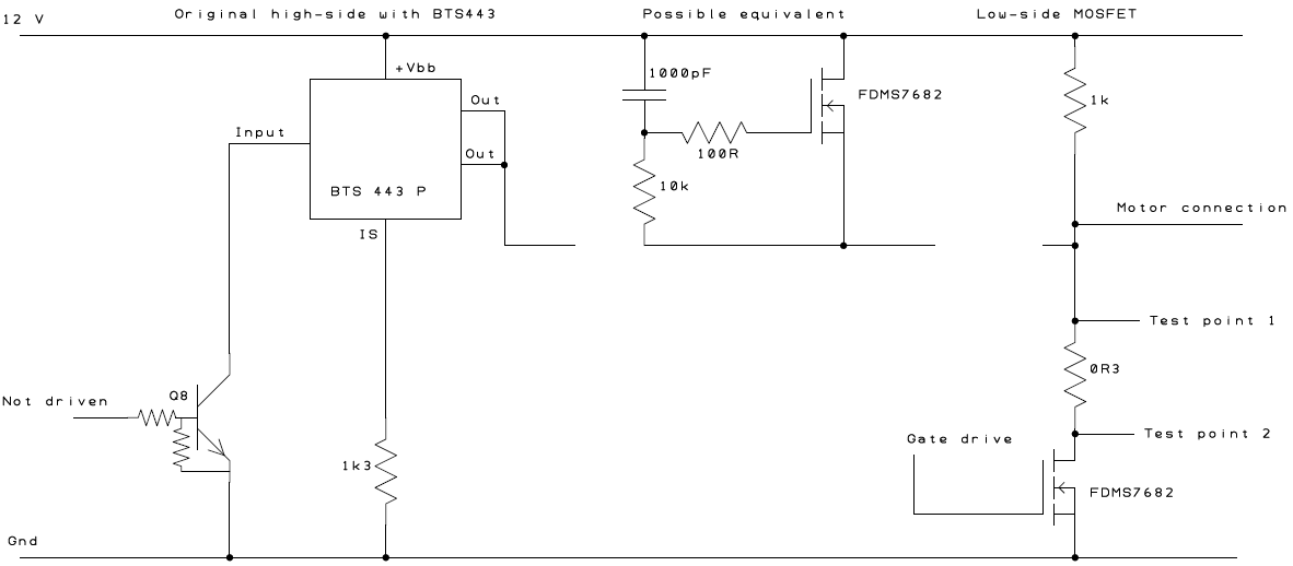

I put together an H-Bridge using BTS 443 P smart switches as the high side drivers and FDMS7682-d MOSFETs as the low side drivers. The schematic is attached. All the control and the feedback come from a microcontroller running on 3 V.
The H-bridge works and I can run the motor forwards and backward.
The problem is when I tried to run PWM. The BTS 443 P are not very fast, so the idea was to leave them on, and operate the MOSFETs from the PWM signal. When the MOSFETs turn on, the BTS 443 P that is turned off lets some current through for a few microseconds.
So if I am running forwards, the forward BTS 443 P is on all the time and the reverse BTS 443 P is off all the time. For PWM, the forward MOSFSET turn on and off at 20 kHz. The problem is that each time the forward MOSFET turns on, the reverse BTS 443 P lets current through for a short time. It is quite a lot of current, in excess of 15 A, and for several microseconds. That becomes a problem when the switching is happening at 20 kHz.

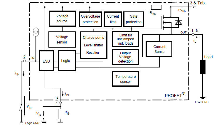

In the BTS443, there is a charge pump and the main output device is an N-MOSFET.
The input line only needs typically 0.7 mA, so the charge pump can't be very powerful. There has to be some capacitance to keep the gate at a voltage above the input voltage. When the input is turned off, there has to be a resistor to discharge the gate.
When the device is off, just about the whole IC is at the input voltage, and the gate of the MOSFET will have to be at that voltage as well.
With that in mind, I put together a circuit to mimic the IC, and I managed to get it to behave similarly in respect to the shoot through.

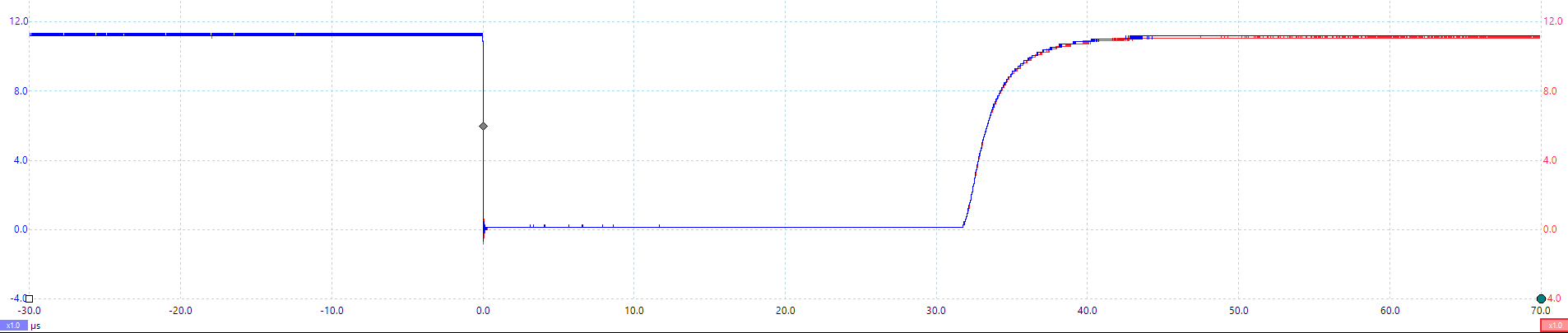

That shows the original high-side driver and the possible equivalent. For the tests I wasn't intentionally turing on the BTS443 or the discrete circuit. The low side driver was simply turned on for around 30 μs. Unsurprisingly, with just a 1 kOhm load, there is virtually no current consumed and the output waveform looked like this:-

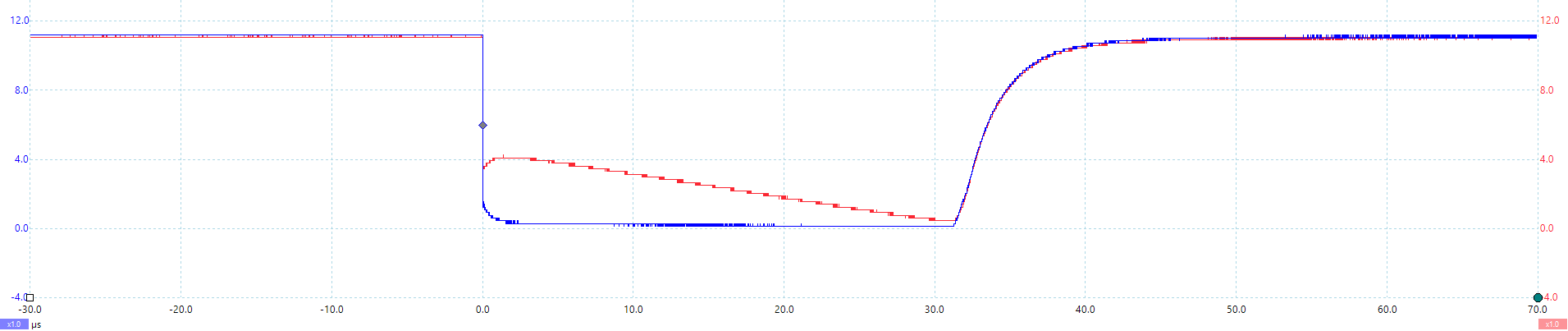

When I connected the BTS443, the waveform looked like this:-
There is a peak voltage across the 0.3 Ohm current-sense resistor of about 4 V, so there is about 12 A of shoot-through, taking about 30 μs to die down.

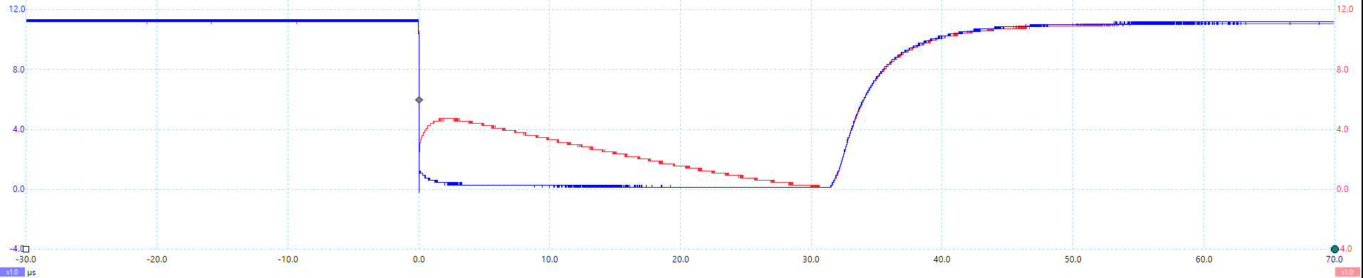

With the discrete circuit in connected, the waveform looked like this:-
That's very similar to the waveform with the BTS443. I think that capacitance within the BTS443 is acting like a bootstrap capacitor and turning on the output MOSFET.

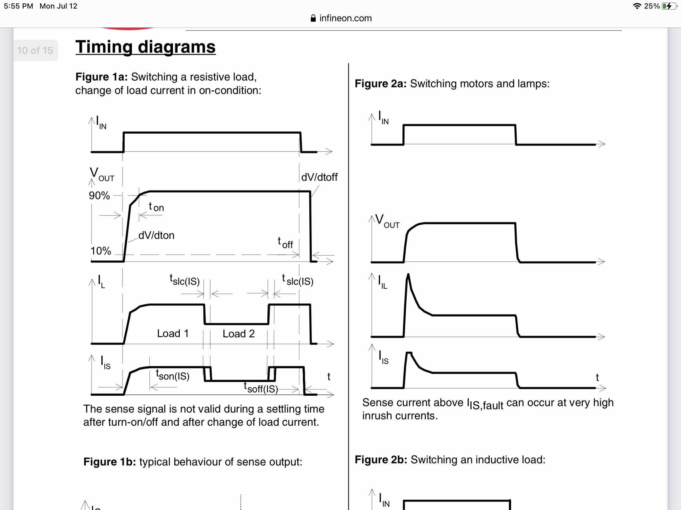

I spoke to colleagues and someone suggested this application note: **broken link removed**
That talks about the problem of MOSFETs turning themselves on with high rates of change of voltage.
