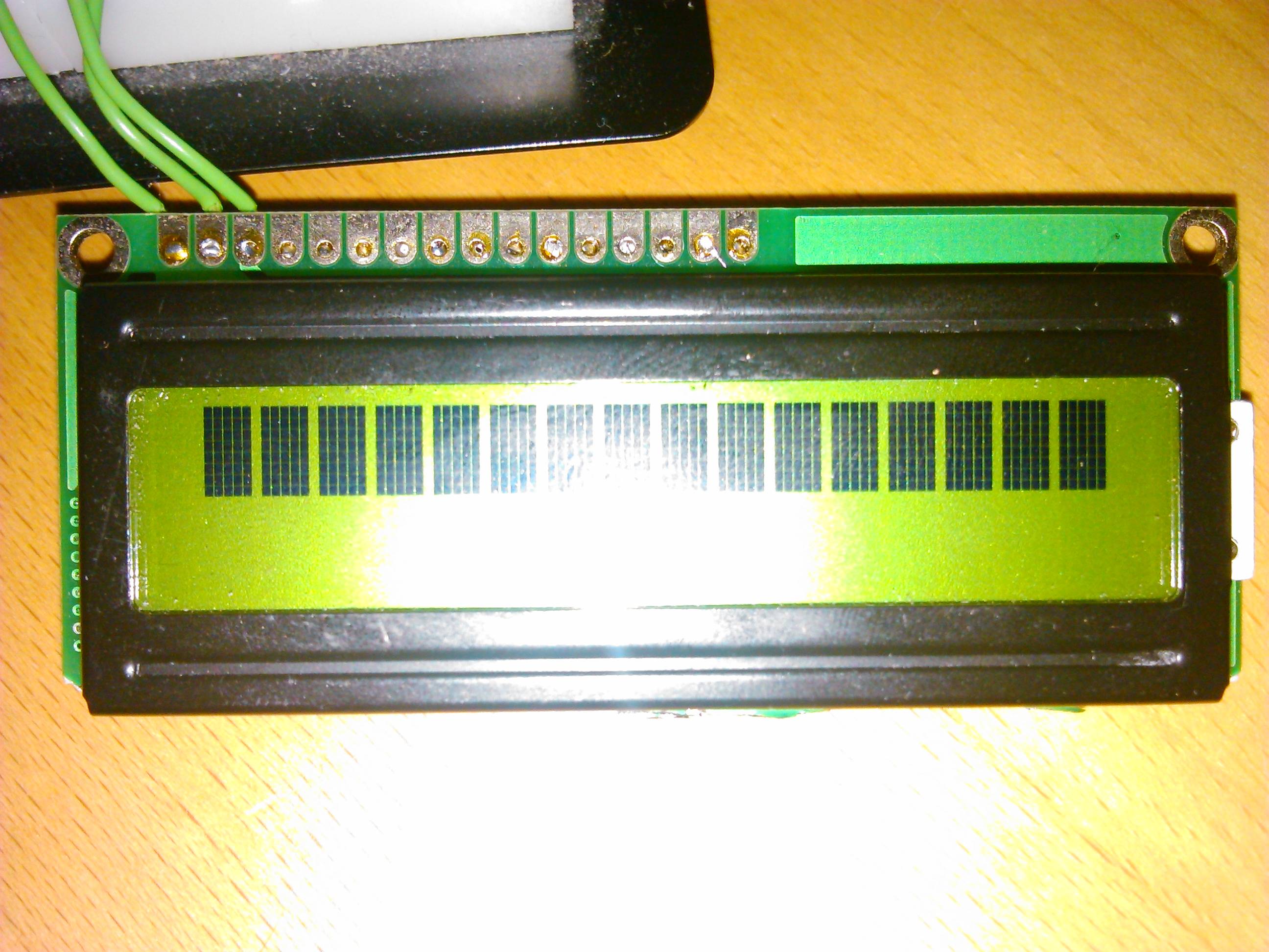

I'm working on a little project using a pic16f628a , hc595 and a 4780 LCD display in 8 bit mode , but i just get a black screen .
i'm not sure if it is a hardware or software problem ..
This is the code i'm using

i just added the code for the 595 and 4780 to make it easy to read but i do have the comparators turned off and the 595 works. tested it using LED's .. I also use a 10k trimpot to adjust the contrast ..

i did try to swap
LCD_RS PORTA,3 --> PORTB,3
LCD_E PORTA,4 --> PORTB,0
They both have pullup resistors but no luck ...
Just tested the (bit) of code you posted.... With a 10k pullup on RA4 it works well!!
EDIT!!!
I noticed you have named PORTA,0 pin_q7... I know this connects to the DS pin... You haven't connected it to Q7???
sorry about the messy code RA0 (pin 17) is connected to pin 14 (DS) on the 595 .. I i will try to add the pull up resistor and see if that helps i just need to put stuff back on the breadboard first :)btw the loop was just for testing and will be removed as soon as i got things working
i have gone trough the wiring and added the pull up resistor but the display is just looking like this .. could it be a timing issue ?
this is the config settings i'm using not sure if it's the problem
__CONFIG _FOSC_INTOSCIO & _WDTE_OFF & _PWRTE_OFF & _MCLRE_OFF & _BOREN_OFF & _LVP_OFF & _CPD_OFF & _CP_OFF
