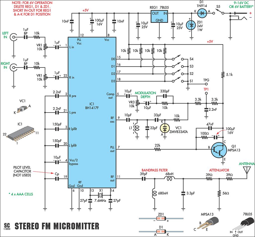

i would like to find/build an FM transmitter circuit schematic that can output stereo from an ipod any help would be great

Silicon Chip magazine published a good-quality stereo FM transmitter project. Kits are available. In Google, search for Silicon Chip Micromitter. The 1st link is their entire article for free.
Download and open the schematic:

yes well now the more i look at this how do i set the "station" in which it will produce and is there a link to the web site in which this is from or did you do this yourself?
I told you how to find Silicon Chip's stereo FM transmitter project in Google. If you go directly to Silicon Chip's site then they will ask you to pay for the article.
In their article, they say how to set the switches of the frequency synthesizer for one of 4 station frequencies near the bottom of the band or one of 4 near the top.

Generally, to change the frequency, you will need to adjust the inductor and/or the capacitor.
I don't know which one to change on Audioguru's diagram.
There is a well known equation to find the (resonant) frequency based on the two components I mentioned. Do a google search and you should be able to find it.

The circuit has a coil L1 with a 22pF cap across it. Then it has a varactor diode VC1 across them for tuning the RF frequency. The IC uses a 7.6MHz crystal oscillator in a frequency synthesizer circuit with a counter and a Phase-Locked-Loop circuits. The switches select a counter ratio which determines a very accurate RF frequency. The PLL sets its voltage for the varactor diode's tuning capacitance.
The crystal oscillator is also divided down for the accurate 19kHz and 38Khz stereo frequencies.
Most RF stuff today use a frequency synthesizer.
