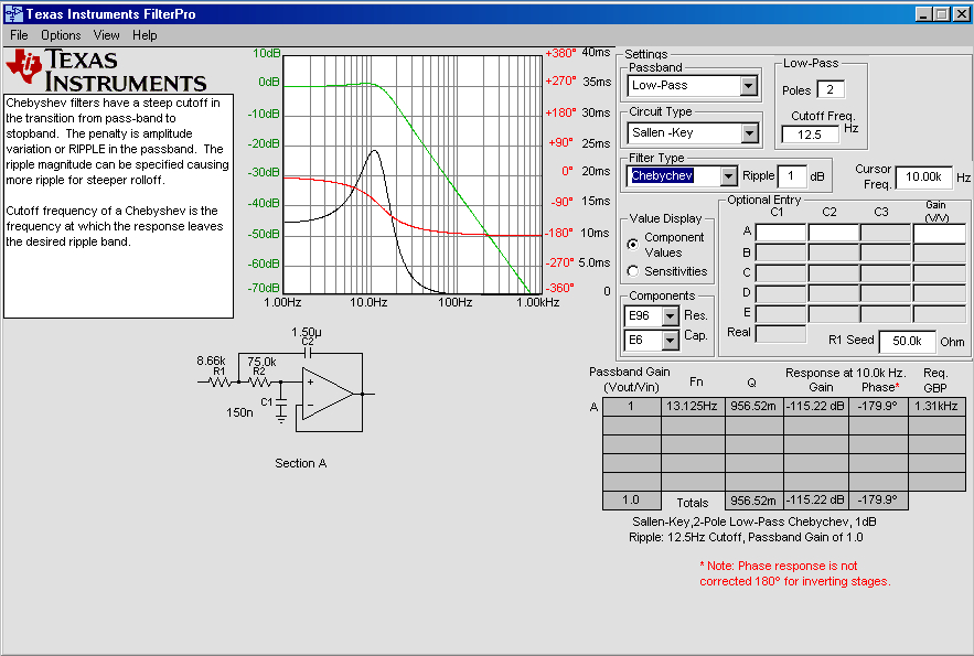

Could you provide the raw data as a .wav file?
I should have a low pass filter @ 12HZ cutoff? I was using 50HZ then 25HZ cutoffs, I really don't want to attach it to the a-arm since one wheel hits the pothole that maybe the accelerometer wont be on, and also I want this to be able to just attach someone inside the car.
@ Mike not sure how to convert it to a .wav?
If we could convert your .csv to .wav, I was going to pass your data thru a LTSpice simulated filter, like the one below. You will have to actually build one :(
I've been using SciDavis an open source Matlab type analysis tool, you can use FFT, and it has low pass, high pass, bandpass, bandstop filters you can apply to the signal. Is 12.5HZ a good cutoff to try like a 5th order butterworth?

We use a similar system at work for counting "bangs" and do this as RB mentions using a hardware filter (Sallen low pass) set for around 12.5 Hz I think. The design has been working over 25 years that I know of. We come off an Endevco accelerometer and use an instrumentation amplifier with low pass filtering. The bangs trigger a simple level detector comparator circuit and then a one shot (old 74123 one shot) just to get a nice clean pulse for counting. Everything is done in hardware as when this was designed was long, long ago. The low pass filtering is just to clean up the HF hash and noise we have no interest in, we only want the bang. That method has worked fine. The accelerometer has a 10-32 screw base and uses a magnetic base mount with a strong magnet. Been years since I have had anything to do with that system but as I recall, that is how we go about it.
Ron
Are all High pass filters Differentiating?
Yes. Put it another way, high-pass filters put out a voltage determined by the rate-of-change of the input.
Low-Pass filters put out a voltage determined by the integral of the input.
Ron
Wow that sounds awesome , is there an advantage of the sallenkey lpf compared to say a 4th order butterworth?
I found this, is the type of topology you uses
http://www.calculatoredge.com/electronics/sk low pass.htm
Tomorrow if time allows I'll try and dig out some of the old drawings. In a quick nutshell we use accelerometers in a few applications, mostly to detect a "bang" or "bump" that is in other noise. In one instance a very large AC motor (a very strange motor) drives a lead screw using a latching mechanism. When power is removed the latches open and the lead screw slams home. During the SCRAM process there is noise followed by a distinct bang. When power is removed we look at the current decay and start a timer actually two timers start at the same time. When the latches (arms) open there is a thud picked up by an accelerometer, that thud tells us the arms open time for the latches to release the lead screw. The screw under spring force of a very large spring that is compressed begins driving home, when it hits the rod bottom there is a bang picked up by another accelerometer, this stops the second timer. The problem is the noise and as the rod drives home a high level of noise. The entire process is also recorded using a paperless chart recorder scheme. To eliminate the higher frequency noise which we really don't care about we have been using a low pass sallen key butterworth filter scheme. This is nothing real fancy as we just want to drop the noise levels of what we have no real interest in.
While some of the circuits get pretty in depth some are real simple. I think in one application we just use a TL084 or two and a few comparators and a few flip flops. Most of this stuff goes back well over the 25 years I have been in the department. Before the paperless chart recording we were using the old Honeywell Visicorders.
