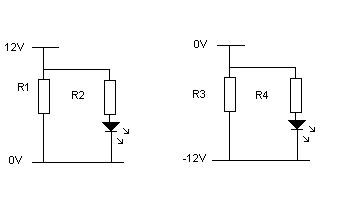

Hi all,
I been given the circuits attached in the image, R1 and R3 need to have a load of 5W, so using P=(V^2)/R I rearranged to get R and worked out R1 and R3 need to be 28.8Ω to get 5W load. However how do I choose the resistor values of R2 and R4.
cheers.

It depends on the voltage drop of the LED and the required forward current.
[latex]R = \frac{V-V_F}{I_F}[/latex]

You cannot solve the resistor value until you know the 'forward voltage drop' of the LED and it required operating current.
For a general solution: R1= [12V - V led]/ I led = R1 ohms

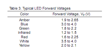

Standard LED's are rated around 10mA to 20mA, look at this chart for typical voltage drops.
So say you had a White LED with Vfwd of 3.2V to get a 20mA current thru the LED from 12V would be [12v-3.2v]/0.02 =440R
The wattage/heat in the resistor would only be 0.176W
So to get heating of 5Watts of a resistor would mean [using a White LED] would be [8.8V^2] /5 =15.48R

how would you then work out the value of R2 and R4? as you have 8.8v drop across R1 and 3.2 on the LED
cheers
cheers
I have already done that.?
ah my mistake sorry, so R1 = 15.48Ω and R2 = 440Ω?
Cheers
Thats it.:)
So the method is:
Subtract the LED forward voltage from the supply voltage, then divide the result by the required LED current,, the answer is in Ohms.
NOTE: the 15.48R at 0.55A is not a normal example.!!
For standard LED's both resistors would be 440R

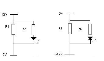

With this circuit the resistors are in parallel, is it possiblie to get 5W on R1 and R3 in this circuit?
cheers
heres the pic sorry.
You have already solved that problem.????
so are you saying your solution works or R1 should be 28.8Ω?
cheers
The fact that those resistors are directly across the 12V supply means that the resistors with leds have no influence on R1 and R3.
OK.?:)
Whay do you want to do this?
Sorry but it seems like a total waste of time.
