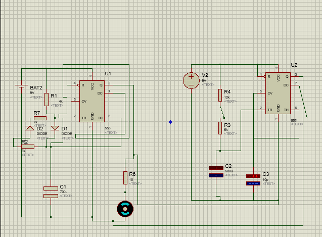

Help required building a circuit to turn a dc motor clock wise for 5 seconds remain off for 5 seconds anti clockwise for 5 seconds then remain off for 5 seconds and restart the cycle while being powered by 9v battery. Complete amateur .

Is this a homework assignment (sounds like one...)?
Anyway, the circuit, as you describe it, could be as simple as a 9VDC battery, a DPDT switch, a motor and a hand help timer.
Or it could be as complex as a 9VDC battery, a μcontroller, a motor driver circuit, a motor and the code needed for the μcontroller.
Any additional information you can provide? What have you googled thus far?
I Have Googled the 555 timer and was trying to use two with reverse polarities but the second timer cannot start in the off position so it resulted in a failure .. and no this is actually an invention i am working on ...also can you stick around please im from the caribbean and not much electronic experts here you guys are all i have .. maybe you can send a datasheet on what i should do pleasee .. i bought proteus so i can keep up with you . I may be completely wrong i have no idea what im doing please reccomend the best thing for me to do

Okay Guys ill buy that motor but can someone please send a schematic of how i should design the circuit to acheive the 5 second intervals please ... i have no idea what should i use the 555 , the H bridge ... capacitors resistors?

**broken link removed** (+ link-2-schm.**)
found by https://www.google.ee/search?client=opera&biw=1377&bih=1015&tbs=ic:gray&tbm=isch&sa=1&q=555+timer+dc+brushed+motor+bi-di+driver+controller+full-bridge+-patent&oq=555+timer+dc+brushed+motor+bi-di+driver+controller+full-bridge+-patent&gs_l=psy-ab.3...25534.25534.0.26318.1.1.0.0.0.0.69.69.1.1.0....0...1.1.64.psy-ab..0.0.0....0.IgozgEuI12E or alike search
what you need to add to the schm.** is +/- square wave half cycles of duration 10s each e.g. 20s(50mHz(milli-Hertz)Sq.Wv.) that triggers another 1-shot timer of 5-s at zero crossing of the 1-st one
or set up a binary control based on mod-2 2bit counter driven by 2.5s pulse train and encode your FW NOP BW NOP from 00 01 10 11 ...
or other ... (such. as discriminating sine or 3-wave to 3-level detector as -- when above 1/3-rd of +A =forward inside ±1/3A =rest below -1/3A =reverse) . . . e.c. . . .
All you need is a DPDT relay with a center position and a 3 position cam relay with a 5 second time. You can buy both relays from Allen Bradley.
