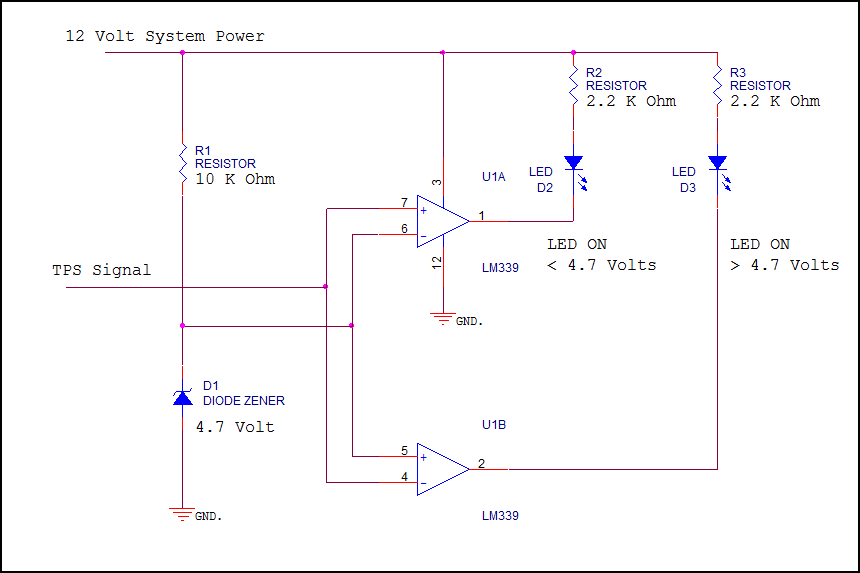

I have a sensor that throws out values 0-100 in .2V increments. (Throttle Position Sensor). When the TPS is at 100% the sensor will send out 5v. I need to turn on another system when the TPS is at 100% (5v), and only during this time +/- 5%.
What kind of switch,relay, module would be voltage operated? How can I build a system to monitor the voltage and when it reaches 5v, send a signal to a relay that will then turn on another operation?

Normally you'll find you have 3 terminals on your throttle position sensor. These are +5v, ground and output which varies between 0 and 5 volts depending on where the throttle actually is (unless its something silly like a PWM throttle sensor).
As above - you can use a simple comparator or a window comparator for this purpose (you can get loads of info from a quick Google of it).
The throttle position sensor in most cases (not all systems) is a potentiometer that outputs 0 to about 5 volts, however that can vary as can be seen here.
Idle can be between 0.6 and 0.9 volts while wide open throttle can be between 3.5 to 4.7 volts. The attached circuit is a hack job from another comparator circuit that I had. I made the zener diode 4.7 volts so the outputs will toggle at about 4.7 volts. You may even want a 4.5 volt zener in there. The output of U1A pin 1 could drive a small NPN transistor like a 2N3904 or 2N2222 which could drive a small relay. Use a transistor base resistor around 4.7 K Ohm. Anyway, something like this could work. This is just a basic hacked circuit attached suggesting the use of a comparator. If you want to go this route a circuit could be put together using a single comparator. The thing would be about the size of a book of matches give or take.

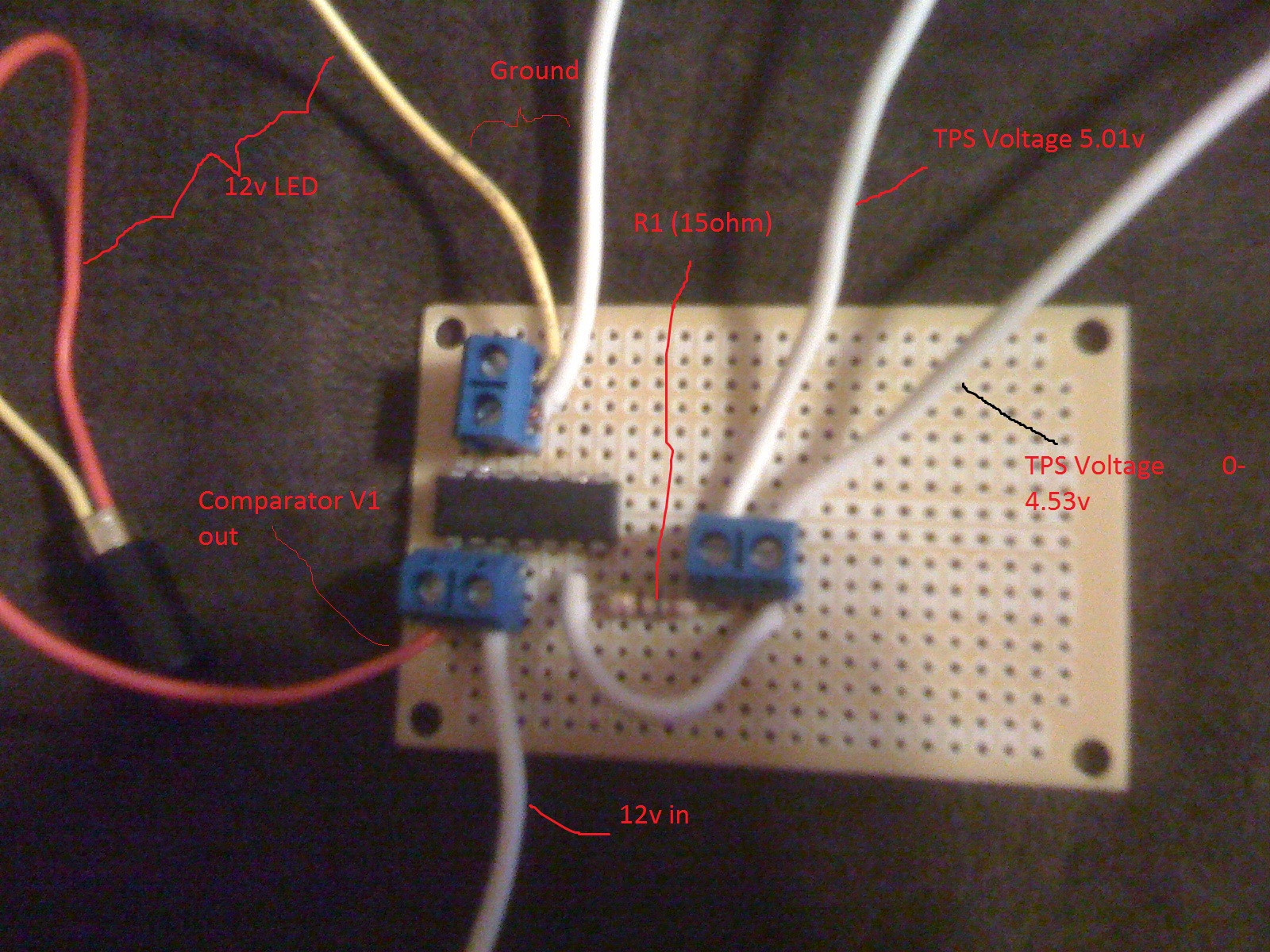

Ok, I worked on this subject for a few days. I understand how the comparator works now. I can get a 1v out when I put the Vcc at 12v with a ground and then v- at 12v and v+ at 5v..
The TPS output is at 4.53v at WOT with a 5.01V input.
The LM339N says it has 50ma draw
I connected a 15ohm resistor between the TPS input (5v) and the v+ and the voltage drop was neglible did I do something wrong? 15*.05 =.75v drop so i should be seeing ~4.26v shouldn't I? I notice the zener diode in the diagram, how is that made, how could I make one to be around the 4.2-4.35 range?
Also, is the 1v digital output from the LM339 stront enough to trigger a relay?
Did you wire it up as I showed in this schmatic? From the questions you are asking, I'm guessing you didn't.
If not, post how you wired it?

I have submitted a picture. I am new to this so I don't fully understand all of the schematic, and I didn't see this schematic earlier either. I saw another one with a 4.7 zener diode, I understood that schematic much easier, but I need around a 4.2 zener diode and I'm rough on understanding how they work. Look at what I did and see where you can offer advice.
Thanks much!

Your circuit is much too simplistic. The LM339 requires many external components to make it work for your intended purpose. The circuit I posted is about the minimum parts count that will pull-in a small relay when the TPS voltage is greater than what the pot is set to (the trip point is adjustable using the pot) I use an 8.2V Zener to create a reference voltage that doesn't vary with engine speed, also to protect the circuitry from transient voltage spikes that may exist in the car's electrical system.
