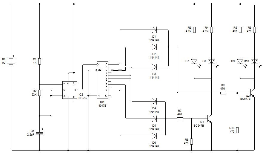

-Yes, the goal is an alternating flasher, that would flash two times or three times per bank and then alternate. Ideally, the speed would be variable/adjustable.
So a suitable flashing pattern (L bank vs R Bank) would be: LLL RRR LLL RRR etc (or LL RR LL RR LL). I like the effect of three flashes better than two, but as you said I'd like to keep it stupid simple. I do not want just a single flash that then alternate.
-As for the circuit from post #24, that was something I found and just recreated for better resolution. Unfortunately, it flashes LLL RR LLL RR. I still havn't figured out what was wrong with it, but again its not my circuit like I earlier said, just something I found and wanted to add to the thread as information :D !
Yes, it looks as if it should work correctly (although there's at least one error on the schematic: there's no "10" pin on that chip). In fact, my money'd be on that circuit at this point, with the addition of MOSFET switches for the LEDs. Nice low parts count.
okay^ maybe my simulation is incorrect.
Your simulation is likely correct. Try changing the counter outputs to reflect the attached image.

Hmm, it looks as if all that's going to do is to even out the first 3 pulses. How would that fix only 2 pulses on the other side (outputs 5, 7, & 9)?
I think the simulation was wrong.
Yes you are correct. I made a mistake in re-doing the circuit. Changing that wire as you indicated results in the three flashes! LLL RRR LLL . Thank you for finding that mistake. It simulates correctly now.
So add a couple MOSFETs and you're done.
Here is the fixed schematic: wire fixed, and i changed one resistor to a a variable resistor that changes the speed if flashes:

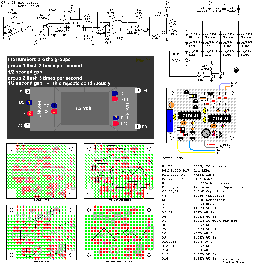

Here is a schematic I built for an RC car, it is useless for this application however. The flash pattern matches what you are after is the only reason I mention it.
temp2-gif.57405
I did a YouTube shot of it working...
https://www.youtube.com/watch?v=PcpLg9CCv3w
I'll make a similar drawing for something I would use. BTW, note the layout of lights on the car. It may be something you want to emulate.

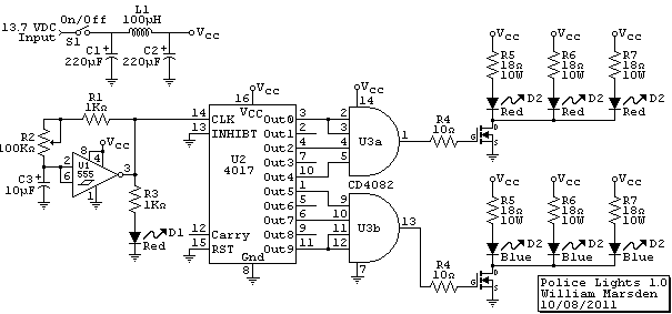

First draft...
police-lights-5-gif.57403
The resistors R5-7 and R9-11 will have to be recalculated depending on the exact LEDs you buy. I just noticed I messed up a little, but since this is the first draft I'll let it stand.

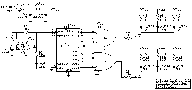

Part of the reasons for the changes is I wanted a cleaner switching signal for the MOSFETs. That and it is simpler IMO.
The resistors will get warm, however they are only on 1 out of 10 cycles, so they aren't going to get that hot. I decided in terms of redundancy for the design. It would get less warm if two of the LEDs were in series, but if a LED fails with my way the other two will keep on working.

but..but... that's [almost] the same thing... just the diode ORs have been replaced with CMOS AND gates (making it completely non-functional, oops)
Non-Functional? Yeah, your right, it need OR gate. BRB, drawing. It does provide cleaner drive for the MOSFETs, which I mentioned, as well as reducing parts count. Yes, it is close to the original design, I not too proud to use other peoples ideas, especially when it is what the OP wants.
OK, Version 1.1
police-lights-5-gif.57406
Good catch, thanks.
