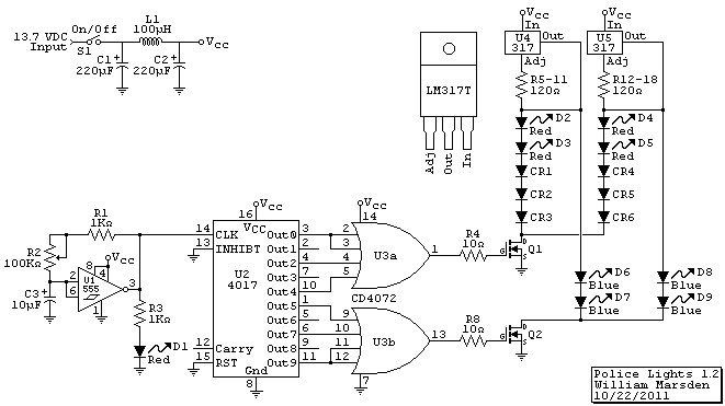

OK, my latest revision. I'm going to start translating this to a PCB.
police-lights-12-gif.57739
If you have any questions feel free to ask. Basically I'm working on reducing the amount of heat in the box. R5 - 11 and R12 - 18 are 7 resistors in parallel, 120Ω ¼W.
There's only 1.25 volts across that resistor, so @ 72mA, that's 0.091W - you could just use a single 18 ohm 1/4W or 1/8W if you wanted. The heat will mainly be dissipated by the LM317.
