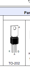

Assuming that you have built the circuit as shown in the diagram, I would check the connections to the SCR's GATE pins, ensure that you have wired the SCR correctly.
Which SCR type are you using.???

corrected SCR
T106D image

R7 will burn when the full wave bridge rectifier or the SCR have the pins connected backwards.
Its C106d.
Assuming that the pins of the SCR were wrongly connected, i think the first one that will burn is the SCR...?
