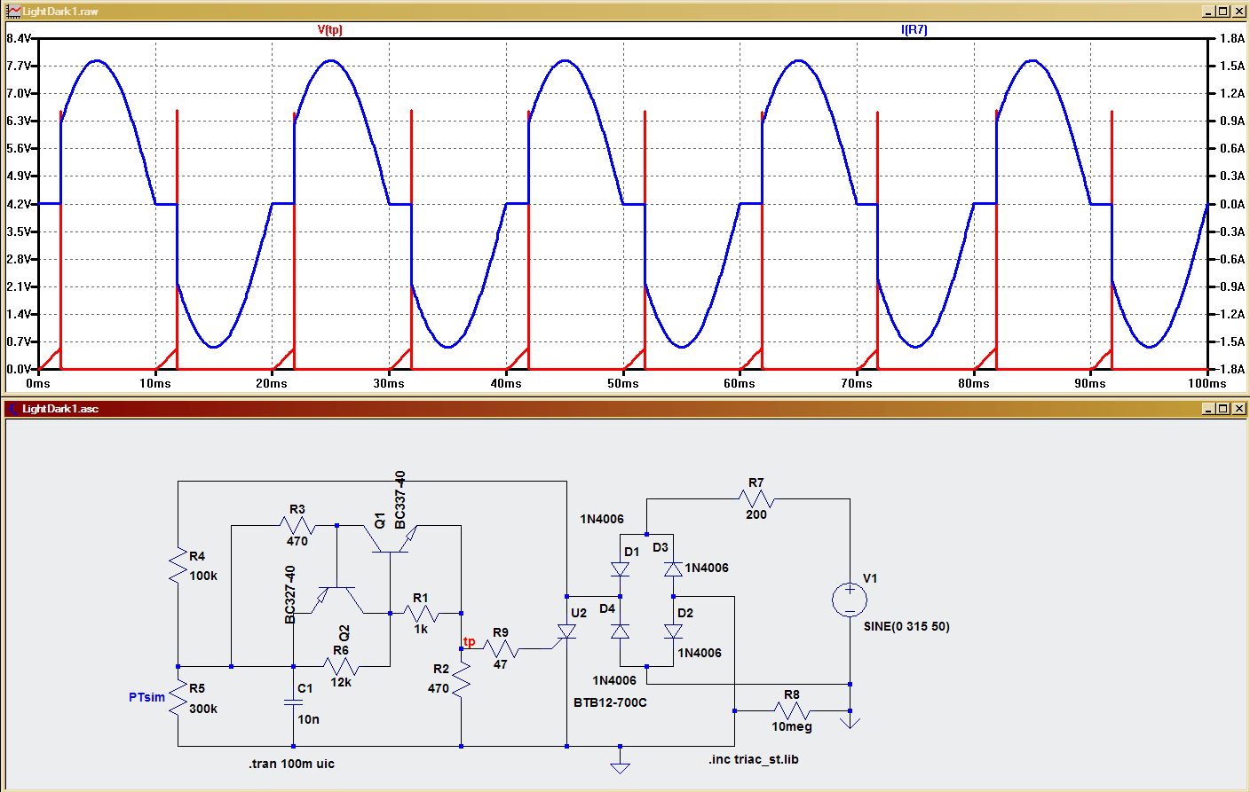

This is the circuit running in LTspice simulation.

Hey... Share your link for your LTspice simulation download pls. What i used is Multism, it doesn't work well.
hi...
In your circuit, you add 47ohms (R9) and 10megohms (R8) and 200(R7)?? I tried my previous circuit in multism simulation and it doens't still off.

I did suggest a 47R in the Gate in an earlier post.
The 10meg is only for the LTspice sim.
I have attached the LTS.asc file you asked for.
  • LightDark1.asc

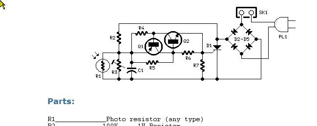

This one is the LDR **broken link removed**

If you remove the LDR the light will go ON.
If you short out the LDR, the light should go OFF.
Normally a LDR resistance falls when lit, as it does so the light will go OFF.
The original circuit diagram shows that the light sensor is a photo resistor, any type.
Tell me what resistance the LDR measures when LIT and when its DARK, measure it when disconnected from the circuit
CAUTION: The circuit is NOT mains isolated.!

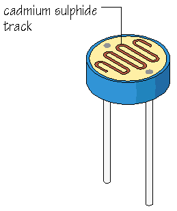

102.34k-300k ohms small light. with no light it has 10k ohms.
If Bright lights is present it has 500k ohms to 1G ohms.
If it is a Cadmium Sulphide light dependent resistor then it operates backwards.
It is supposed to be a fairly low resistance with light and be a very high resistance in the dark.
It looks like this:
Yeah.. Sorry i was wrong. 102.34k-300k ohms small light. with bright lights it has 10k ohms.
with no lights it has 500k ohms to 1G ohms.
