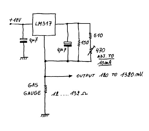

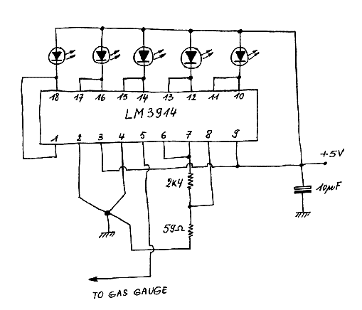

Hi Browningbuck,
Maybe you need a different approach, I think the circuit is too
complicated. If you send a constant current through the gas
gauge the voltage across it's terminals will be proportional to
it's resistance. Then you can measure this voltage with the
LM3914, nothing to it but, there always is a but . . .
The LM3914 should drive five leds, the minimum level should
correspond to 12 :eek:hm: , the maximum level to 132 :eek:hm: .
No problem (?) if you could build your own LM3914 to meet
your specifications, in practice there is a minimum level and
the maximum level is ten times the minimum level.
So I decided to apply a constant current of 10 mA to the gas
gauge, set the lowest indicator level for the LM3914 to 128 mV
and the highest indicator level to 1280 mV.
Which also means that there are ten indicator levels on five leds.
Off, half brightness, full brightness.
I also decreased the led drive current of the LM3914 to approx.
5 mA per output. There is only one difficulty left and that's the
construction, everything that is connected to ground should be
connected directly to one single point.
on1aag.
