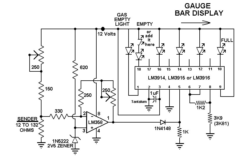

Jut to Update Everyone, "browningbuck" advised me in an email he would now like 6 LED's.
One of these to go elsewhere on the display.
Here is the schematic that I sent him. Its Tested and works in bar mode or dot mode.
He can either use an LED on Pin 1 or put 2 Leds on Pin 18, for what he was asking to do.
But now it seems has isn't familiar with a Potentometer symbol. I just emailed him a reply on this.
Hope this all helps him.
Merry Christmas to all......Gary.

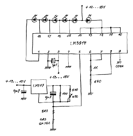

Hi Browningbuck,
I made a slight error in my previous design, I thought that the
resistance of the gas gauge increased with the level of fuel in
the tank but unfortunately it was the other way about.
So I built a new one and added the sixt led.
No regulated power supply needed, fewer parts, simpler, cheaper.
on1aag.

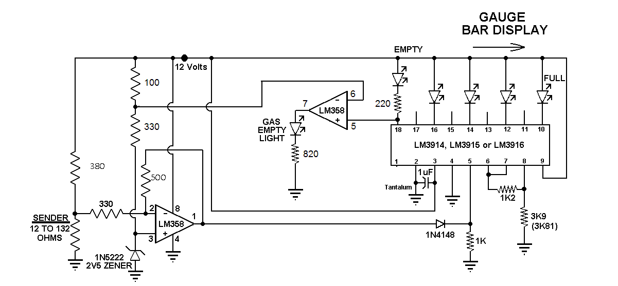

HELLLLLLOOOOOO AGAIN
well this thing works....but i need a little help...
so here is how its wired up now
i need to know if there is a way to have pin 1 of the LM3914 only light the led up once that pin 18 no longer has power.....
so the idea is once the pin 18 led dies out the pin 1 will kick on...not stay on at ALL times.
any help???? thanks in advance guys you have really helped me out on this project(the easiest fix is the most preffered :) )

Why do you want to do that?
You could just connect an inverter to the pin 18.
the reason i want this is so that when you are riding 5 leds that re in bar mode (18 17 16 15 14 ) show full to empty....but once empty light goes out pin 1 lights up under a gas symbol giving you the signal you are on reserve...how does the inverter work???
The LED comes one when pin 18 goes high and turns off when it goes low.
All you need to do is connect a logic inverter (not gate) to invert the signal.
You could use the other half of the op-amp with a couple of resistors to shift the voltages as an inverter.

well its a good thing i have another opamp avilable...it sucks i cant use the onle thats already on there
HERO you are my hero...ahahha thanks i will wire it up tomorrow and post it up.
The LM358 is a DUAL opamp. Hero999 has shown you how to use the other one in the chip.
ahhhhhhh i get it now i didnt notice the pin #s SWEETTTT... i get pics up tonight
thanks for the clairification that i over looked....
i did have anothe question though waht is with the 220 resistor coming off pin 18? is there more voltage going out of the opamp that would cause the led to be brighter than the others if it wasnt there...and if that is not the case will the led be dimmer than the others...if this doesnt get answered by tonight i gues i will know from looking at it lit up.
once again guys thanks this thing has just bl;own up in complexity compared to my original idea
Brian
The LED connected to pin18 will be just as bright as before. The 220:eek:hm: resistor is there to give an extra voltage swing for the opamp so it can detect the "empty state" better. The brightness of the "Gas Empty Light" is set by the 820:eek:hm: resistor.
That's right, in order for the op-amp to be able to see the voltage difference between the inverting and non-inverting input, the voltage on both pins needs to be <Vcc-2 and this is what the additional resistors do.
well it worked.... needed some resistance tweaking here and there but the pots helped me figure out exactly what i needed.... HERO thanks again for the quick response to a easy yet very efective fix using compnents on the board... i will get the vid up tonight...and pics of the final work fully installed this weekend

i've just found this thread by searching for the same thing browningbuck was, and the schematic looks great, i've located a local parts store and got both LM358
and
LM3914
the gentleman helping me there thought to help me pick out the correct resistors, when i realized.. i don't know what wattage these resistors are supposed to be? i'm really new to all of this, so i may just be missing something that is obviously right infront of my face. I appoligize if that is so.
With the exception of the 380:eek:hm: resistor (connected to sender) and the 330:eek:hm: (connected to the 2.5V zener), both of which should be 1/2watt or better, the rest can be 1/4watt resistors.
