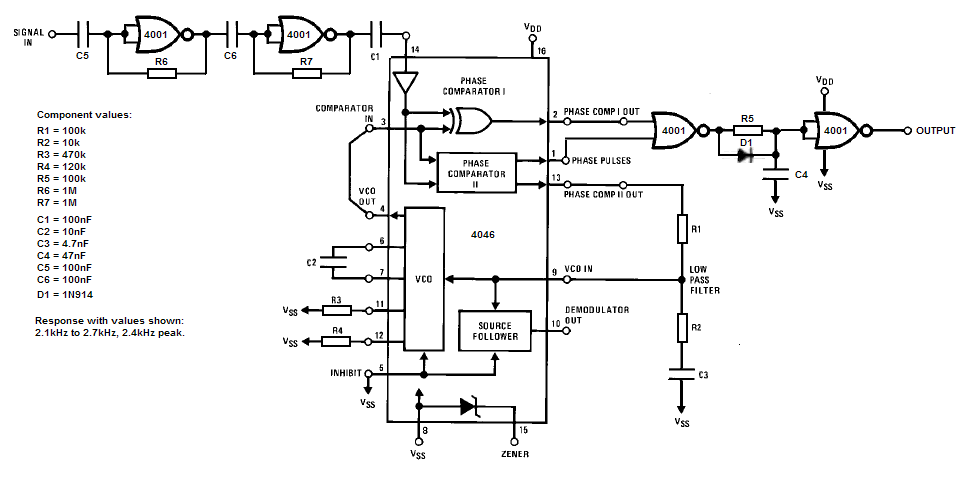

74HC4046 can be used as a tone decoder.
You can use a spare NOR gate or two as an amplifier for the IR detector.
I've drawn the circuit, just in case the book is removed from Google. I thought about copying it but the moderator would probably have removed it for copyright reasons.:D
You'll need to change the values for 38KHz, see the datasheet.
The Forrest Mims circuit scrapbook - Google Books
You won't get a much better circuit than Hero999 had posted. Easier to test too.
R3 and R4 set the minimum and maximum frequency limit extents of the PLL oscillator (2.1 kHz, 2.7 kHz).
The 'PLL lo-pass filter' (R1 & R2) also affects detection bandwidth a lot. You'd narrow the PLL bandwidth, if the PLL was nuisance locking onto any stray signals that the reciever was picking up. That could happen if you were increasing the detection sensitivity by preceding the PLL with a lot of amplification. Making them variable resistors if need be you can tune by ear, instead of calculating new values.
Remember, if you are using the same power supply for the transmitter, to ensure that the supply rail between the LED driver and photodiode receiver are sufficiently decoupled. If not, your 'beam signal' (that you want to break) will just bypass the IR link and travel through the power rails!
It's probably easier to tune the transmitter than the receiver.
Yes, supply decoupling is essential: a 100nF capacitor must be connected across each IC.
Yes, the centre frequency is easiest to choose in the TX. Especially also if an LC circuit is used in an amplifier.

:) I wasn't talking about '[IC] supply decoupling', I was talking about "supply decoupling"....
If the (audio!) signal is finding it's way through the supply rails and then through an IC's (imperfect) supply rail rejection, sensitive amplifiers can amplify it as though it is a recieved signal. Adding 0.1's across IC pins doesn't do much, apart from lull you into a false 'sense of security' before you design a PCB without breadboarding it first.
