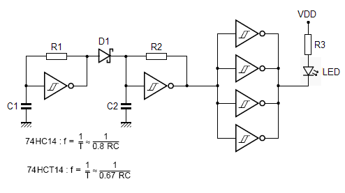

i went to buy 74HC04 but they were out of stock.so i bought 74HC14 and assembled following circuit.it seems working.but power is too low.i guess i have to do that parallel remaining gate thing here too.anyway can someone tell me how this parallel gate thing works?
Simple, connect all the inputs and outputs of the remaining five gates together and connect the inputs to the output of your oscillator.

no no i like to know the theory of making them parallel.(why do we need to parallel them)

and IR receiver module I use(HRM3800/TSOP1738) does not require pulses 38khz.it supports continues signals.
We've already been through this - according to the datasheet it doesn't support continuous signals, it will drastically reduce it's range in their presence as with other TSOP's.
I have an idea which will produce pulses of 38kHz.
R1 and C1 controls the repetition rate and R2 and C2 controls the IR modulation frequency.
D1 must be a small signal Schottky or germanium diode, silicon has too higher voltage drop, try BAT85.

My suggestion, if can't get the diode, do without it. Connect lower end of C2 instead to the output of the first IC. It's a bodge, I know, but it'd work enough to periodically interrupt the 2nd oscillator.
Whether the interruption will be long enough for the TSOP is another matter.
