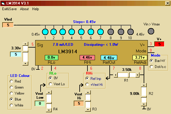

MSVBVM50.dll is the runtime library for visual Basic 5.0, and can be downloaded from Microsoft.
ak
