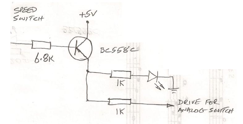

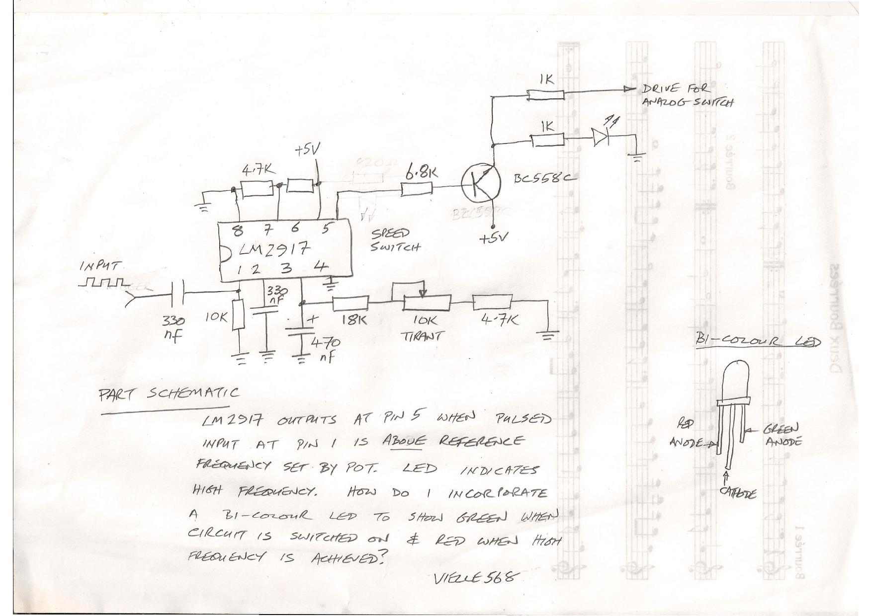

The bi-colour LED I am planning to use has three legs; the central one is the common cathode and the outer legs are the red and green anodes.
I've attached part of my schematic so you can see what I'm trying to do. There's already one LED in the circuit; I'd prefer to make it a bi-colour LED so I can use it to show when the power's on as well as warning signal.
Again, any help greatly appreciated.

It's just tow LEDs in the package.
Simply connect a logic inverter with the output going to the green LED and its input to the red LED. When the power is on the green LED is illuminated, if a signal turns on the red LED the green LED goes out leaving the red LED lighted.
Your schematic angles at 90° was difficult to read so I rotated it and converted it to a .jpg.
The transistor should also be NPN, not PNP, I've corrected it for you.

Bi-colour LED
The transistor was a PNP because the IC output (pin 5) dropped to ground when the input frequency went above the reference. This arrangement worked OK to light the LED when the frequency was high. I think it'll be the inverse if I change to a NPN transistor.

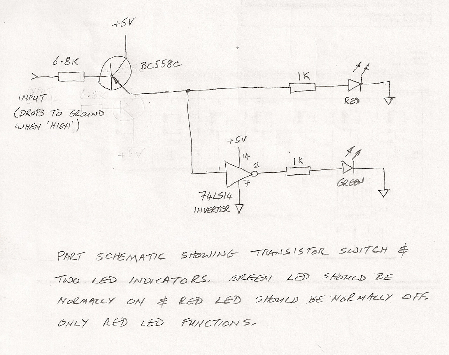

Still having problems getting my bi-colour LED driver circuit to work. One half of the double LED works OK and I followed Hero999's advice and used an inverter to obtain an opposite signal for the other part of the LED. However there was still no output from the second LED. I don't know if the IC (74LS14) is capable of driving a LED or if I should use the signal to trigger a transistor switch for the LED? Perhaps there's another IC that would be better for the job?
I'm sure the answer is simple enough but I keep on running into dead ends. Schematic attached. Any helpful suggestions most welcome. Thank you.

The 74LS14 is very poor at sourcing current. That means when the output is high, you can't drive an LED very well.
It is normal to drive an LED from 74LS series by getting them to sink current, but that won't help you as the LED you are using needs to have the common connected to the negative.
I suggest that you duplicate the 6k8, BC558 and 1k resistor for the green LED. Then connect the input (before the 6k8) to the input of the 74LS14 inverter. The output of the inverter drives the 6k8 resistor for the green LED.
(You drawing shows the emitter and collector of the BC558 the wrong way round)
vielle568,
You're not listening, the PNP transistor is reverse biased so of course it won't work. Reverse the collector and emitter connections.

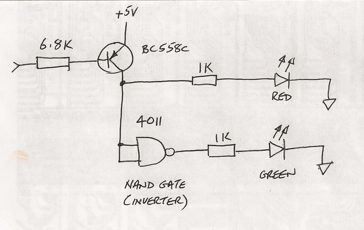

OK, I've got it working. I changed the IC from a 74LS14 to a 4011 and wired the nand gate as an inverter; it has enough power to drive the LED and the circuit works as required. Schematic attached (hopefully the transistor drawn in correct format this time).
Thank you again for all the suggestions and for your aid.
