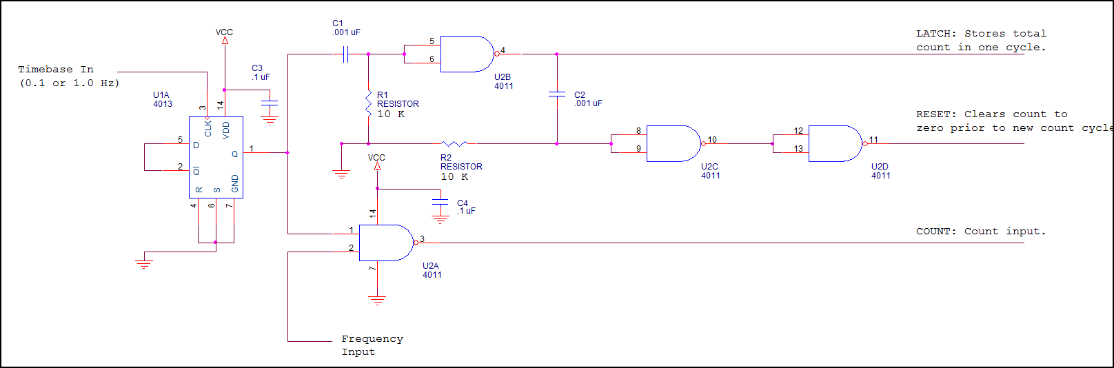

You need a circuit on your counter front end similar to the attached. You need a gate to open the door and allow in the signal to be counted for a specific time interval (1 sec or .1 sec in the example). You need to latch the count so the counter will hold and display it, and finally you need to reset the count to all zeros prior to the next count.
The attached circuit is part of a counter circuit designed by Forrest M. Mims III featured in his Engineers Notebook II circa 1982. Feel free to use newer chips. :)

10q very much :) i will look closer into this design. But doesn't U2C and U2D cancel out each other (because it is like have 2 not gates together)?

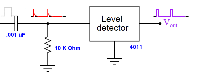

U2C configured as it is forms an Inverter and U2 C&D together form an AND gate. The 10 K resistors and .001 uF caps form a passive differentiator circuit. That shortens the pulse for the latch and reset functions. See the attached. So the input to U2C is not a nice pulse but looks like the attached. Then we invert the pulse out of U2C using U2D.

Actually to add to the post of JimB the 555 scheme needs to go. Your gate time can't be a function of the frequency to be counted. The gate time must be a function of an independent (and very accurate oscillator as Jim points out). This is where the circuit I posted comes into play. Also using the 74194 there is no need to tie D0, D1, D2 and D3 (pins 15, 1 10 and 9 respectively) to ground.
If you want any accuracy in the least I suggest a version of crystal oscillator as the time base.
Ron

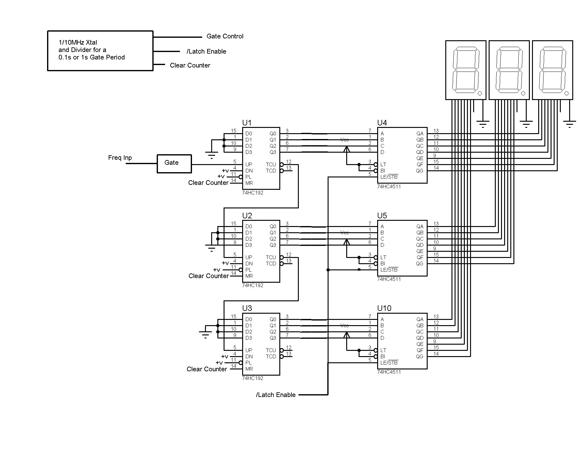

A problem with the circuit originally posted is that while the frequency is being counted the display is showing an increasing count value, when the 1sec gate period ends, the very next pulse of the input frequency being measured resets the display to 000.
You will only see the last count for about 20mSec, the higher the frequency you are measuring the worse the problem becomes.
The display will be changing so fast you wont be able to read it, and when it reaches it max count it will go back to 000 and restart.!
Ideally you need intermediate latches between the counter IC's and the LED drivers and as Ron and Jim have explained a crystal gate with latch enable at the end of the sample period. OK.?

This is a block diagram for a minimal frequency counter,
Included in the crystal block are the components that Ron has shown.
EDIT: drawing corrected
