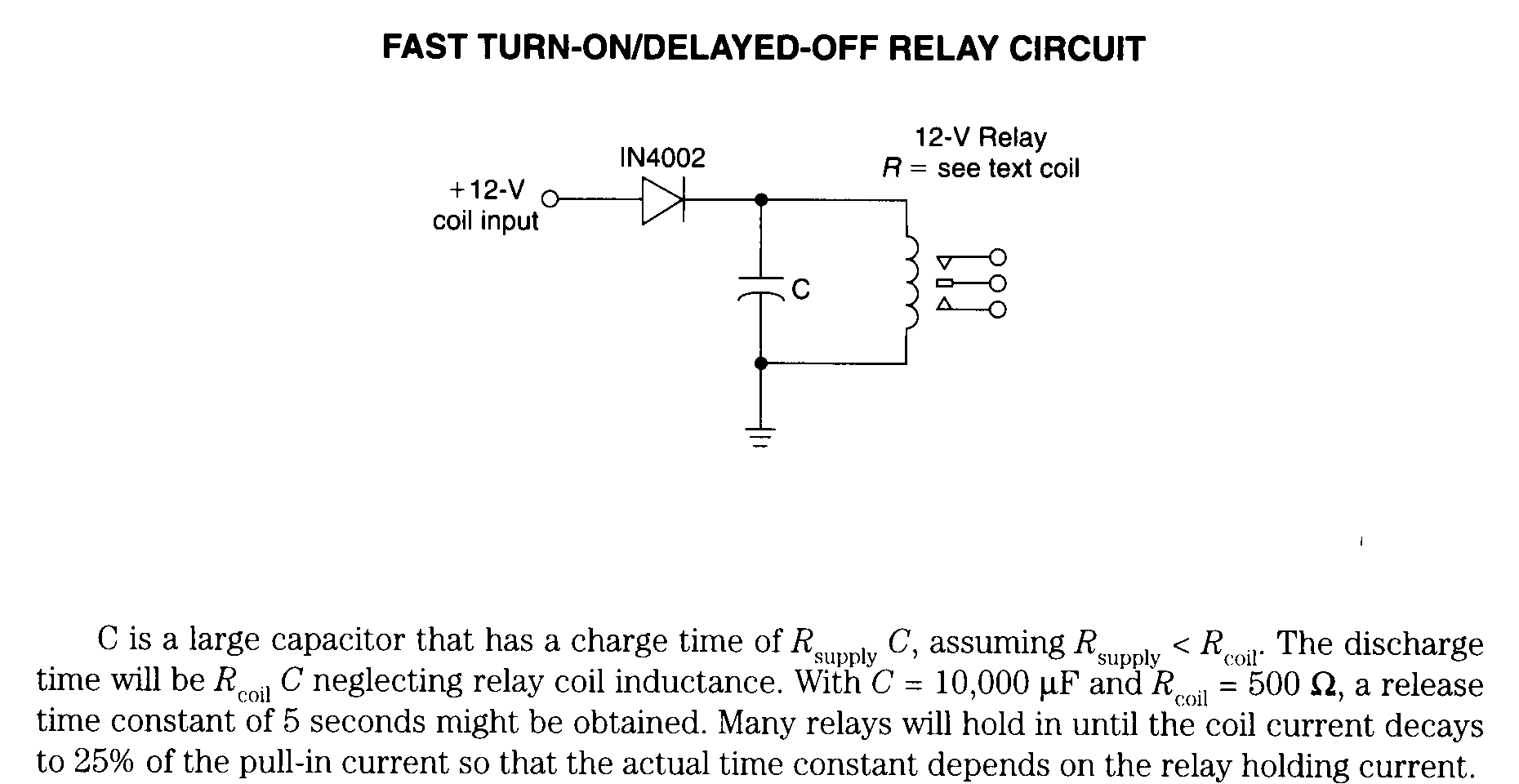

Would somebody help me??
I need a simple circuit :
when power off, I want to give a "low" logic to a shutdown pin (low active), then 100-200ms later, turn off that IC.
Thank you very much for your help!
How about this?
hotwaterwizard said:
How about this?

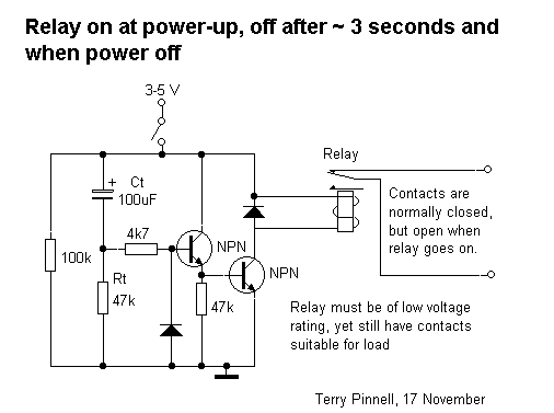

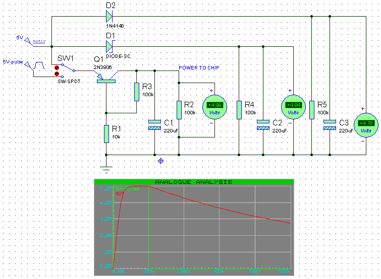

What about if only resistors and capacitors can be used for this purpose?
let me give more detail :
Input : 5V
in target IC: /shutdown pin, Vdd
the case is : if power disconnected accidentally, or manually power off, the sequence is : /shutdown pin will turn to LOW first, then Vdd of IC off.
Thank you.
You can do it with a diode and a capacitor, but then you will loose voltage over the diode. Using a schottky diode will reduce this drop to about 1/2 of a normal diode. If your application is sensitive to this drop, you can use a small transistor to do the switching. This will have an even lower drop.

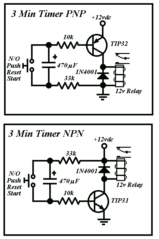

Try this circuit with a much smaller capacitor.
It works from about 6v to 14v and may even work on 5vdc
Ommit the Relay and Protection Diode.
