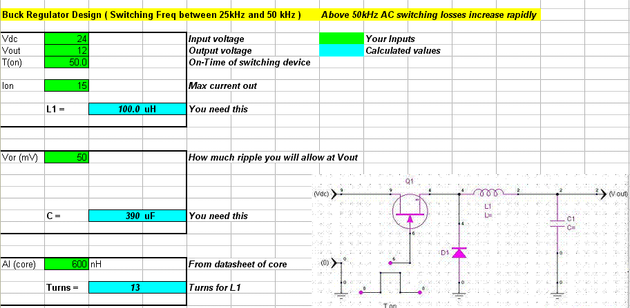

I see what you want is really a choke for a buck converter, so here you need tha Al value of the core to make a calculation on the windings as shown in the picture
The on-time is in uS
If it is a laminated core (most probaly made from silicon-steel), I doubt if it will be usable over a few hundred Hz as the losses will increase rapidly with frequency. You need a ferrite or powder-iron type of core for the choke if you ever hope to switch at 20kHz!
