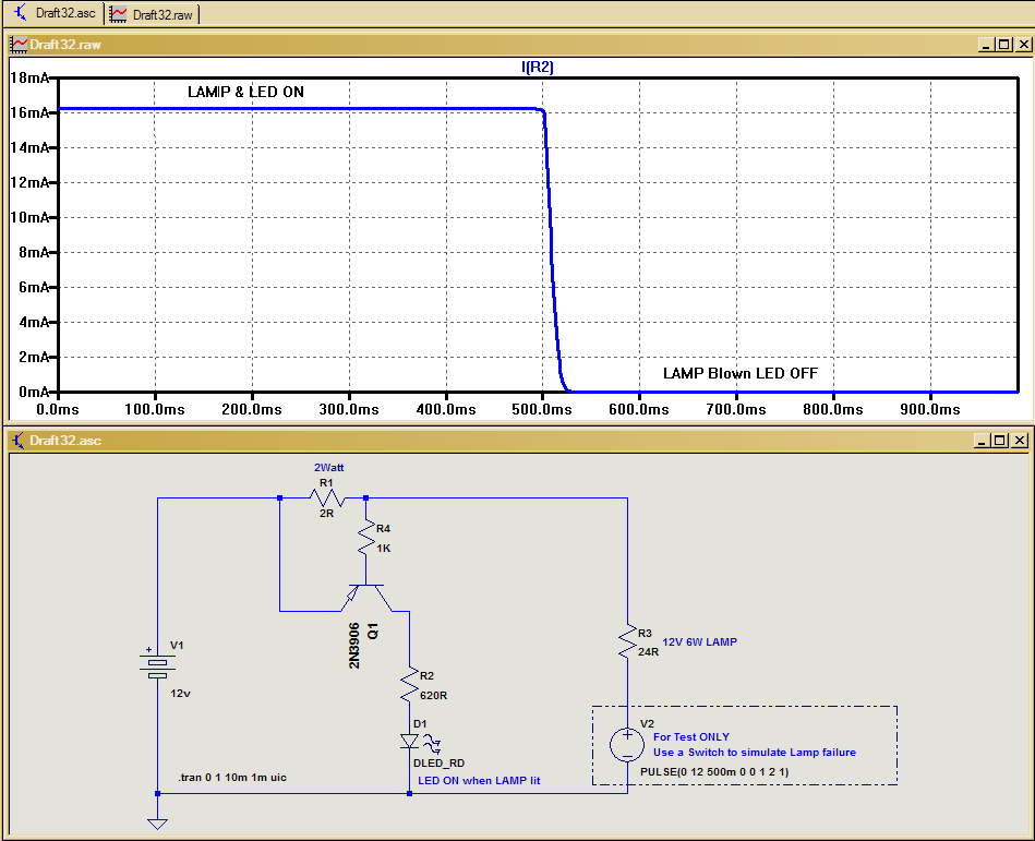

hi, my teacher has set me this project which seems really simple but I'm not sure there isnt a trap.
He wants me to makea circuit which lights a diode when its working. so for example when you turn your car headlights on, this diode should come on,but if the bulb is blown, then the diode doesnt come on.
i had thought of putting the diode and bulb in series but there's not enough current and now i'm thinking of using a relay to light the led circuit but im worried that current going through the control circuit will be too much.
Does anyone have a simple solution to this

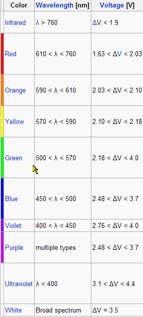

If this for a school demonstration and not a 'real' car headlight you could use a small lamp.
eg: say you have a 9V battery , a RED led [which has a voltage drop of about 2V], use a 6V cycle lamp bulb that requires less than 25mA current.
Connect the LED and lamp in series.
Do you follow.?:)
Look at this chart to select the best LED colour

hi Dad.:)
If its a real car lamp, say a sidelight 12V at about 6Watts, [thats about 0.5Amp] you
could use a series power resistor, transistor, resistor and LED for a demo.
I guess you need a circuit diagram.?
EDIT:
Look at this option, suitable for a demo.
NOTE:
If you plan to use a different wattage lamp the 2R resistor needs to be changed, let me know.
