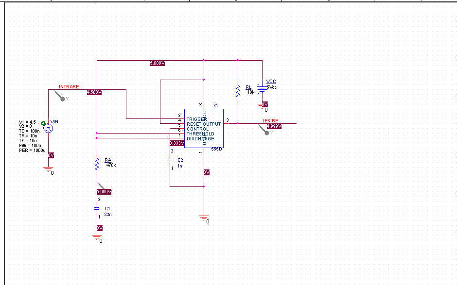

Hello !
So i have this circuit (schema.png)
I have to change values from VIN(VPULSE) to get this result in simulator (zzz.png)
I really appreciate if you can help me with some values to get the right results , i'm trying from 1 hour and i can't. (I'm newbie so be gentle )

Eric has done some really good 555 calculators in the tools section... For a start RA isn't in the right place as your threshold is fixed to Vcc... it needs to be between Vcc ad threshold...
This setup will only get you 50% duty.... Take a look at the two astable 555 calculators in the tools section

Hy Bogdan,
The 555 schematic is incorrect. My advice would be to learn how a 555 timer works and not rely on simulators.

Thanks for replys .
About schematic , i am a student and this is the circuit , i can't change it . My professor give me that .

Hy Bogdan208,
It does not matter who gave you that circuit- it is wrong. Threshold and Discharge inputs to the 555 should be connected to the junction of RA/C1, not Vcc.

I think you have copied it wrong.... Put Threshold and Discharge on top of C1 and you have a "One shot" the pulse length is then the RC combination of RA/C1... Then you can lengthen the pulse to just short of 100nS

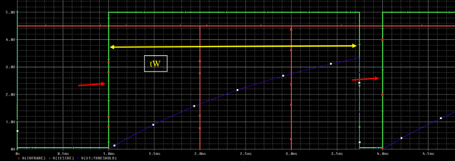

Tell us what each trace on your "results" is which signal?

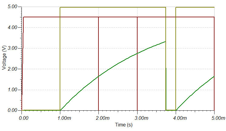

This replicates your zzz image and was the simulated output of the corrected circuit.
Your homework was to make changes to get this output.
