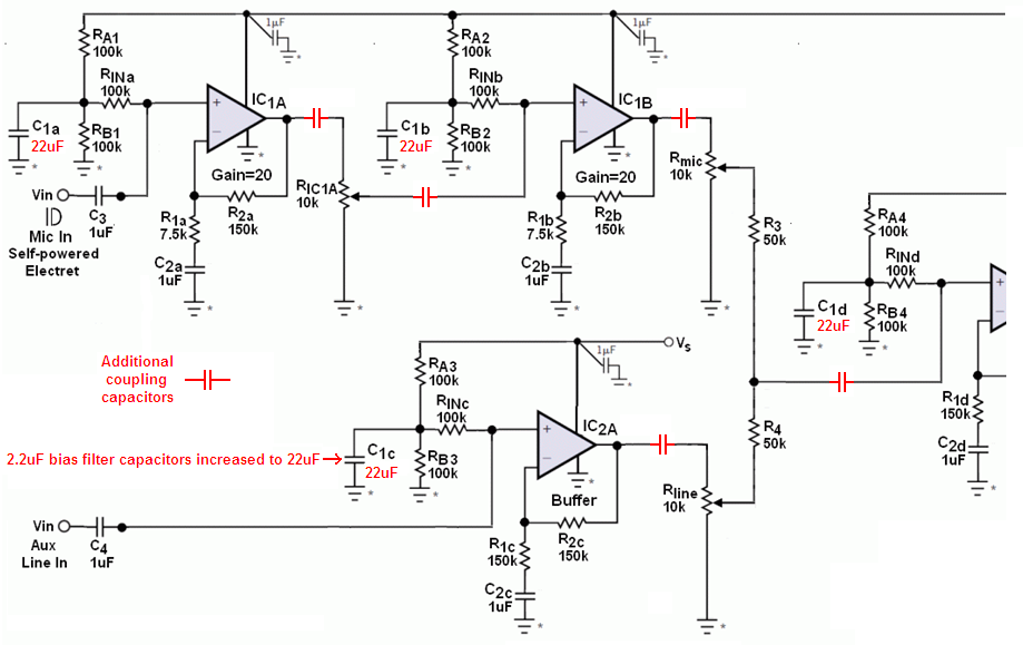

<< Your new schematic does not have a gain control for the mic preamp...My preamp circuit in the Sticky has the 470k pot as its gain control. It adjusts the gain from 1 to 214...Maybe the 150k negative feedback resistor for your 1st opamp should be a pot. >>
That was the plan from day 1. The counters show that some 12,000 people have viewed your Sticky circuit. Certainly tens or them if not hundreds (thousands?) have built it, and been happy, and bragged to their girlfriends, and received their reward, so I figured what can be wrong?
But that was before I ran afoul of Charles Kitchin, waving his degrees and published papers (many). Mr. Kitchin warns in grim detail of the dangers of bias errors, but then offers a solution. And we who keep our pencils in carefully straight lines are influenced by such things.
I would suggest strongly that you ignore the basically rubbish information in that article (as far as audio is concerned), and use the gain pot as used by AG in the sticky. Adding an attenuator after the first stage prevents the second stage overloading, but does nothing to stop the first stage overloading.
As it's an AC circuit you gain nothing by been DC coupled, and it can cause potential problems - which AC coupling would cure.
Long before I ever heard of AG (back in the mid 70's) I built a multi-channel mixer for the PA of a band I was sound engineer for - I too used a similar gain pot, allowing variation from mike levels to line levels on a single input (high impedance, using 50Kohm mikes back then).
The capacitors in the signal path each has a cutoff frequency. But their attenuation of low frequencies adds up.
The cutoff frequency of an RC pair reduces the level at that frequency -3dB which is an amplitude of 0.707 times. Lower frequencies are reduced by 6dB/octave. A 6db reduction is 0.5 times.
If C3, C2c, and C2d each has a cutoff frequency of 23Hz and C2a and C2b have a cutoff frequency of 21.3hz and C5 has a cutoff frequency of 16Hz then the total cutoff frequency is 126.7hz and lower frequencies are reduced a lot.
Speaking of capacitors, volume controls R1C1A, Rmic and Rline should be fed from coupling capacitors to keep DC out of them. DC in a pot causes it to make loud scratchy sounds when it is turned.
If the capacitors are 1uF then the total cutoff frequency is 175Hz.
But if all the coupling capacitors have their value increased to 10uF then the total cutoff frequency will be about 18Hz. Voices don't go down to 18Hz, use a total cutoff frequency of about 59Hz with 3.3uF coupling capacitors and increase the 47nF capacitors to 150nF if you can find them or 220nF.

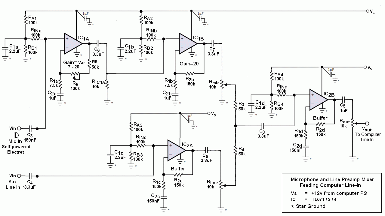

Thanks for taking the time and trouble to set me straight, Uncle $crooge.
Unfortunately, I don't think I was able to follow your instructions very well. The attached schematic is what I came up with, but things seem funny.
The input capacitors are now different values. C3 (Mic In) is 150nF, and C4 (Aux Line In) is 3.3uF. This doesn't seem right (for all I know).
The "2" capacitors are now different values. C2a and C2b are 1uF, while C2c and C2d are 150nF. This, too, doesn't seem right (for all I know).
All of this after studying along as best I could, referring back to your mic Sticky, and fooling around with some online RC network calculators. But I lack the underlying knowledge to understand the application of principle, so I just blindly followed instructions...maybe. Or maybe not.
At any rate, I did make IC1a variable gain. There's no such thing as a 150k pot apparently, so I used a 100k pot and a 50k resistor. I kept the 150k total resistance to avoid making unauthorized (by you) circuit changes.
Well, here the thing is. I'll much appreciate your correcting my corrections.

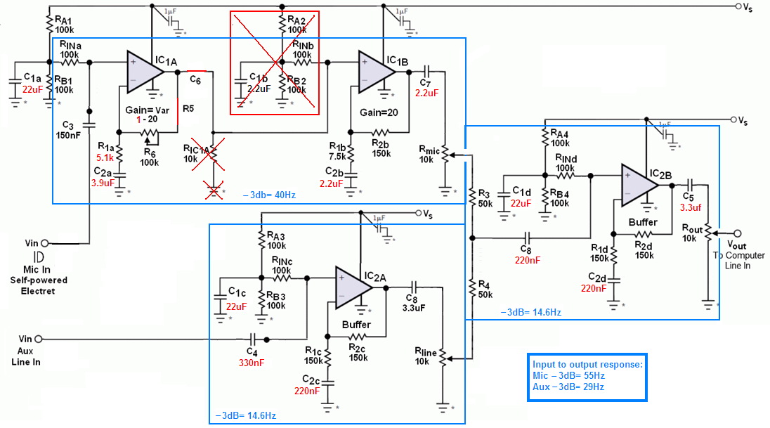

The calculation of the cutoff frequency of a RC network is 1 divided by pi x R x C. 1/pi is simply 0.16.
I didn't finish the circuit before. I did now.
Which quad opamp will you use?

Gasp! Thanks Uncle $crooge! It's like a cloud has lifted.
