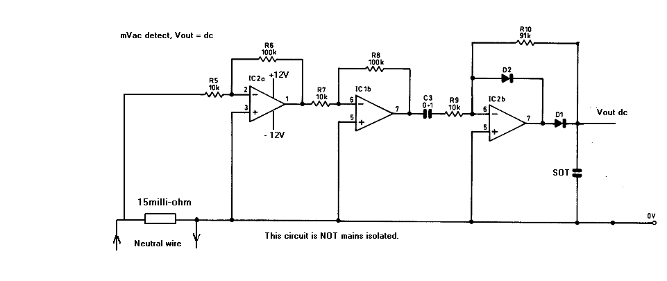

My querry is that I have 2 mV or above AC voltage as a INPUT. Firstly, I want to amplify it and then convert it to the D.C in range of 0-5V(DC), which can given to microcontroller.
Basically I am making circuit which can sense the AC current in the line., so I have attached one low value resistor across it which is giving me mV drop starting from 2 mV.

It is possible to amplify a 20mV ac signal to 5Vppk then rectify it to give about +5Vdc suitable for a PIC's adc.

Do you mean 15 milli ohms.??? and a maximum of 100A not 1000A.?
Look at this circuit, it could be modified to give what you are asking.
Tidied up the circuit diagram.
Two stages of ac amplification, followed by a precision rectifier.
Do you follow OK.?
EDIT: increase the gain of the amps to give the required dc out.
Do you follow OK.?
It's 15 ohms, but I am trying with other combination so I can improve the mV drop, and for current range, it is generally limited to 70-100 amps max, but accidently due to short circuit (between phase or neutral) it can carry more than 1000amps, so it should detect it.
