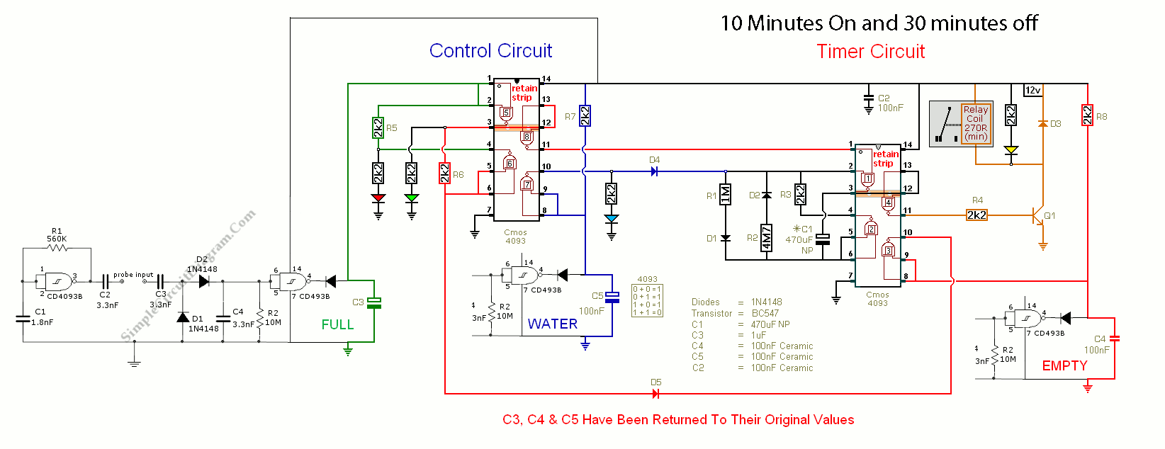

Although it won't affect the PIC coding, you may have to consider adding an electrically-operated valve to your system if the pump is of the impeller type; otherwise water could flow through the pump under the supply pressure even if the pump is not running.
Friend here by doing very hard work I have made a circuit which I have attached in my attachment..
And the working of this circuit are as follows :
We will start the sequence with the tank FULL - and the timer PAUSED
Twist the EMPTY wires together - but keep the FULL and the WATER wires separated - as in the drawing.
Turn on the power.
The green LED should be lighting - and the other two LEDs should be off.
THE Control IC (Ic2)

But the problem is ....
When the EMPTY (or LOW) sensor opens - it enables the timer output.
If - at that time - the timer is in the ON phase - the pump will start straight away.
And - if the timer is in the OFF phase - the pump will start WITHIN 30 minutes.
The timer is powering-up at the beginning of the OFF phase
So the pump will begin to run after 30 minutes.
And I want That It should to start the pump immediately - without the previous delay.
and after starting the pump it should check the availability of water for 10 minutes and if water doesn't comes
then it will turn off the pump and restart after 30 minutes... and this repeats untill the tank becomes full..
As the water comes , water sensor will detect the water and pause the timer and the pump will continue to run..
but the second problem.... is ... if the water supply goes in between before the tank is full, the pump will keep on running..
I want If the water is available ,start the pump(As my circuit does) but as the water goes it will not turn off the pump but it will wait for 10 minutes and check the availability of water(If water comes then it will pause the timer and the pump will continue to run) else it will turn off the motor and restart after 30 minutes.. and this repeats until the tank becomes full...
Thanks in advance...
what if you eliminate your timer? say if tank empty and water available pump starts. if no water & tank empty pump doesnt run until water is available. pum stops only when tank is full. then again will start when tank becomes empty? i dont understand why you want to make it using a timer????
Edit: if the idea is to keep the tank filled time to time, then you can set tank empty sensor to be active when water level comes down bellow a level....if its for me i will NOT use a timer....i have installed a controller at my mother in laws house that monitors water in two tanks, one is on the building top and another is on the ground...it just works fine and always keep the top tank filled to a certain level. also my mother in law overrides the pimp manually every day morning so that the tanks comes full and teh pump stops...
@ yusuf
Maybe its better to have a small tank reservoir on the inlet before the pump with a float valve to control flow in of water in the reservoir. In this way, you don't need an impeller type pump. This will also avoid complain by your neighbor to have low water pressure everytime water pumps was turned on. Water pump will turn on longer depend on the size of reservoir. This also avoid higher power consumption of water pump motor due to frequent start and stop of pump. As we know, Startup current of electrical motor was higher than its running current.
Maybe with this configuration you will not need the timer.
OK yusuf;
You only need two sensors and no controller or timer. Sensor one will detect when water is avalible. Sensor two will detect when the tank is full. Wire both in series with the motor and you are done. The pump will run if there is water avalible and the tank is not full. If water is not avalible or if the tank is full the pump will stop. You must detect if water is avalible otherwise you will burn up your pump. You cant run pumps without water.
Andy
I don't understand why you want to make it using a timer????
Friend Thanks for your reply.. but
The need of timer is :
As you all know this project is automated tank filler project.In which it will keep the tank full without any physical movement..
Think .....
As the tank is empty the red led will glow (Green led will turn off) and the timer will start to run.....
First I will check 10 minutes for water supply ....
If water comes between 10 minutes then I will continue to run until the tank becomes full....
Else it will turn off the pump...
And restart after 30 minutes..
Because Tank is empty and it need to be fulll.. so it will restart the motor pump after 30 minutes..
So here the use of time arises..
If there is no timer here , we will have to switch on / off the motor...
As I stay in India , here there is no fixed time of water supply to come.. it comes anytime..
Si here by adding the timer circuit it can check the water supply in every 30 minutes untill the tank is full..
The use of timer here will tackle the problem of any physical interactions...
If suppose that we remove the timer...
Just Think a minute ......
As tank gets empty it will the start the motor pump and it will continue to run untill the tank becomes full...
If suppose that water comes immediately as tank gets empty then it will also continue to run untill the tank becomes full.
But a wait a second ....
If the tank gets empty and water doesn't comes , water comes after 2 hr.. then what will happen here...
2 hr continue running of water pump is useless and it can also burn...
Forget the 2hr , it will keep on running until the water comes or any one turn off the pump...
So by adding timer here ...... it make sense...
That as the tank gets empty it will first check the water supply for 10 minutes.. As the condition of India is if water is willing to come it comes under 10 minutes..
So looking this system ... I added 10 minutes timer....
SO first it will check the water supply for 10 minutes if water supply doesn't comes in between 10 minutes then it will turn off the motor pump.... by as the tank is empty.. it will again turn on the in every 30 minutes and check the water supply until the tank becomes full..
But Friends I have completed this all but some problem are present here and I need your help to accomplish it...
My Problem is :
SO kindly have a look here and I extremely need your help... Because without your help I will not able to accomplish it... '
Thanks..
My Problem is :
Thanks..
Andy
Andy... what will happen when the tank level slightly comes bellow "tank full" sensor? pump will run for few seconds & stops? then again runs & stops...a series conection will not work..need to impliment a logic...
yousuf...
the comtroller i installed for my mother in law is without a timer, they get water once in a week only and its collected in a tank on the ground & mean time pumped to the top tank too on that particualr day, it always monitor the lower tank when pumps. a timer is absolutely NOT necessary for your task...
when the water is not available just inhibit the pump with logic, NOT with a timer...i will post you t a working circuit when i get back home soon...
For the most part I would consider that a problem with the tank full sensor. Not a problem with the solution that I have proposed.
Naturally the tank full sensor would have to account for this. Usually the flow of water does not stop instantaneously and the tank gets slightly over full preventing false triggering. Just like a toilet.
Andy
