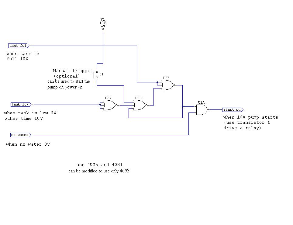

find the attached circuit using 4025 (two) and 4081, its very simple and can work as required. i dont know which kind of probe or sensor you use, you have to provide inputs as mentioned. the sensors i used is just two rods and the positive goes to the body of the metal tank

Thats three sensors. Why do you need a tank low?
The idea of the "low" sensor is to add hysteresis to the "full" point so the pump doesn't short-cycle. If filling causes waves on the surface that's what will happen. Float-type switches often have a built-in hysteresis.

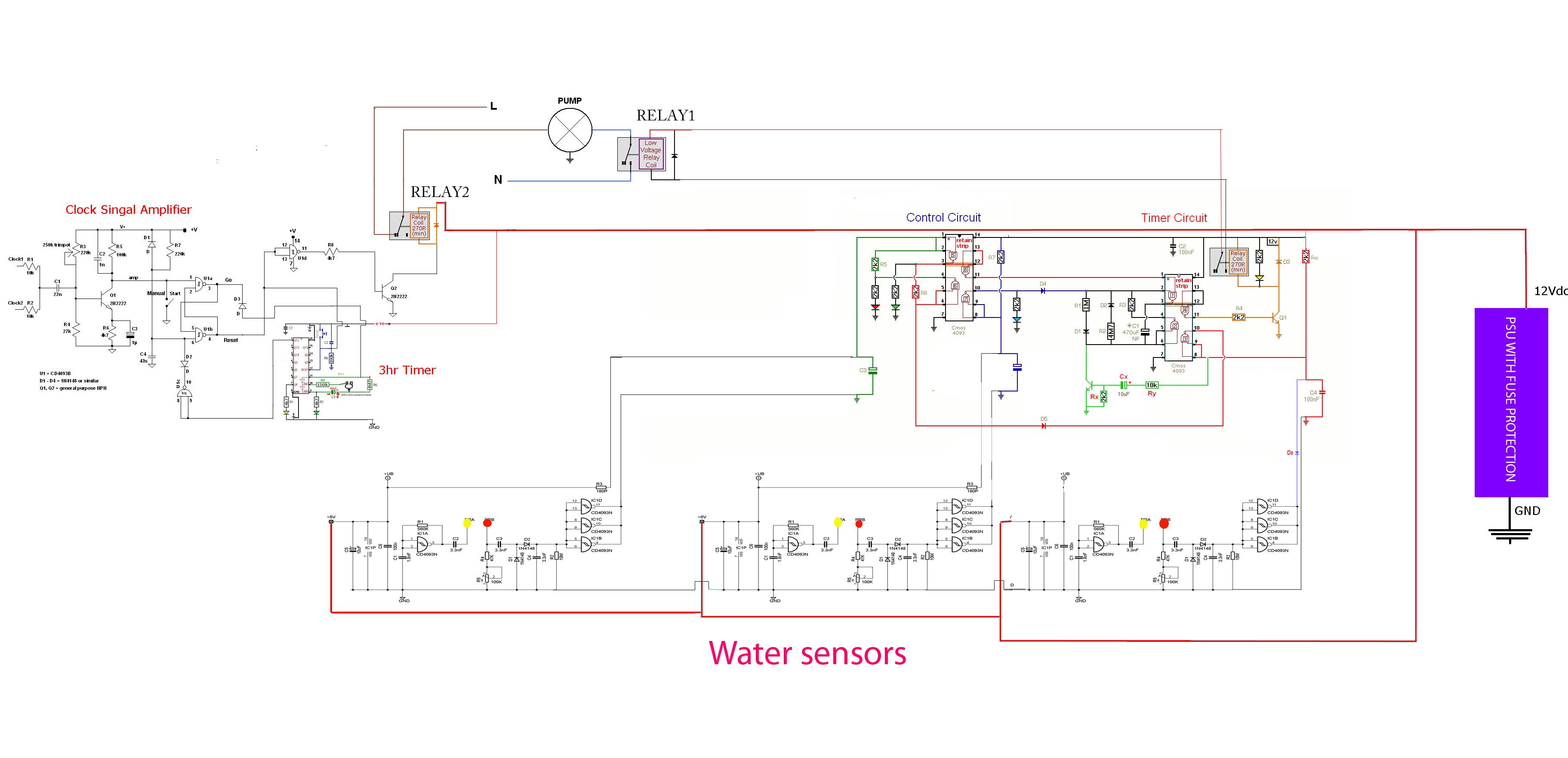

I have completed my all circuit diagram and it is working properly as I have deserved..
I have attach the complete circuit diagram in my attachment...
please have a look...
But one thing I doesn't understand ... how to solve that one...
Here you can see there is two relay...
Relay1
and Relay2...

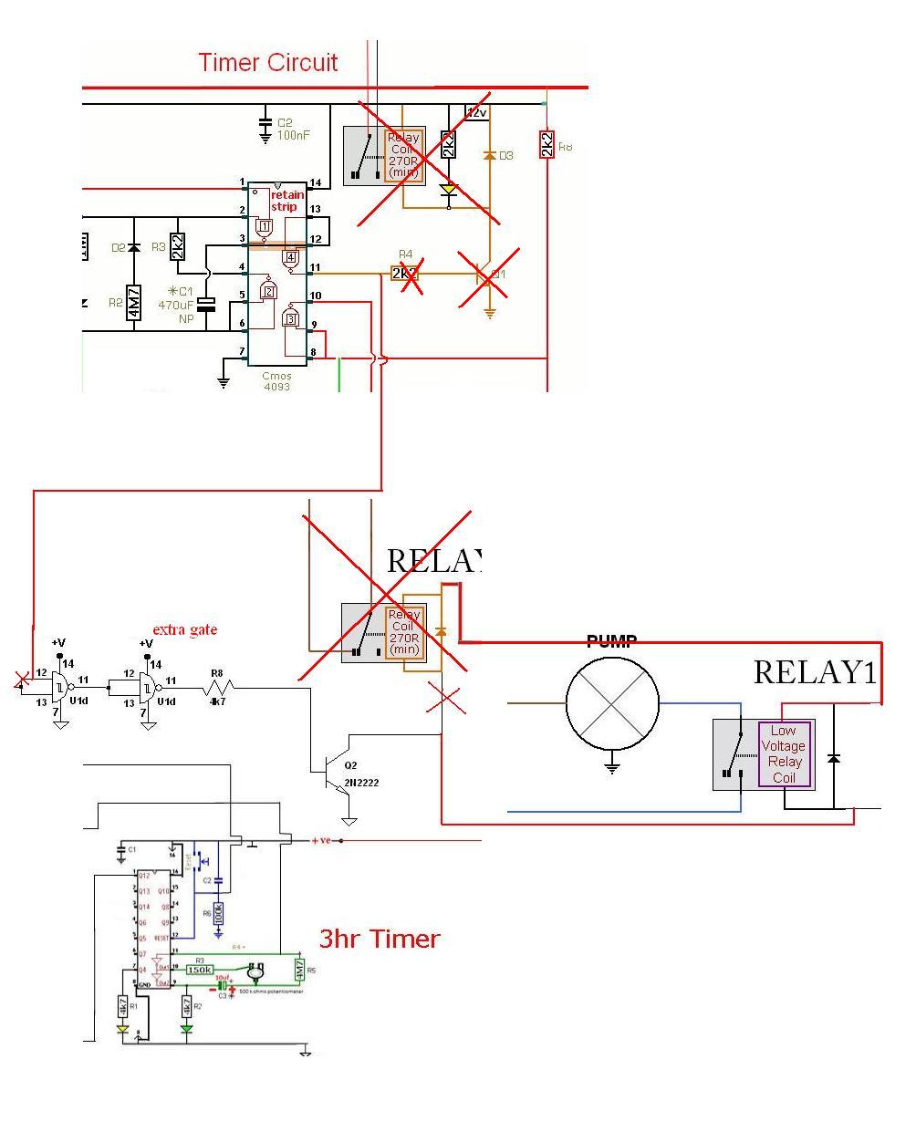

I dont want to add relay2..
I want to replace it with some kind of circuit so that it can switch it at regular interval without relay..
But by removing relay2 working should be exactly be same..... as with relay2...
THANKS IN ADVANCE... :)

If you put a NOT gate to the control signal of Relay 2 and then AND both(Relay1 and Relay2) control signals, you'll get the same output using one relay.

Are you sure? As shown, the inputs of gate 7 in the Control Circuit are wired permanently high, so it won't influence the Timer Circuit. The outputs of paralleled gates IC1B, IC1C and IC1D are shorted to ground instead of going to the gate 7 inputs. Unless C1 in your Timer Circuit (which I and other posters haven't managed to persuade you is unnecessary :)) is very low leakage you won't get a 30-min time period.

It is working properly alec....

If you say so. I'm unconvinced.
Please have a look on the problem which I have posted above with my circuit diagram
I've looked. Abchopra has provided a solution in post #49. If you removed the timer you wouldn't have the problem either ;-)

find the schematic correction required to remove a relay. i just showed the required part of your circuit only.
best of luck..
