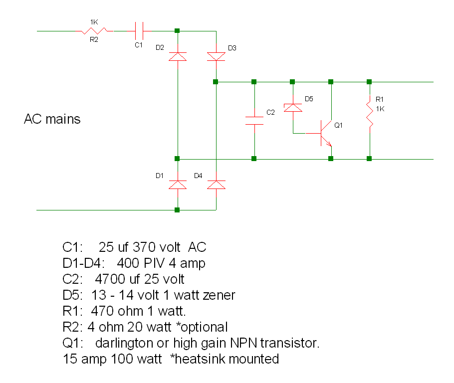

What are you powering that takes two amps at 12 volts?
A capacitive power supply can easily do 2 amps.
You guys must not work with AC motor run/ power factor correction capacitors much. You would need only need a 25 uf 370 volt AC capacitor.
The modern ones of that value are about the size of a camera film can.
Heres a basic schematic of what you would need.

And once again, if the capacitor fails short circuit the entire projects explodes into a ball of plasma, and anyone touching something electrically connected to the device will have their heart stopped. The size benefit is negligible. Weight can't be a problem as it's a mains powered device. There's no point from the begging for it. If you want small/light still use a switch mode supply which has a tiny transformer.
Modern AC capacitors all have internal fusing standard. Most have well over 100K hours life expectancies at room temps too.;)

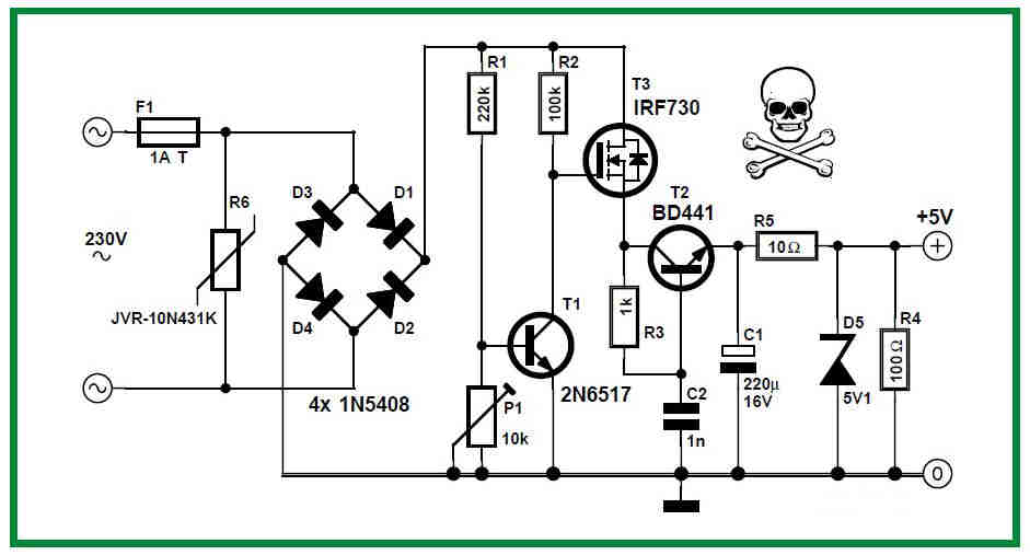

Here is another circuit which might suit your needs after minor modifications.

Thanks for the additional circuit diagram but, I guess it's a little too advanced for me. I don't understand some of the symbols.

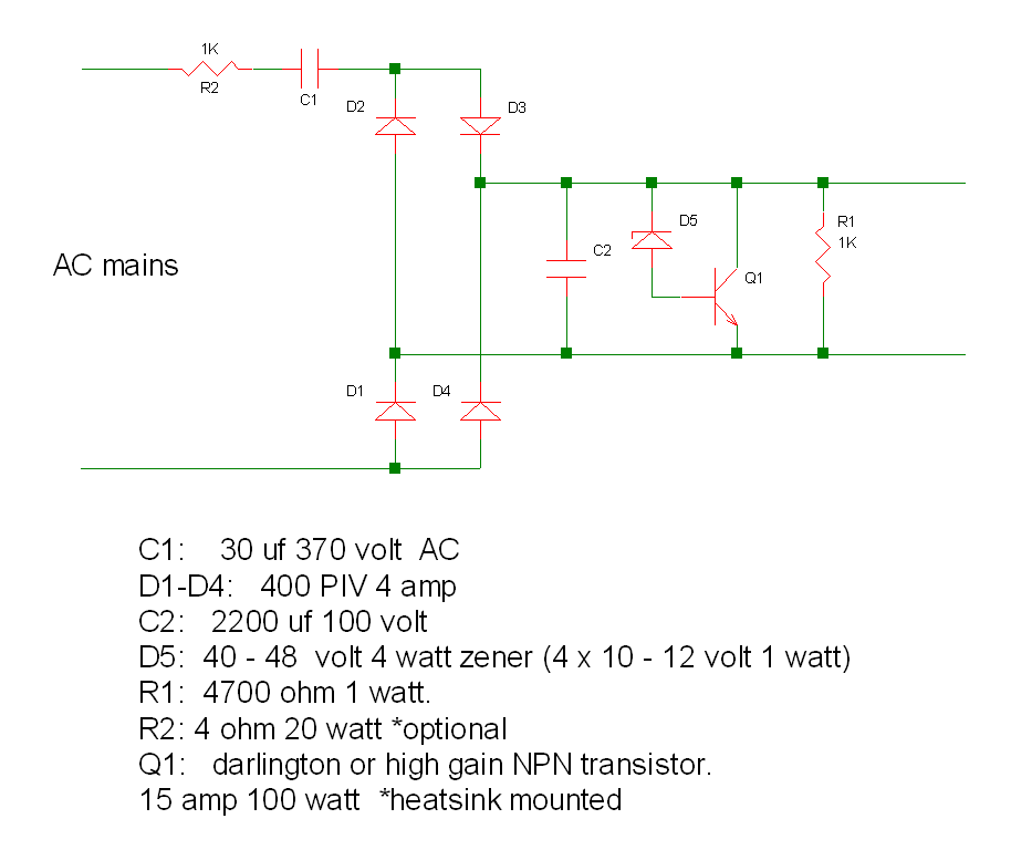

Whoa! Did I miss something? I have been trying to make a circuit like the one you showed but, EVERYONE says don't do it, it's dangerous. I need a circuit like this one that changes 120VAC to 36VAC or 48VDC at 0.66amps, if I bypass the internal bridge rectifier. It looks like I could build several of these to run my seperate driver boards. I believe I could put these circuits in a seperate box to keep everyone safe.
I am feeling generous today! here you go!
120 VAC to 40 - 48 VDC at .75 Amps peak.
Dont hurt yourself, line powered, use caution, Blah, Blah, Blah.
You were warned!;):D

Thank you and all your generousity! I will use caution. Ok, now that I have it, I feel a sense of doom. Other than keeping this circuit dry and keeping all hands off, do I really need to keep any other precautions. For example fuses, isolators, insulation, etc...
I feel like I've been given Padoras box and I don't want to let any demons out that might bite me or others.
Thanks.
Depends on who you ask! A one amp fuse and a GFI should cover the basics. Put it in a weather tight box if its possibly going to get wet.
For a three wire cord with built in GFI on the cheap stop by garage sales or thrift stores and pick up a modern hair dryer for a couple of dollars. The cord has that built in GFI all wired up for you!
I often buy outdoor circuit breaker boxes for things that need to work in damp or wet environments. Mount the heat sink on the side some place and use silicone sealer to make it leak proof and your basically weather proof and tamper resistant and
the fuse and GFI cover everything else as far as the NEC code rules are concerned.

Thank you. Please indulge me and let me please ask something else. The variability between 40v and 48V, is that dependant on R2 or the zener (am I suppose to use 4 1W zeners if I can't get a 4W) and (as if I wasn't allreay too anoying) why is R1 optional?
