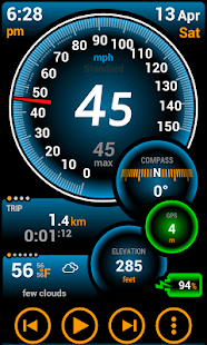

I know this won't be the answer you're after, but have you considered an Android phone? Without cell service, there are programs that give you everything on your list but temperature. Speed and elevation are calculated from GPS readings. Check out this app, pictured below.

Jon & AK:
Thanks for the suggestions. Building the project and using it , is where the fun is. So, I want to design and build it.
I failed to mention, I also have a 16 channel multiplexer. If push comes to shove, I figure I can "display and wait" and build in a select and hold feature. Tx again Eric
