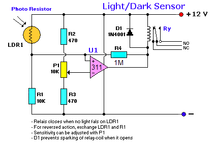

In this schematic:
Can R2 and R3 be combined into 1 940 ohm resistor(if there was a resistor of that value). Or is there a reason they are split into 2?

No.
The two 470R set the adjusting pot in centre of the Vcc/2
R2 and R3 do two things. They limit current into/out of the non-inverting input of the 741 in the event that the pot (P1) wiper is run all the way up or down, respectively.
They also decrease the sensitivity of P1 by better spreading it's adjustment range.
You could eliminate R2 and R3, and then put a 1K resistor between the wiper to the non-inverting input. This current limiting into the input is not really needed with most modern op-amps. The 741 is an archaic design which may need the extra protection.

With a supply voltage of less than 15 volts there is no limit to the input range of a LM741. R2 and R3 can be eliminated, however, the circuit will be very difficult to adjust/calibrate with using and expensive 10 turn potentiometer. Leave R2 and 3 in the circuit and you will have not problem using a cheap 1 turn pot.

From my 741 data the input range should kept less than 2V of the supply rail.

R2 and R3 would have to each be much bigger relative to the 10k of P1 in order to desensitize wiper movement along P1. As shown, R2+R3 is less than 10% of 10K, so the whole "expand the range of P1" discussion is moot.
In the diagram the + voltage is 12volts. Does that mean the non-Inverting input of the op amp is seeing 6?
If so is that by design? Because some of you were saying you could basically get rid of R2/R3, but if so would it not then see 12volts? Or does that not really matter?
I wouldn't recommend using the 741.
I think you use a comparator such as the LM311, it can directly drive a relay (no transistor required) and it completely disconnects the relay when it turns off.
You'll need to reverse the inverting and non-inverting pins.
I've also added a feedback resistor to give some hysteresis whcih will make it more stable.

As shown in the original circuit, the voltage at the non-inv input could be anywhere from ~1V to about ~11V, depending on where the wiper of P1 is.

If you left out R2,R3, the entire 12V would appear end-to-end across the 10K pot. The non-inv input could then be adjusted from 0V to 12V as the wiper is moved.
The discussion about current limiting into the non-inv input of the 741 has to do with what happens as the wiper is run all the way up, and the input goes to the same voltage as the 741's V+ pin?

Sorry bear with me here. So if R2 and R3 are gone, the noninverting would see the full 12v? How can it see 0->12V then? Doesn't the pot only limit current? Not voltage?
Read up on "Voltage Divider". The Pot is a voltage divider consisting of the resistance from the top end of the pot to the wiper, and the resistance from the wiper to the bottom end. The wiper can be moved all the way from the bottom to the top, so the wiper voltage "taps off" any voltage from 0 to 12V as the wiper is moved.
