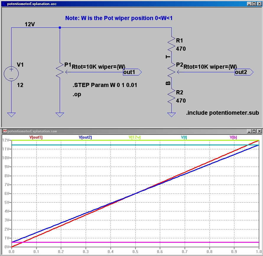

You are going to have to help me with this....
The part I'm a little confused on is Pin3. Correct me where I am wrong. If P1 is at the center of it's rotation then it would be at 5000 ohms correct? The total Resistance between V+ and ground would then be 5940 correct? so If you take 12/5940 you get .002 Amps. So the voltage across R2 is 0.94 volts. R3 is also 0.94 volts. Votage across P1 would then be 10volts.
Is all of the right or am I off?
If I am right I don't know where you get the +0.5v thru +11.5V for voltage on pin3. Am I missing something?
Stare at this:
You must include all the resistance in the chain. The 10K dosnt change value, only the position of the pots wiper.
Wait..why does the 10k not change value? Isn't that the purpose of a pot is that it can change from anywhere from 0-10k? Isn't that what moving the wiper does?
If one end of the pot was connected the wiper, it would change value from 0ohms to 10Kohms.
As the wiper is NOT connected to any end of the pot, the value measured at the two ends of the pot remains 10k.

So you are saying only 2 of the legs are used on the pot? And if the wiper is not connected to anything then it won't do anything when you turn it then right?
So why even have a pot and not just use a 10k resistor?
Look up the difference between a "rehostat" and a "potentiometer". Hint: one has two connections to the outside world; the other has three.
Ok so let me see if I have this right. R2 is connected to one end and R3 is connected to the other. There is always 10k ohms through the pot in this configuration. The wiper terminal is connected to the op amp, and moving it ONLY adjusts voltage beween max and min.
If this is correct, does the op amp see the 10kohms from the pot?
