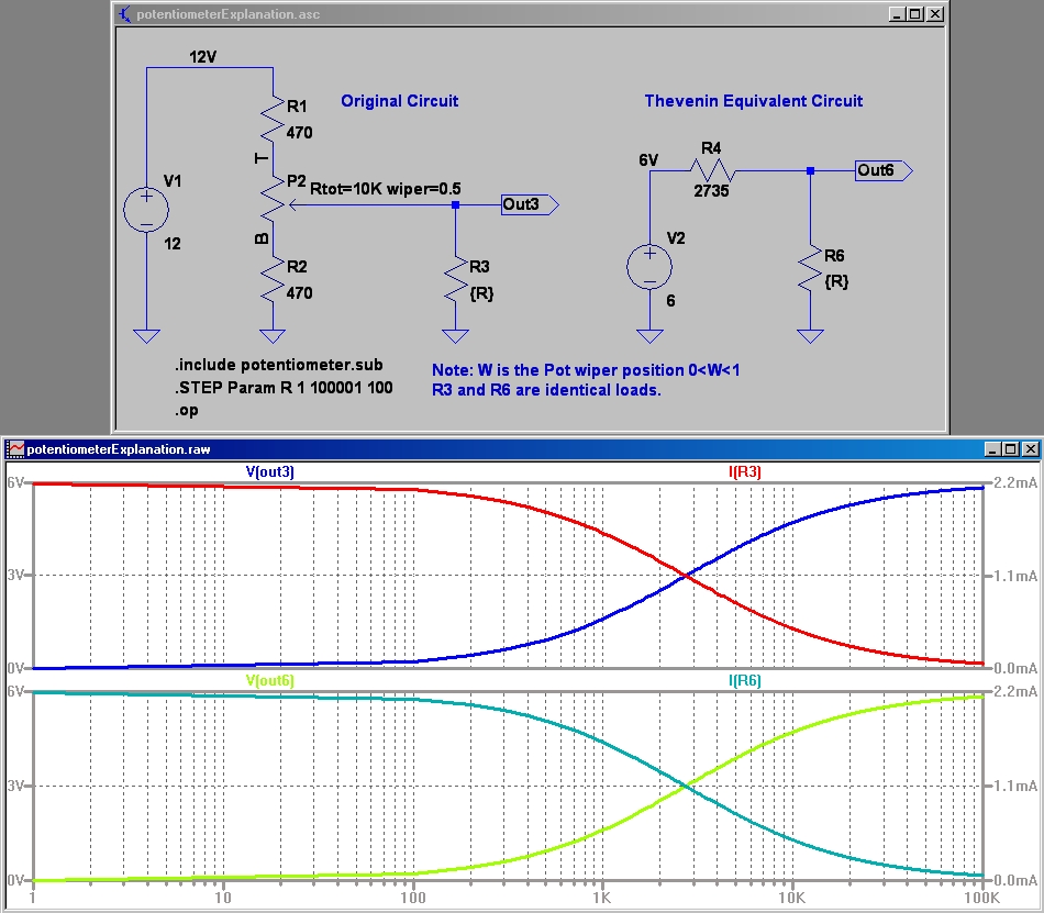

Yes to the first question. Let me paraphrase your second question:
If I were standing on the non-inv input of the opamp, looking back at the pot wiper, what is the source resistance of the voltage that I see as the wiper is moved from top to bottom?
The answer can be answered with some algebra which I don't have time to solve for you for all positions of the wiper. The solution is called the "Thevenin Equivalent Source Resistance".
Lets just take a single position of the wiper; where the wiper is in the center. The resistance above the wiper is 5K (half the POT) + 470 = 5470Ω. So is the resistance below the wiper. For computing the source resistance, you find the parallel combination of the two 5470Ω resistances, which is 5470/2= 2735Ω.
The open-circuit voltage with the wiper centered is 12/2=6V.
If you were standing on the non-inv input looking back(electrically speaking), you cant tell if the non-inv node is being driven with the resistors/pot or a 6V source in series with a 2735Ω resistor.
Now, knowing the Thevenin Equivalent, you can ask the following very important question. If the input bias current into the non-inverting opamp input is e.g. 10uA, what is the actual voltage there?
Using the Thevenin Equivalent resistance of 2735Ω, what is the voltage drop across the resistor at 10uA? E=I×R=10e-6×2735=27.35mv, so the actual voltage at the non-inv input would be 6-0.02735= 5.973V. This is can be important (or insignificant) depending on what the opamp circuit is asked to do.
Now, using the Thevenin Equiv above, compute what the output voltage at the pot wiper would be if you were trying to draw 10mA off it? This goes to your suggestion that a pot is like a voltage regulator.

Yes, that would be the drop across the 2735Ω resistor if 10mA were flowing through it, but notice that the Thevenin Equiv voltage is only 6V, so there is no way you can draw 10ma. It was a trick question.
In fact, if you grounded the wiper, the maximum current (with the wiper at zero volts) would be I=E/R= 12/(470+5000)= 2.2mA max! So much for it being a substitute for a regulated voltage. :)
Stare at the attached simulation. Can you tell the difference between the behavior of the Original Circuit on the left compared to the Thevenin Equivalent on the right? The horizontal axis is the Load Resistor value plotted logarithmically. Note that as the load resistor get closer to zero Ω, the voltage is near zero, and the maximum current is 2.2mA, as calculated above.
I think I'm starting to understand. Thanks for all the help. I think I may need to study the Thevenin equation a little more to really get a good handle on it.

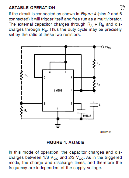

Just to make sure I have some of this right. In this pic(555timer astable circuit) :
If you had a 9volt power supply would the voltage at pin 7(I know thats the discharge pin, but just for learning sake) be 8.96?
If the astable is running it will not be at 8.96V.

Read the text at the bottom of this image.
its 2/3 and 1/3 Vsupply.

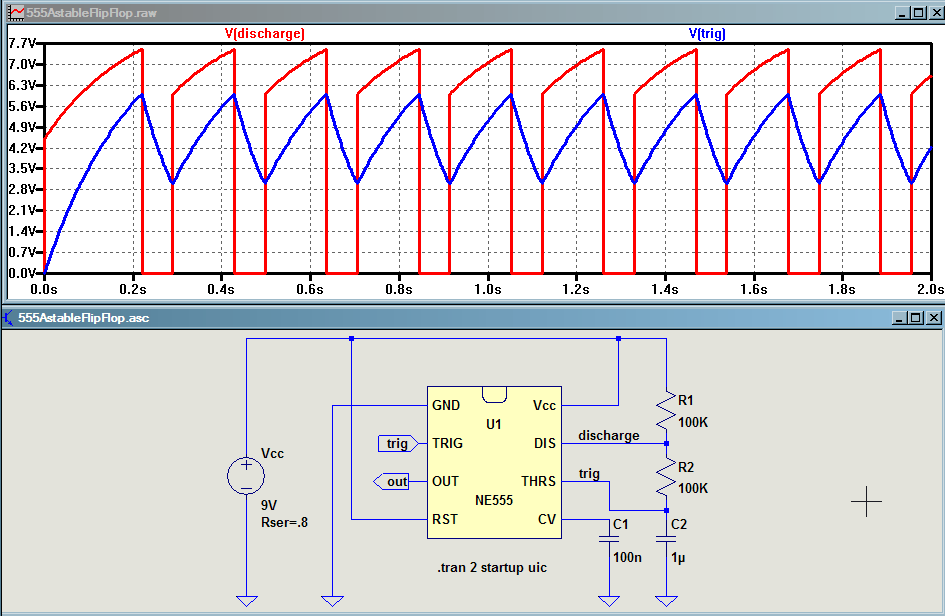

Look at these waveforms for the threshold and discharge pins.
Ive changed the resistor values to make the wave more clear.

Are the reasons my numbers are wrong because the Capacitor is in series with the 2 resistors and not parallel?
I can't find what I was reading before, but I seem to recall when connect a capacitor in series with a circuit and not parallel acts differently. Like it blocks the flow of electricity when it is full.....or something.
The use of a capacitor in a 'coupling' circuit , when its used to block the dc component of a signal is different from the 555 circuit.
In the 555 astable, the cap charges up and down, so the voltage on the cap rises and falls.
Its used as timing capacitor and the two resistors control the current into the cap [charge] and flowing out of the cap [discharge]

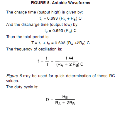

Check this image, tell me what you think.. RA is the top resistor and RB the bottom.
Looking good.:)
I've actually used that before :) It tells you how long it takes to Charge and discharge to the 2/3 and 1/3 based on the value of the resistors and the capacitance.
