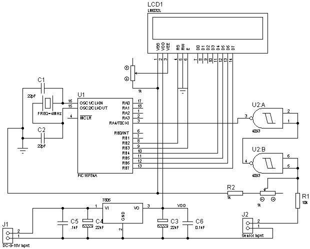

I have been searching for plans or schematics for a digital tachometer
which I could use on my metal lathe. 0-4000 rpm.
Does anyone have any ideas?
Thanks, B&M :lol:
The simplest thing I can think of is a reflective optical switch (LED + PhotoTransistor in the same package) and a peice of black electrician's tape on a reflective spinning part of the lathe. Then all you have to do is count the number of pulses (1 per revolution) or time pulse length and display the result. A Microcontroller would probably be the easiest way to count pulses and display the result. You'll find tons of old posts about how to program the microcontroller and set up the opto switch.

maybe a inductive proximity switch would work.
I have some of them. I just don't know anything about PIC's
Here is my design.
Any comment !! Anyone !.
I'll post the code later today or tomorow.
STEVE
