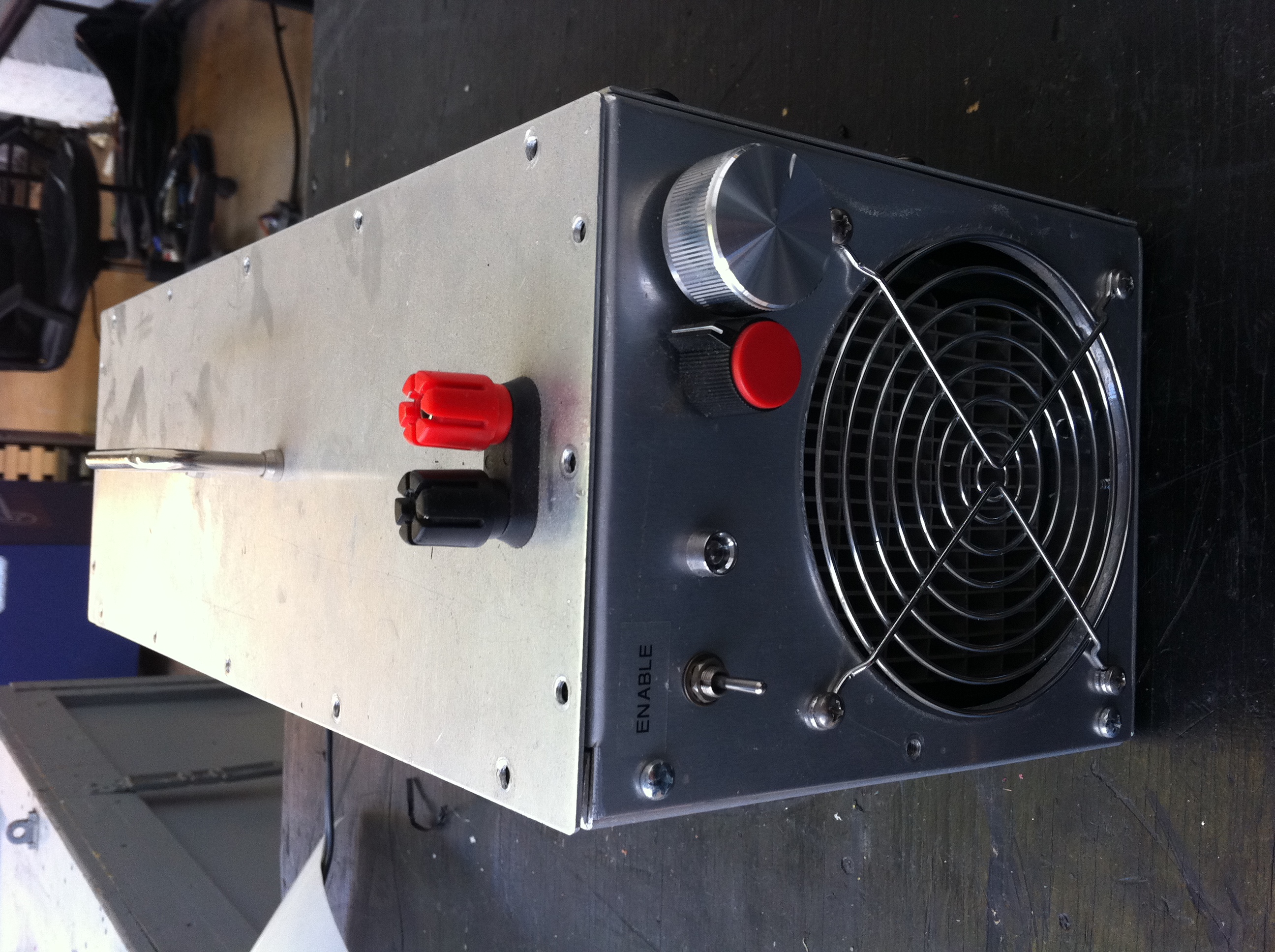

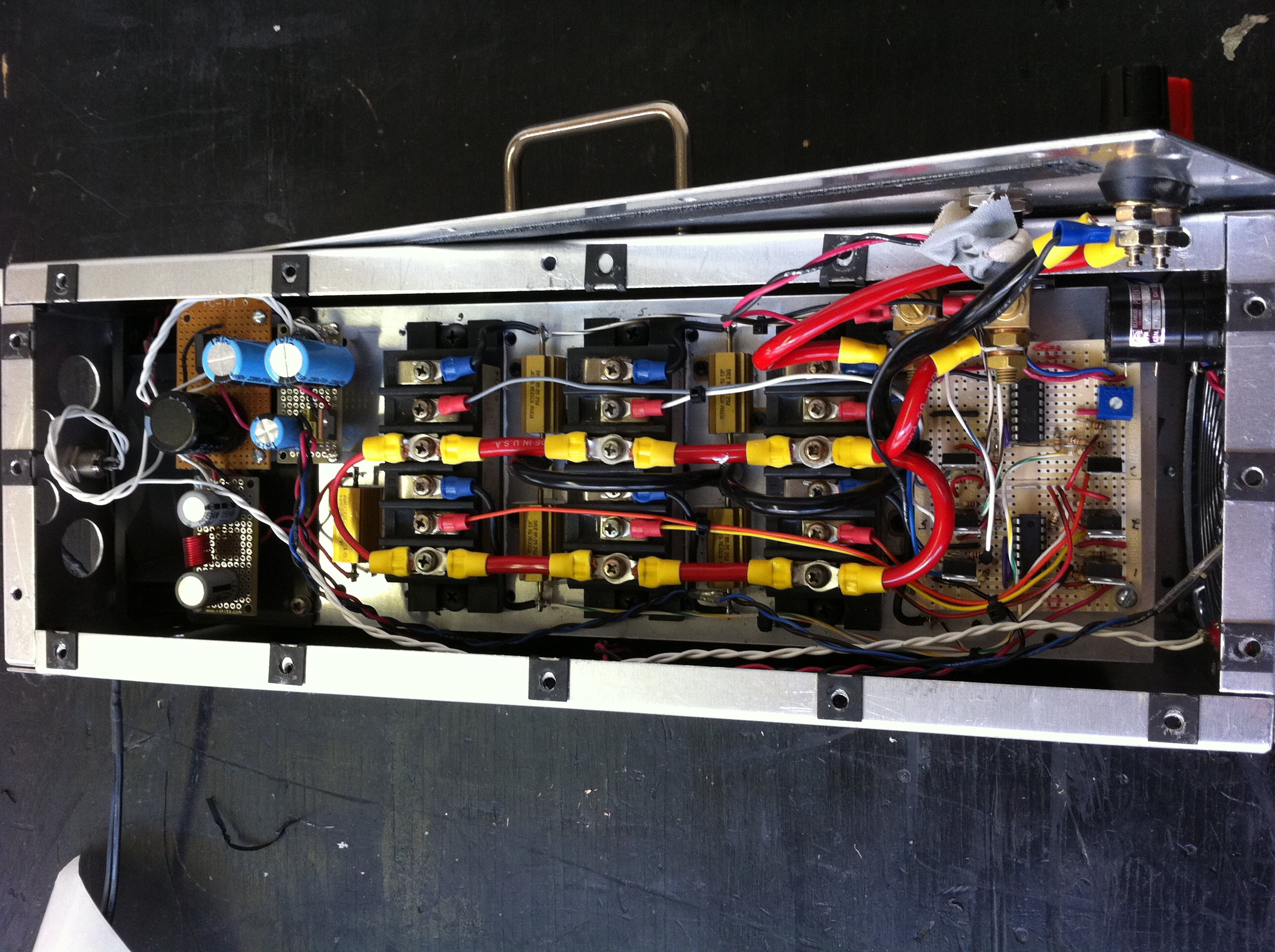

So it's been two years and I just realized I never reported back. The test load has been in use at both home and mostly work without a problem. At this point I haven't needed to build the larger one although I plan to when I have time. Here's a couple shots of it.
Thanks Roff for all your help!
