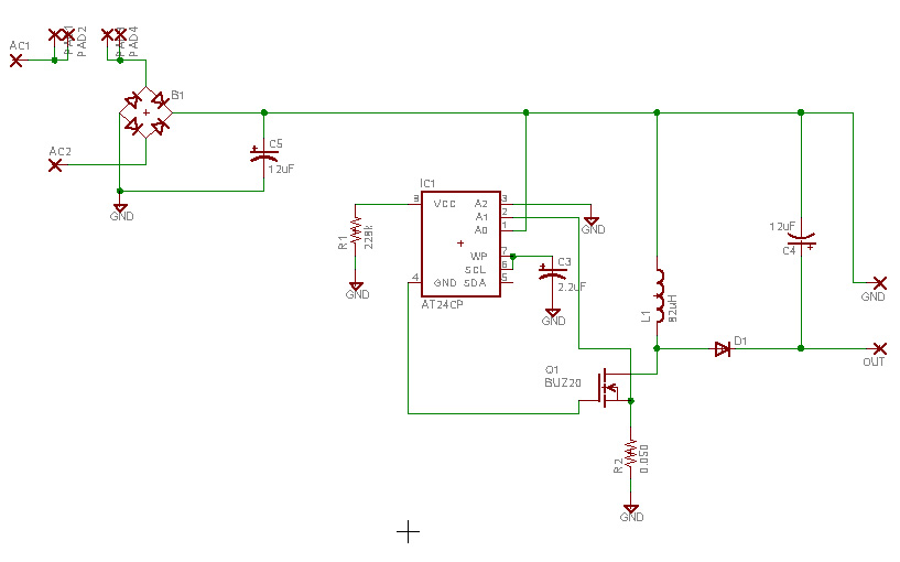

I'm looking to build an LED array. I've decided on the HV9910 switcher "buck-boost" supply. It will be powered by mains (120V) and output between 83-130V DC @ 700mA. I followed the application note for designing the circuit, but have never built a switcher before. One thing that concerns me is they wanted a 12uF cap on the output, with low ESR (tantalum or ceramic). Problem is @130V, that's at least $50 worth of caps. I plan on using a $2 electrolytic instead. I don't care if the ripple is huge or efficiency is 30% ;) But will this cause any other problems? Should I use a larger cap to make up for it?
I'm attaching my circuit diagram (drawn in eagle). If you could look over it, see if anything sticks out I would greatly appreciate it. I know doublechecking my math is probably too much to ask ;)
I wasn't able to find 12uF @250V caps, so I have to use 15uF's on the input and output. I think the input cap is probably too small for the current (>1A) but there's no more space in my box so it'll have to do.
Also, ignore the part number on the central chip. I borrowed one from the atmel library so I could have a DIP socket..... obviously the HV9910 isn't in there and I didn't care to draw it.

use a bunch of smaller value electro's in parallel to achieve your desired capacitance .... like resistors, each one in parallel halves the esr. six 2.2 or three 4.7
you'll also want to make sure your schottky is rated for the (iirc 150% of Vout), and the switching transistor as well.
i should add ... I've seen designs implementing both parallel diodes and/or parallel fets in attempts at reducing switching losses
Is there any reason why you're using the buck-*BOOST* configuration of the circuit? PG. 6 has the main wall-outlet configuration that has reasonably sized capacitors. In the boost configuration, pin 1 of the inductor swings *up* to 2xVin meaning that that diode array is going to be exceedingly dangerous. Q1's rating is also going to need to be boosted accordingly.
Incidentally, schottky diodes in those voltage ratings are a bit on the rare side - the example schematic uses a standard fast-recovery diode...

Yes, for the buck mode, it requires vin > 2*vout... when my vout has the potential to just about equal vin.
I'm using an ultrafast recovery diode... Or at least spec'd one.
Yes, the high voltage is something to consider. I guess to sum up your arguement, you're saying I should build 2 supplies for 1/2 the led's using buck configurations?

Did not know that, thanks! So what's the bad consequences of a single "high ESR" cap?
Fet and diode are rated for 400 volts

One last thing to persuade you *not* to use the buck-boost configuration: If the LEDs go open circuit at all, even for a fraction of a second, that inductor is going to spike to some extremely high voltage and smoke the entire circuit very fast.
If this is your first switching regulator, go ahead and try this at a nice low voltage rating first - put it on 12V DC, and watch what happens to that circuit. I'd put bets on it reaching well over 100V at the low input voltage, and sparks developing shortly before becoming a smoke generator if you plug it into the outlet.

You have to be really carefull with doing this. Paralleling caps in a switcher can lead to one of them passing the majority of the ripple current and thus exceeding it's maximum ripple current rating. How much will all these LEDs cost? I would think that the cost of the LEDs will dwarf the cost of the proper caps.

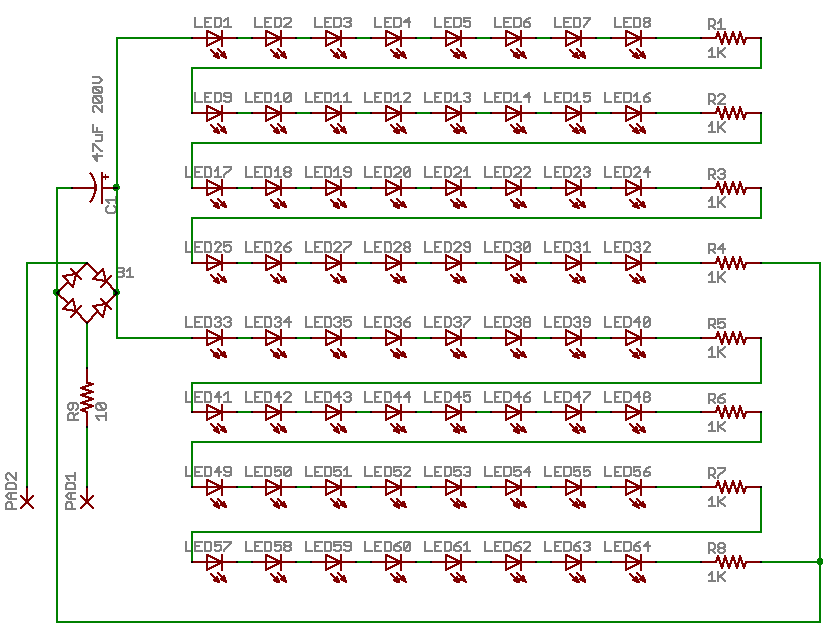

Whenever I build anything that uses mains voltage I try to keep it as simple as possible. Below is a circuit of a lightbook I made for my wife. Mind you the power levels are much lower (15ma Led current) but it is pretty simple with not much to go wrong. R9 is there to limit the surge current into the cap and bridge when it is powered up. I used muliple resistors in the LED strings so I could use cheaper 1/2 watt units and spread the power dissipation around the PCB more.
Yes!!
Exactly what I'm looking for!
I originally wanted a single transistor current source, but calculated the heat dissipated in the 30+watt range... Not cool (literally)!
