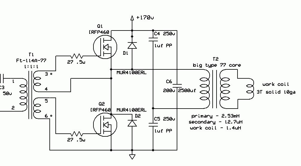

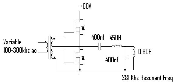

Ive attached the end part of my circuit. Its basically a half-bridge that provides high frequency, high power to the next part of the circuit. The capacitor and the inductor in series limits the current, the capacitor and inductor in parallel has a resonant frequency that has to match the input frequency in order for it to function perfectly.
This should work but i think that the problem lies with my mosfets

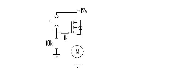

Here is my test i described in the first post, surely a 16amp mosfet shouldnt blow just running a 1amp motor like this. Note: I forgot to include the diode in the schematic to prevent back-emf.
edit: i have realised why the mosfet keeps blowing from the circuit above, but still cant understand why they are blowing in the half-bridge.
Thanks audioguru for reminding me, i totally forgot about attaching the source to 0V, i usually do that with transistors, i know that if the gate voltage exceeds the drain voltage that it may kill the mosfet, but if you look at the schematic of my half-bridge they still blow very easy even when i use the 1a motor.
Oh i also forgot to add the resistors to the gate, they should be around 100R. I keep getting mixed up a lot, im only 16 so im still learning.
i know that if the gate voltage exceeds the drain voltage that it may kill the mosfet.
No.
The gate voltage has nothing to do with the drain voltage.
The gate to source voltage must be 10V or 12V for the Mosfet to turn on. If the source is at 0V then the gate must be +10V (for an N-channel Mosfet) then the Mosfet turns on and the drain drives the load to 0V.
You had the Mosfet wired as a source-follower. Then the gate voltage must be +22V for the source to go up to the 12V drain voltage when the Mosfet turns on. But your gate voltage was only 12V so the source voltage would rise to only 2V.

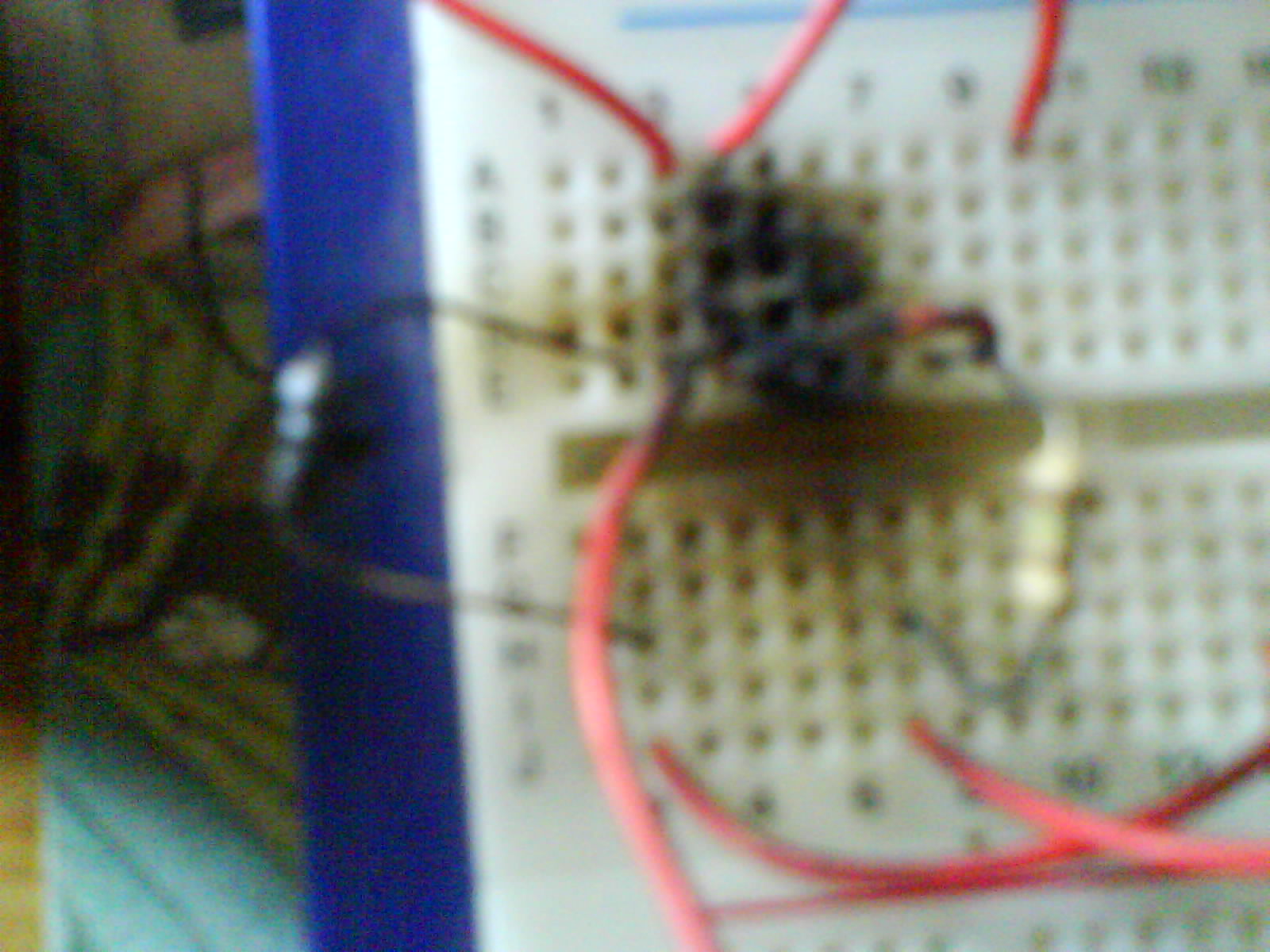

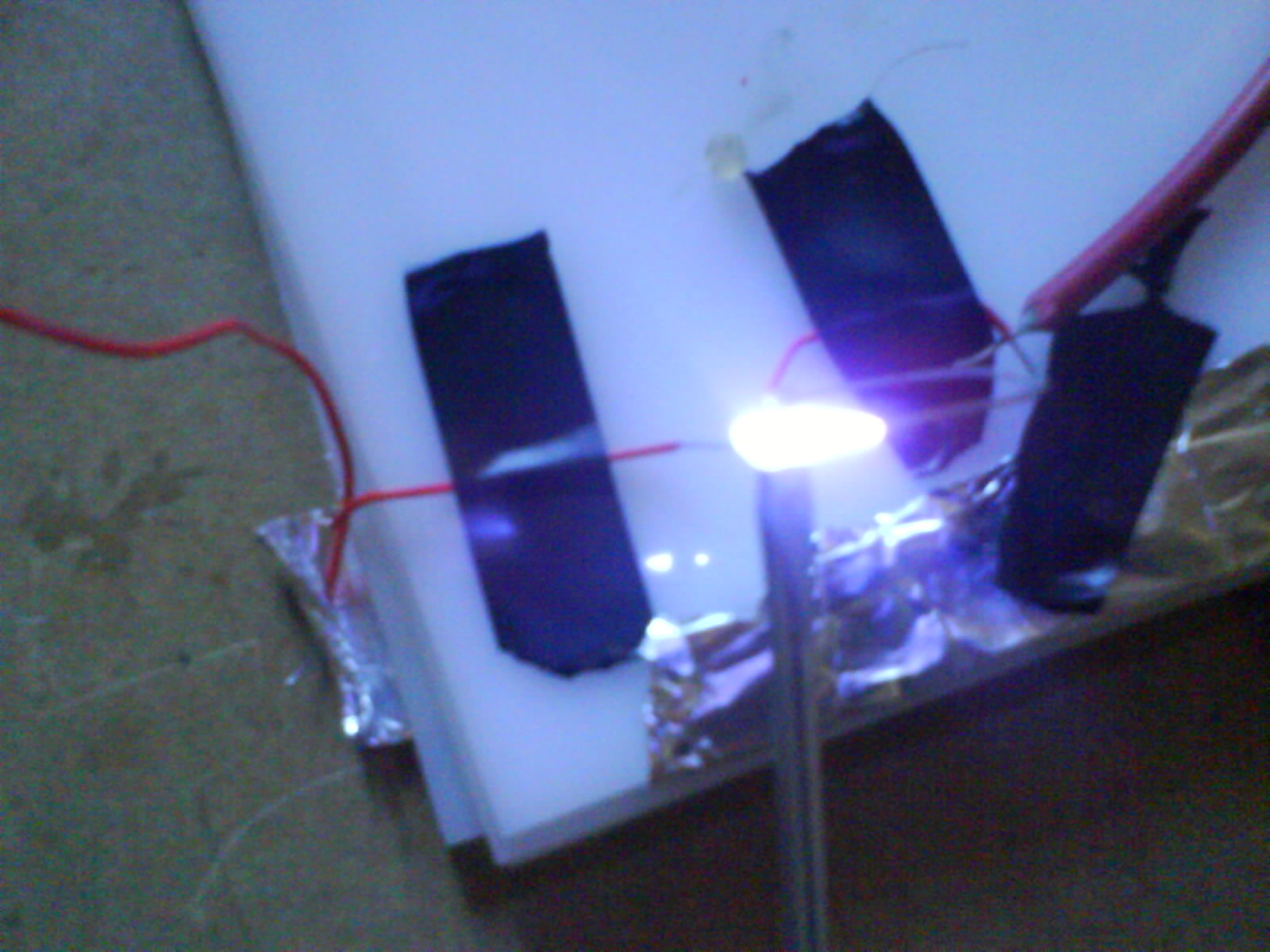

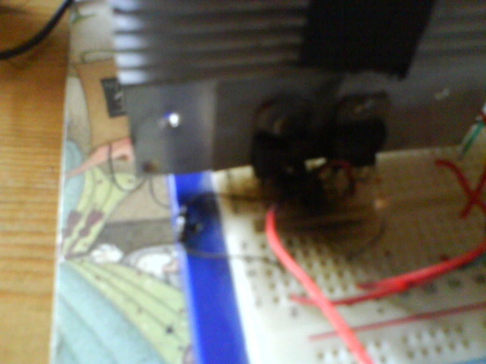

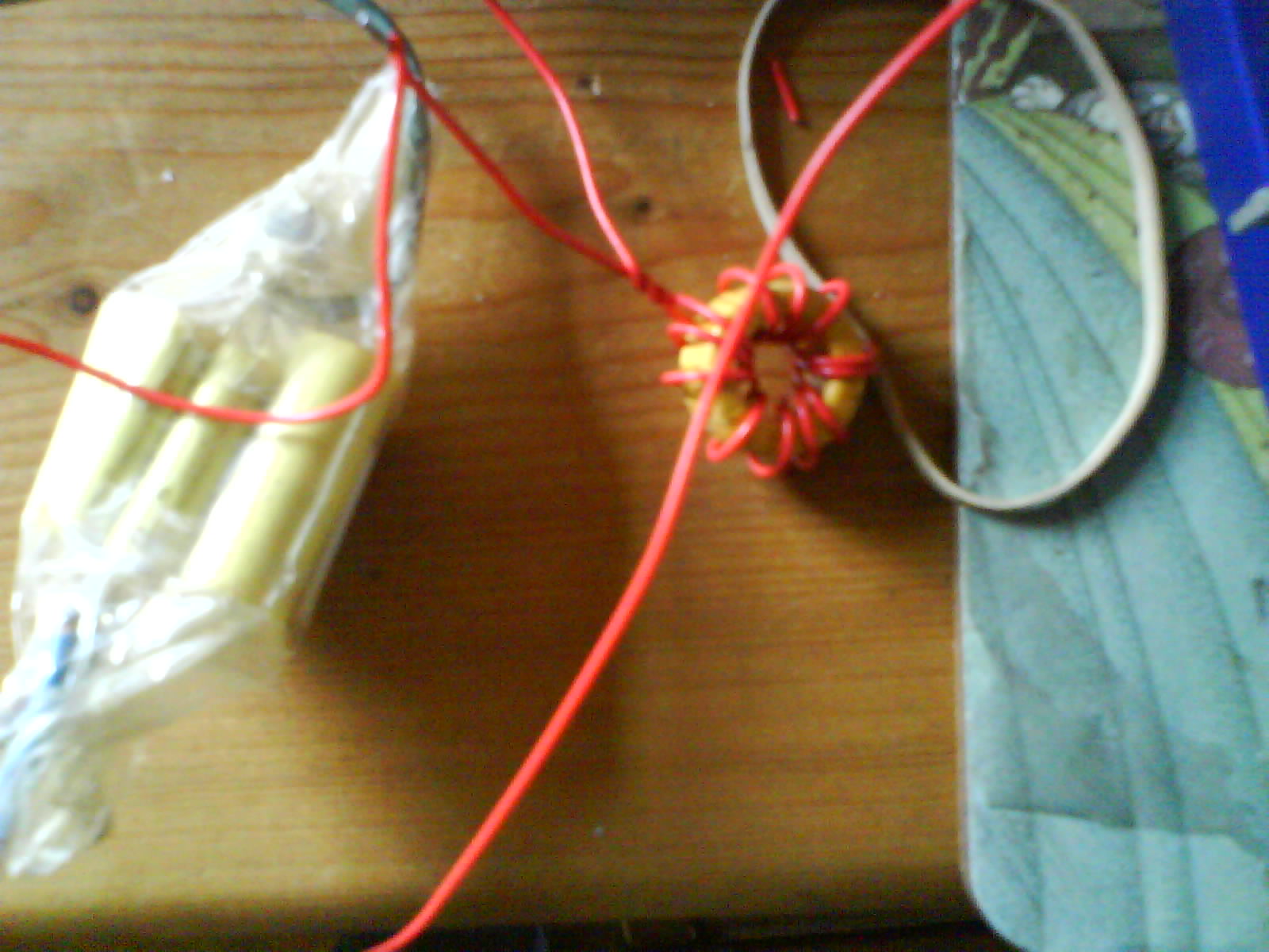

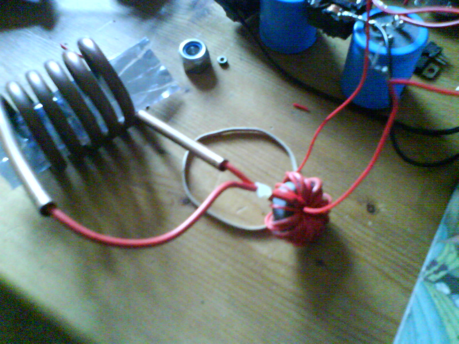

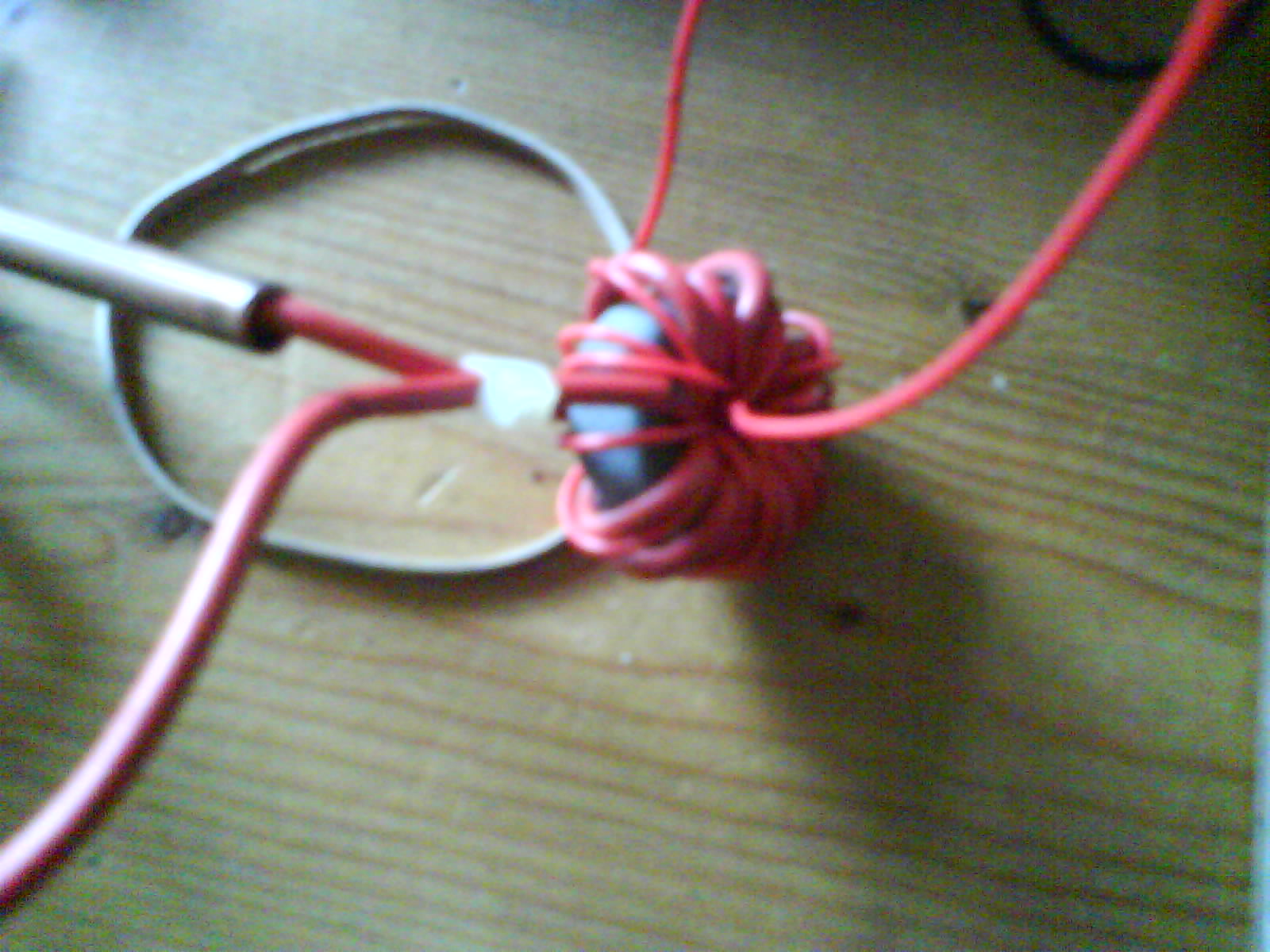

Heres a few pictures of my setup for my induction heater.
I was running the mosfets at 30v, it was working perfectly
Well until i went to 60V, this happened
There was a lot of smoke and quite a bit of fire, i just wish it hadnt burnt my breadboard.
If you had the load connected to the source of the Mosfet like in your schematic, then the load gets only 2V when the gate voltage is 12V. Then the Mosfet has 10V across it and gets warm.
If the supply to the Mosfet is 30V then the load still gets only 2V but the Mosfet has 28V across it and gets hot.
If the supply to the Mosfet is 60V then the load still gets only 2V but the Mosfet has 58V across it and gets extremely hot.
But if the load is connected to the drain of the Mosfet then the voltage across the turned-on Mosfet is low and it does not get too hot. The load gets almost the entire supply voltage which is what is wanted.
A breadboard cannot handle the very high currents in your circuit. Of course it burned.
Above is basically the circuit that i made, except the voltage was 30v and most of the values were different.
Note: the schematic is not mine, its just almost the same as mine, quicker to copy it than create my own.
Your sketch of a single Mosfet is completely different to the circuit that is driven from a transformer.

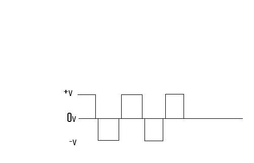

Any way, i know that the problem was my mosfets and my oscillator, i think that the turn off time was too slow for the mosfets, the image below is what i could to with supplying the transformer with to drive the mosfets.
With this the mosfets wont be all on at once and therefore wont blow or heat up as much. The period when voltage is zero will be the mosfets turning off time. I could do with an oscilloscope the find the perfect output from my oscillator.

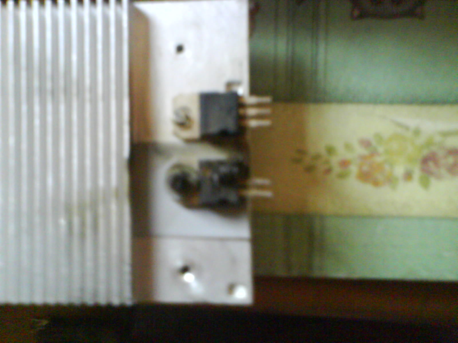

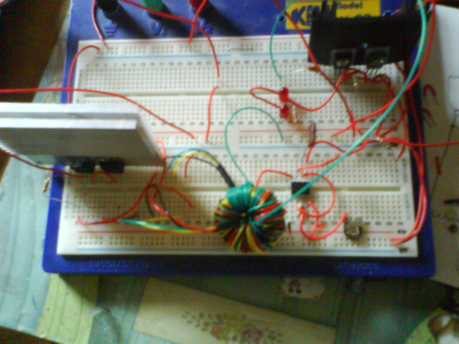

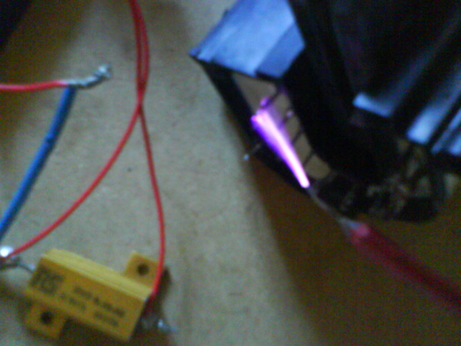

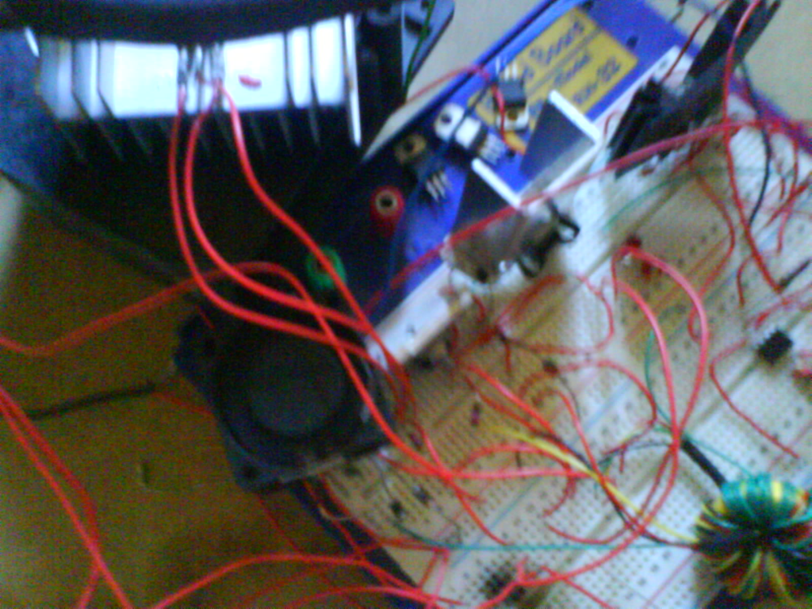

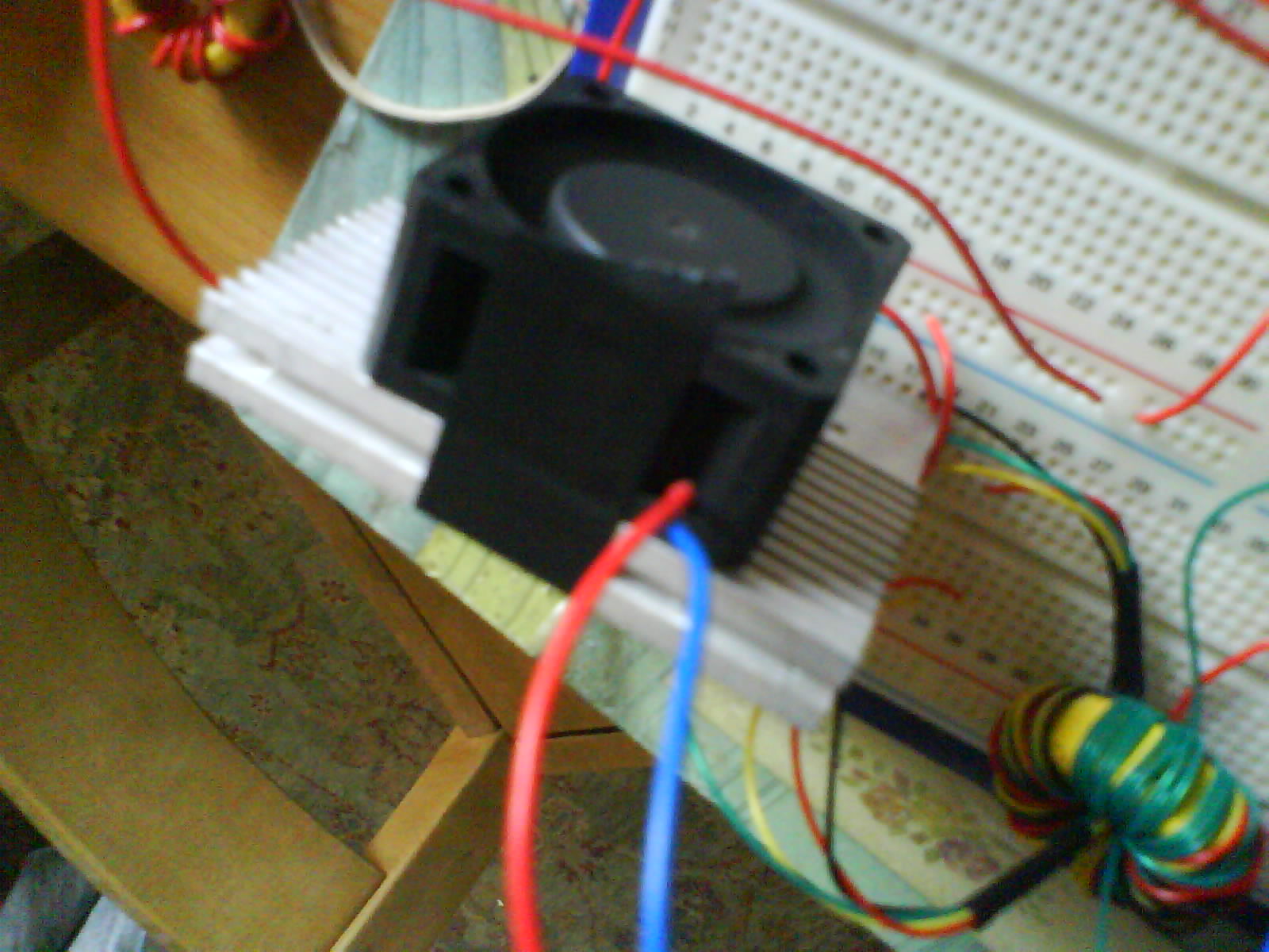

Any way i took some mosfets from an old inverter because i couldnt be bothered to make a new oscilator, these have a higher rating so shouldnt blow with my supply. I hooked it up to a flyback transformer from a tv, with only 6 turns on the primary. Result they didnt blow, i will still have to make a proper oscillator for when i scale it up for my induction heater.
DSC00332.JPG Plenty of heatsinks and fans to keep it cool
10mm juicy sparks because of big capacitor
20mm spark straight out of transformer

oh i know that they cant handle a great deal of current but im not using that much in this case. I could not be bothered to wait for the soldering iron to heat up so i took the risk, when i scale it up i will just use the breadboard for the control electronics. The only reason mine melted is because a mosfet blew and a resistor set on fire, it was quite cool though
If you gotta cool it with a fan it's way too much for a solderless breadboard. Just use soldered point to point for the high current stuff.
Yeah i know i should solder, i did at first with the first mosfets but as they kept blowing i got annoyed of continuously soldering them, my breadboard seems to handle high currents pretty well, ive had 5amps through it before and no problems, but i suppose it is a bad idea

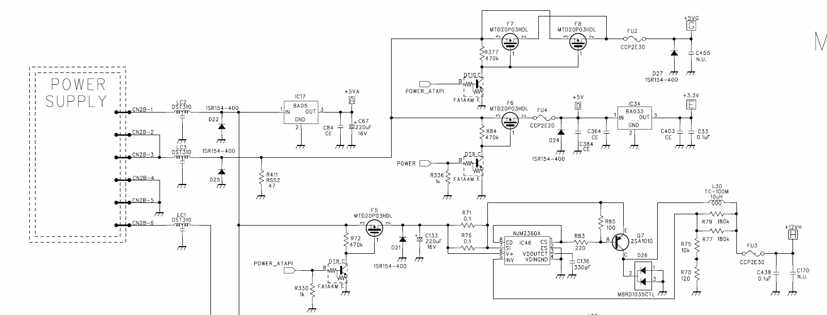

MOSFETS 20A....30V or 60V?
I have a circuit with MTD20P03HDL which has blown. I can get a MTD20P06HDL
no problem, and wondered if someone could tell me if this would be able to be used instead. The specs look very much the same except for the Voltage.
If anyone has a Korg D1600 Schematic...it is F6 (see the image of circuit)
Summary is can I use a 60v instead of the 30V? Thank you
