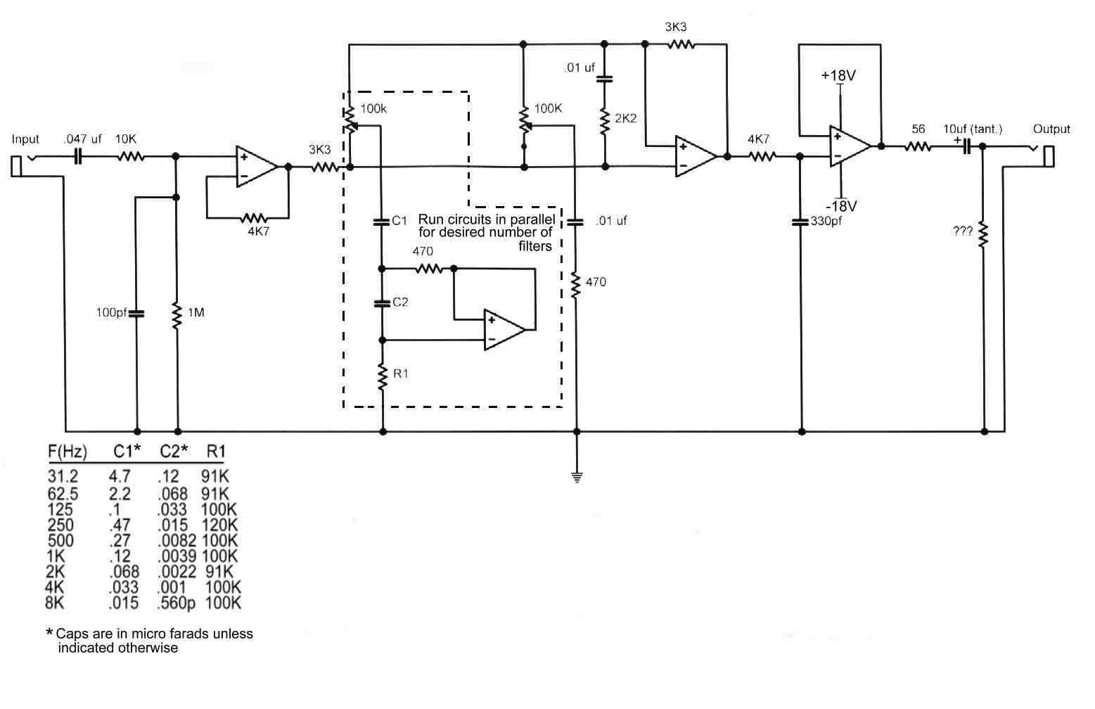

As for the op-amps this is the schematics which they apear on.
While i'm hear i am stuck on what the last resistor is at the end, labeled ???.

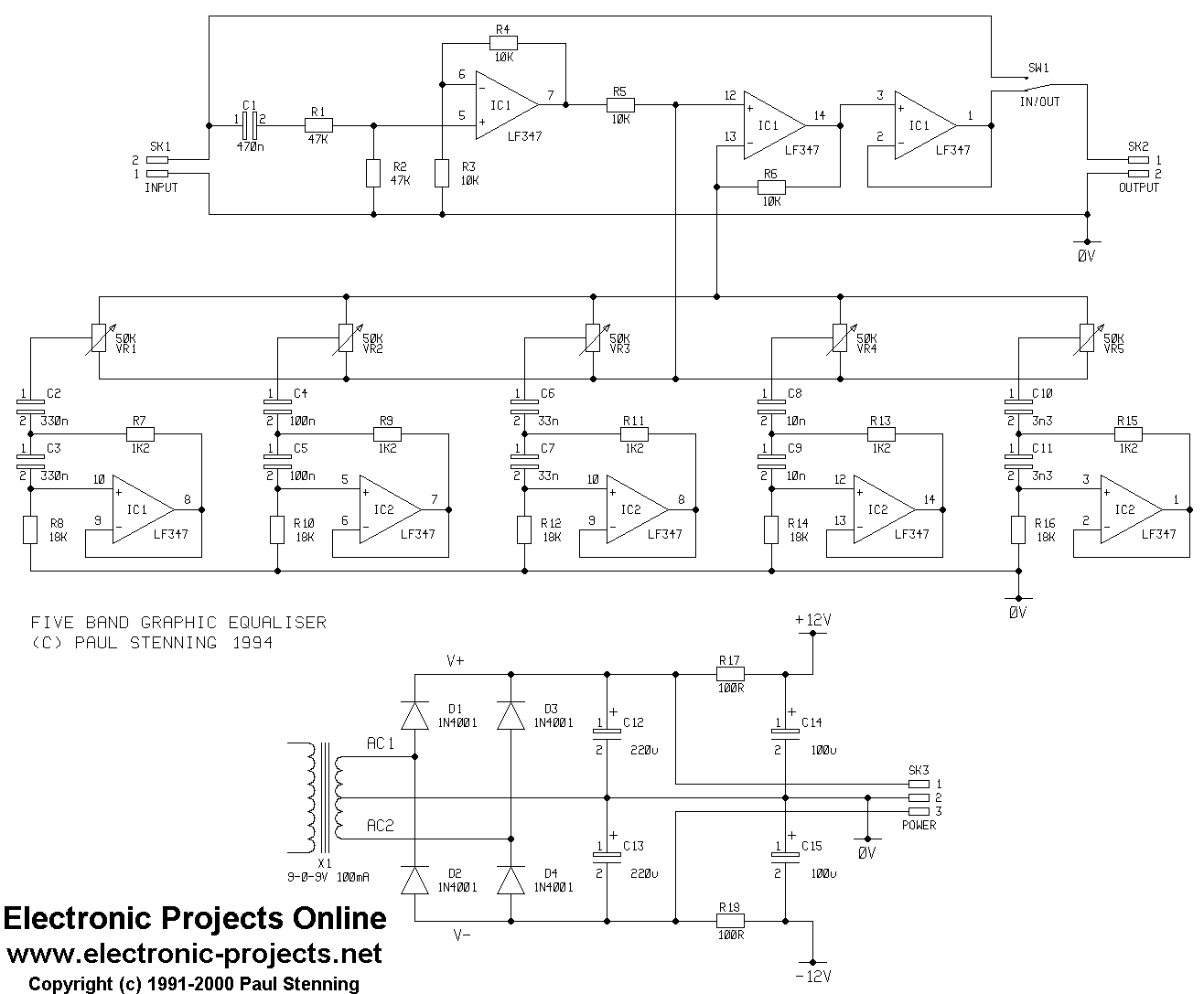

Russlk said:
the opamps with feedback to the positive input are not going to work!
They will work fine and the circuit is commonly used as a "gyrator" which is a simulated inductor. The inductor in series with C1 make a series tuned circuit. They are frequently used in audio graphic equalizers like this one:
audioguru said:
Except the ones in the circuit you posted have the output connected to the inverting input, NOT the non-inverting one?.
Which is the normal gyrator configuration I'm used to!.
Hi Nickname nooby,
Your circuit and the one I posted are audio graphic equalizers. They are tone controls that can boost or cut various frequency bands.
Each frequency band is adjusted to correct inaccuracies in the frequency response of speakers. Once the bands have been adjusted to correct the speaker's response, they aren't touched again.
I used to install a locking cover over the controls to prevent tampering.
I don't know why you want to bypass only the one you are adjusting. Usually a graphic equalizer has a button to bypass them all so you can hear the difference between the original un-equalized response and the corrected one. :lol:

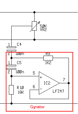

Here is the gyrator part of the circuit that I posted:
I just noticed that every single opamp except the 1st one in the original post have their + and - inputs backwards! :lol:
