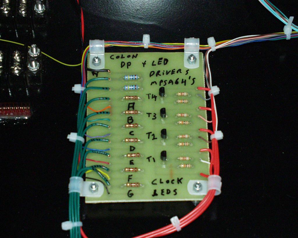

OK, here's what I have (see attached)
They don't make sense to me.
First pic is of the actual board.

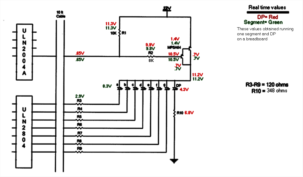

Second pic is of when I breadboarded one segment and DP and logged values (in colors).
Based on those values I made the actual board, etc.

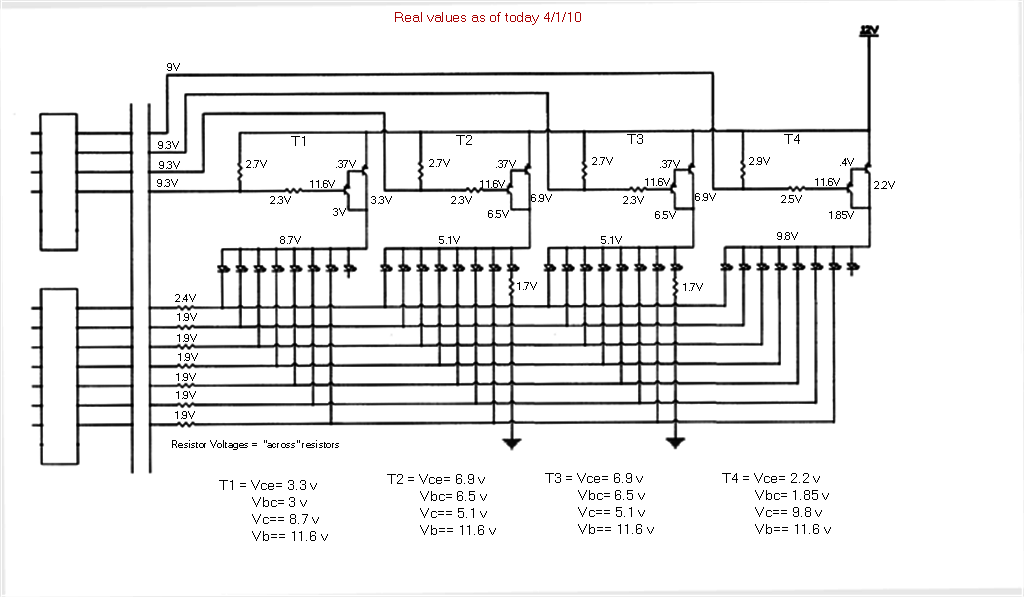

Third pic is of the whole show T1-T4, I did this because the values varied when I would of thought they should be all the same, etc.
So, there ya go.......
PS-> that base resistor is actually 8K2, not 8K.....
Also, forgot to list Vbe values but they are there on the schematic....
These values obtained with LEDs set at "0000" ('g' segment values would be "0")

I guess you measured these values using a voltmeter.?
If so the you have a problem trying to determine the actual voltages because the LEDs are multiplexed.
This means the Velleman PIC switches ON each LED MPS transistor driver in sequence, ie: D1 on, D2 to D4 off, then D2 on and D1,D3,D4 off and so on, then the sequence repeats.
Ideally each LED is only on for 25% of the time, as the scanning sequence is so fast, the eye see's the LED's as all being on.
So when you measure with an ordinary voltmeter you will not see the 'actual' voltages.
The way to read each voltage accurately is use an oscilloscope.
Just done some calculations and simulations on your circuit.
The 120R is allowing 66mA to flow thru the led for a 25% ON duty cycle, so thats approx 16mA average.
You could push it to about 20mA by using 100R on place of the 120R, but it will be a little over the specified limit for the LED.
I would suggest you search for a more efficient LED that will give more lumens/mA.

OK, lets do this, you have given me a value of 100 ohms for the segment LEDs.
If you would, give me a value for the DP LEDs
and I'll try them and see how they act, etc...
I need to see if I can make do with these LEDs, hate putting out the bucks for new ones and have these collecting dust.
If after all that and they still arn't working well, I guess I'll have to break down and buy some new ones......
I appreciate your help on this thing, nothing was said on the other forum about taking into consideration the average voltage verse the non multiplexing voltage, etc, etc.
Now I'm having to consider Lumens/ma, whew, will be glad when this thing is done....

OK;
Replaced the resistors and can see a big improvement.
Measured current of one segment and it reads 23ma, am just going to have to live with it.
The DP's actually look about the same brightness, so am going to say "I'm happy".
And, I think that will wind this problem up and I can finally move on.
If they mess up down the road I certainly know how to deal with them now.
Thank you so much Mr Gibbs, I've learned a great deal, you've solved my headache.

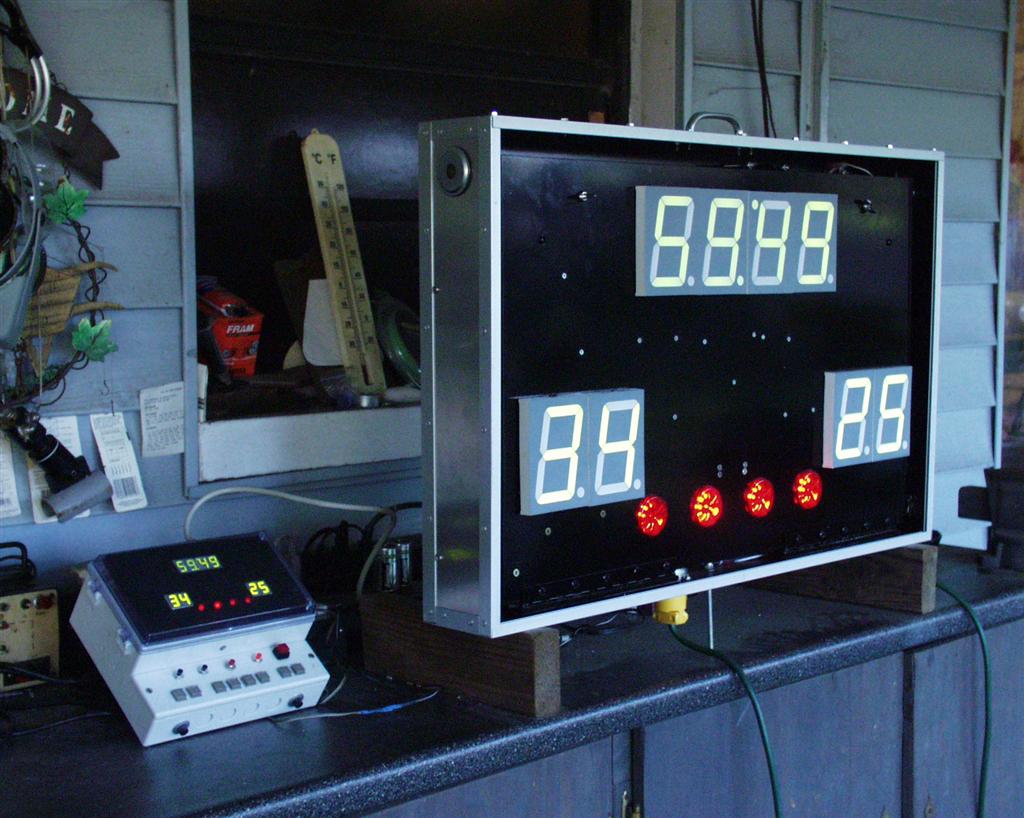

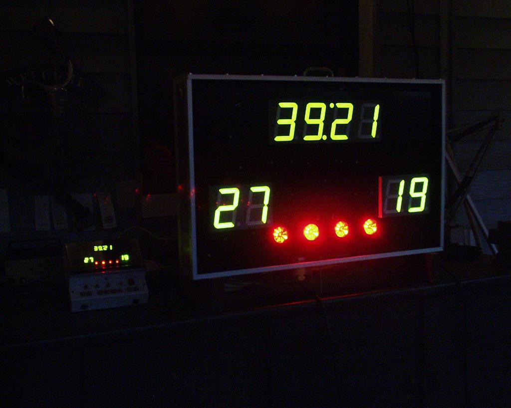

Here's a couple pics of the scoreboard in action.
Everything working perfectly.
Doesn't like the daytime too much, but, just too bad.
Thanks so very much........

hi D,
Looks good.:)
Have you tried placing a sheet of 'green' transparent film in front of the big green LED's?
It should reduce the reflection and also hide the unlit segments.

Hi Mr Gibbs;
Nope, never heard about green film (will look into it).
I did find a nice piece of flat black foam board that I cut out the LEDs dimensions and it fits/looks good, also got a clear piece of plexiglass for the final front piece.
Just got to get a stand for it now, and get it out of my house ! ! ! ! ! !
Sure hope it works for years to come, I don't relish ever seeing it again.....
Almost a year and a half messing with it, and being dumb as a log, has been a journey....
