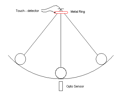

The best I can think of is:-
An active light beam sensor underneath the pendulum
reflected light from the bob will give a positive detection of mid-swing
To detect extreme of swing is tricky as you need to cover 360 degrees of rotation,
are you using a shaped cone guide thing at the pendulum's anchor point?
could a metal ring be fixed around the pendulum (maybe part of the cone guide)?
as the pendulum reaches the exreme limit of its swing it touches the ring, this completes a circuit - simple conductors touching. You could argue that as the pendulum is at the extreme of its swing this interference is negligable ?
BUT
Why do you want this second sensor anyway?
Simply detect dead-centre with an opto-sensor or something and use this to energise the assistor magnet for a set time via a simple monostable timer circuit. The pendulum should be predictable enough for this ?

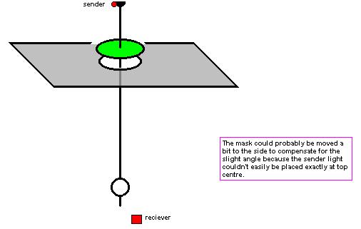

Hi Fried Circuit,
As you probably know, for a Foucault type setup to work reasonably
well it has to be a reasonable size. Also it has to have the minimum
possible interference with its freedom of movement.
The suggestion from mechie to use a circular contact near the top of the string is sound and if your unit is purely for demonstration that
would be the easiest way, and the most straightforward, and simple to
construct.
But it does rely on the pendulum having enough swing energy to make
the contact at each swing, so unless there is some mechanism for
maintaining the swing, it would soon lose momentum and fail to
connect.
An adaptation of this could be a disc mounted near the top of the
string, obscuring a fixed circular opening beneath it.
If the circular opening beneath the disc were somewhat smaller than
the disc, then the disc would have to move sideways to allow some light to pass.
To differentiate a signal light, it is usual to impose a frequency
upon it and give its receiver sensitivity to the same frequency.
This means of course that the unit can be viewed in normal light.
Briefly, the sensor would respond to outgoing swing past the set
radius, and cease to respond when the swing went inside the set
radius. Essentially the same as mechie put forward, but using a
mask and a disc for light.
Thinking about it, it might be possible to do it without a mask
i spose it depends on the sensitivity of he receiver.
I hope my little drawing shows the concept, its only crude but
you should get the idea. I don't think sensing the centre point is
a problem.
Best of luck with it,
John :)

foo-cou ?
john1 said:
Briefly, the sensor would respond to outgoing swing past the set radius, and cease to respond when the swing went inside the set
radius.
So if the sensor/light source cannot be dead-centre will it detect equally for all 360 degrees of rotation?
Maybe a pool of lights almost big enough to surround the bob weight, all pointing up at the fulcrum/anchor point such that with the pendulum at rest there is a shadow from the bob just big enough to cover a similar circle of sensors arranged in a circle around the fulcrum.
With this arrangement the bob takes the place of your card disk and there is less directional sensitivity.
I still reckon a simple detector for dead-centre triggering a timer would be easiest and most predictable.
I agree.
