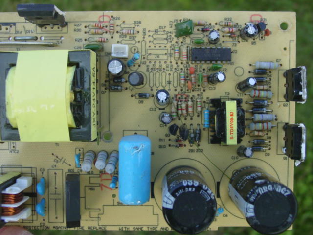

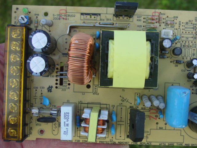

I'm taking the liberty of posting your pics of the PS here, in case others can suggest suitable test points:
I'm reading the pics as showing the mains input, rectification and smoothing along the bottom third or so of the pics.
Cap C6 (first pic bottom right) and its neighbour are likely to store a lethal charge for a while after power off, so BEWARE if poking around in that vicinity. BTW, what is that hairy thing running north west from C6?
Edit: One possible suspect is the mains bridge rectifier (that black thing just above the words "against fire" in the first pic). If only half of it is working the PS might show the volts sag you get under load.
After a decent time from power-off, use your DMM diode test function to check it by probing between two of its pins at a time with both probe polarities (assuming you can get to the back of the pcb). You should be able to get four sensible similar diode readings ~700 (they will probably drift because of C6 etc).

Any well-designed SMPS would have a bleed resistor of 1meg or so connected across the cap to discharge it in a few seconds. Best to allow an hour or two. Time to put the kettle on!
Check for conformal coatings. an insulator on the board. Measure cap voltage when on and about 5 min after turn off. Use the 1 hand in pocket rule or a probe in each hand.
The voltage rating of the caps is a good indication of the max 400 VDC. Mains rectfied.
The bridge shoule be labeled ~ and ~ and I expect line voltage there.
Look at - to and + to each ~. Expect ~ +- 0.6 V. ~ to ~ line votage and - to + ballpark 400 VDC. Also look at AC voltage at the 400 V point.
On the mains bridge rectifier I got 477and 475. With probes reversed, both were 1.
The only thing I could find labeled at the bridge is BD1.
Does not seem to be any conformal coating.
Do you want me to check C6 or its unlabeled twin? I'm gonna call it C7. The negative terminal of C6 is connected to the positive terminal of C7.

Agreed. Well that's one suspect eliminated from our enquiries. Without a schematic of the PS it's difficult to know where to check next. ESR measurements for the caps are out of the question without suitable test gear, so a shot in the dark would be to use the DMM to check all diodes (anything labelled 'D...' . or having a single coloured bar at one end) on the board.
OK thanks, I'll check the diodes. If they're good, I'll throw in the towel. It's pretty cool to even take a stab at fixing something like this. I'm pretty sure the damage occurred when the wire from the - battery slipped and touched the + battery terminal that still had the wire hooked to it. I think I'd have noticed the power indicator LED on the PS flickering. In any event, thanks for the redundancy of 2 PSs.

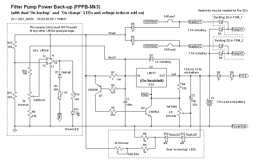

It's a cute little fan. It's being driven by 12.9V. No idea how many amps, no label. Could a little fan like this be connected to the same leads as the green LED charging indicator to blow on the LM317?
Could a second red LED be added to the first 'battery in use' red LED? I think having one in the fish room as well as the circuit board would be good. The circuit board will live in the basement, directly below the fish room.
Can't connect it there (it draws more current than the LM324 can provide). But you could connect up another '317 (seeing as you have a box-full :)), powered from the +Vext point, to give another 12V output dedicated to the fan only. The fan could then cool both '317s ! If you want to do that I'll draw up a schematic.
. Yup. Here you go:-
This schematic (FPPB-Mk3) incorporates changes to date and adds the second 'on backup' LED. Note new values of resistors R5,R6 and added 'SetLEDs' trimmer. The trimmer enables LED contrast between 'on' and 'off' to be maximised.
