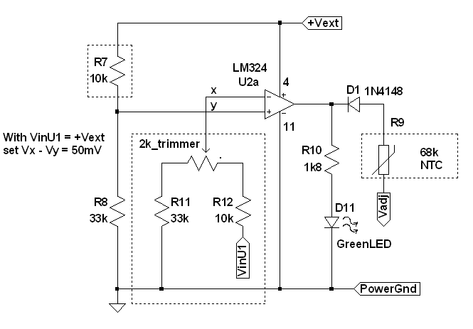

If you haven't already found the bug here's the green LED fix (hopefully!):-
This trimmer needs to be adjusted with the battery disconnected, with either or both power supplies on, and with R1 temporarily shorted across so that VinU1 = +Vext. Set the trimmer such that the voltage at the inverting input (marked x) of the opamp is ~50mV greater than the voltage at the non-inverting input (marked y). If you don't yet have the NTC 68k resistor use a 100k ordinary resistor for now.

Good. Setting the trimmer was probably a bit fiddly?
Is this the part we want for R9?
Similar sort of thing, but 68kΩ, not 68Ω :)
The trimmer was not too bad to set. I got 15.31V on X (pin 13) and 15.82 on Y (pin 12).
Thanks for catching that 68K!
Should be the other way round, i.e. volts on pin 13 > pin 12

So the LM317 is doing its job. Good that it's not getting too hot. It will take quite a while to fully charge the battery. In theory the charge rate starts off at ~ 0.5A then drops slowly down to ~50mA, at which point the green LED should go off, marking the end of the bulk charge. Charging then continues as a trickle.

With battery disconnected, I took a quick reading before work and X (pin 13) adjusts from 15.11-15.76V. Y (pin 12) remains at 15.85V. At this point, I can't give X more voltage than Y.
If you've 'run out of trimmer adjustment' it's likely because of resistor tolerances. A 1k resistor (or the closest value, <2k, you have to hand) inserted between the end terminal of the trimmer and the top of R11 should solve that and allow the pin 13 voltage to be set higher (15.85V + 0.05 V).

I installed a 1K between R11 and the trimmer. With the battery disconnected, the adjustment range for pin 13 is now 15.22-15.85V. So close..

I replaced the 1K with a 1K5 and the max V at pin 13 is now 15.90V. I'm letting the pumps run on the battery while I eat dinner, can't wait to see if we got it.

No. The 317 will be hot when its pushing 0.5A + into the battery, since it's then dissipating ~ 0.5 x (21-13) = 4W. It's built to cope with more than that and has internal temperature and current limiting. Can't recall how big the heatsink is, but if you could bolt on a bit of extra metal sheet to extend it that would would drop the temperature. Don't forget the heatsink is at power supply voltage, not ground.
As for no indicator light, you did remember to remove the temporary short across R1?
What voltages do you get at pins 12, 13, 14 of the LM324 when the battery is charging?
With the battery charging, there were 15.83-15.84V at pin 12, 15.75-15.76V at pin 13 and 0.94-0.95V at pin 14.
After your last post I realized that I never did short R1. Sorry. So I disconnected the battery, jumped a wire across R1 and got pretty much the same numbers. 15.83 at pin 12 and 15.89V at pin 13.
Something fishy at pin 14. If pin 12 > pin 13 (as it should be when charging at 0.5A) then pin 14 should be > 10V.
