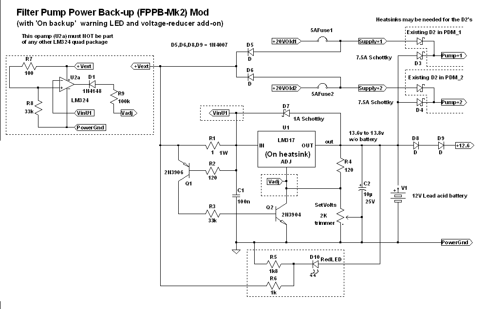

Edit: Now that you've got the filter pump system up and running you might like to consider the add-on in the attached.
Although the battery charger has both current-limiting (for the bulk charge) and voltage-limiting (for the top-up charge), further research indicates a refinement is to knock back the charger voltage from the 13.8V limit to 13.6V once the battery is fully charged if it's to be left on standby continuously. The add-on will do this by sensing when the charge current has dropped to ~70mA. It uses an LM324 which MUST be separate from any other since it runs from ~20V. The pic shows the 4 connection points to the FPPB-Mk2.
It's only a few extra components, with parts/values you may already have, and can be built on its own for addition at a later date or incorporated on the FPPB board. Should prolong battery life a bit since it terminates what would otherwise be a continuous trickle charge. Pity it can't use one of the spare LM324 opamps in the filter system FSM.

Should a 0.1uf cap be installed between pins 4 & 11
Yes. You're getting the hang of things!
should pin 11 be connected to signal ground
It connects to PwrGnd actually (the only ground in the FPPB).
pin 4 to 12.6V?
No.
it looks like LM324 gets energized from Vext.
Spot on. I used that label to distinguish from the other + supply voltages. In other words it gets the same voltage as the input of the charger.

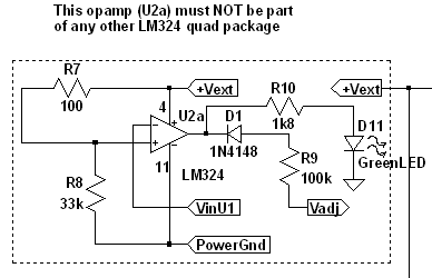

BTW, if you fancy an indication that charging is taking place you could connect one end of a 1k8 resistor to the output pin of the U2a opamp, connect the other end of that resistor to the anode of a LED (green?), and connect the LED cathode to PowerGnd.
Incidentally, when you were setting the 317 output pin voltage to 13.8 did you have the battery disconnected?
I do like the idea of a charge indicator. Just want to make sure I've got it right-the 1K8 would go between D1 and the LM324. In other words, we are using the same three LM324 pins as the mod. Is that right? I just finished the mod, I'm sure I can sqeeze a few more parts in.
I don't remember if I had the battery connected or not when I set the 13.8V. It sounds like I should disconnect the battery and re check.
Correct. Like this (the LED cathode ground being PowerGnd):
Good idea. The voltage setting is critical to correct charging. It's the voltage at the '317 output pin you need to measure; not at the '12.6V' output. I take it you've got the '317 heatsinked? It will get hot when putting ~ 0.5A into the battery.
Would it be OK to connect the unused inputs from this LM324 to the power ground that is connected to pin 11?
Yes. I was going to mention that but you beat me to it :)
I'm keeping my fingers crossed that the added LM324 will work in practice as it does in simulation. Its signal inputs are above the specified "supply voltage - 1.5V" limit, so we're pushing our luck. Two different simulation models think its ok, but in the event that it's not then a couple of extra resistors and a 2k trimmer will do the trick (hopefully there's room to squeeze them in if necessary).
The '317 is on a heatsink, thanks for making sure. Heck yes, if we need to add a few parts they'll fit somewhere. Thanks.
.....and another minor tweak (groan :(). The perceived wisdom is that for a battery left on float charge there needs to be some reduction of the charging voltage as temperature increases. This could be done by replacing R9 in the post #2091 pic with a 68k NTC (= Negative Temperature Coefficient) thermistor. Only a few cents, next time you're ordering components. Ideally the thermistor would be in thermal contact with the battery and connected back to the pcb via a screened pair of insulated wires, or at least a twisted pair.

I got the output of the LM317 adjusted to 13.83Vwith the battery disconnected. I’m glad that won’t need any more adjustments-the tiniest turn on that pot changes the V a lot.

The green LED to indicate the battery is being charged stays on no matter what, when there is power. If the pumps are unplugged and running off the battery, the green LED is on. I’ll go over it tomorrow with a fine toothed comb.

I expect the green LED issue is because the LM324 in reality isn't working as per the simulation, as I mentioned in post #2092. I'll look into a fix.
