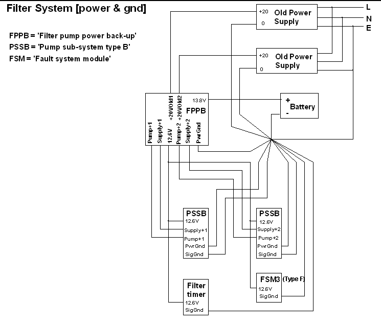

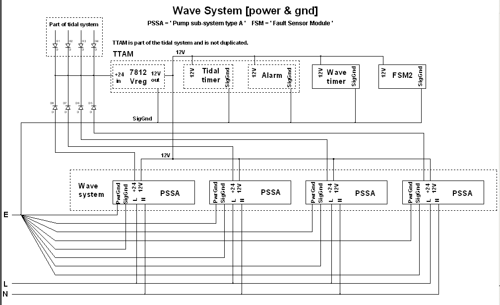

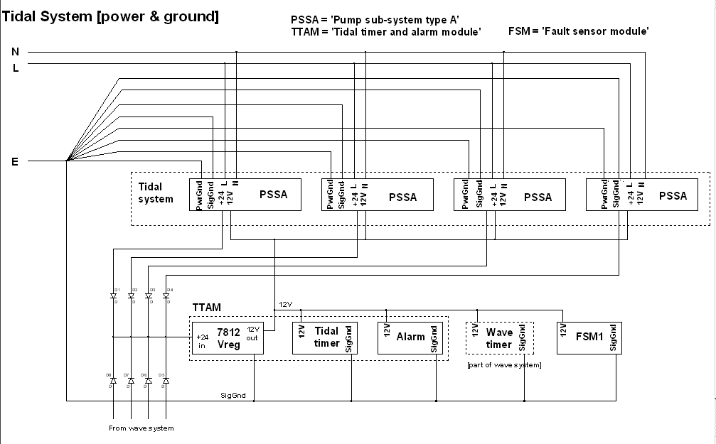

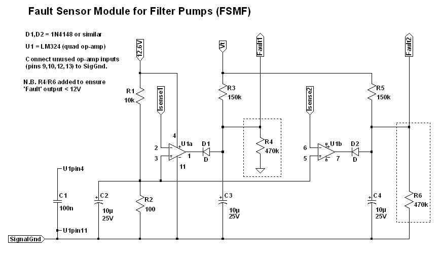

You only need two (one for the tidal pumps and one for the wave pumps), since each Mk1 handles up to four 'channels' (pumps). The filter pump system is odd man out and the FSM Mk1 needs modifying to suit. Here's the mod (re-named FSM-F):
I tried drawing the power/gnd wiring for the whole of your mammoth system (wave, tide, filter) but found that it wouldn't fit on an A4 sheet as the text was too small to read. So I created a hierarchical drawing with separate wave, tidal and filter sections each on an A4; each section including pump 'sub-systems'. The wave and tidal systems each have 'Type A' sub-systems; the filter system has 'Type B' sub-systems. A separate A4 drawing shows the make-up of the two types of sub-system.
Here you go:
PumpSubsystems.gif WavePumpSystem(power&gnd).gif TidalPumpSystem(power&gnd).gif FilterPumpSystem(power&gnd).gif
Are you ok with adding extra 'channels' to the Alarm module in the TTAM? Only 4 are shown but the extra 6 are analogous.

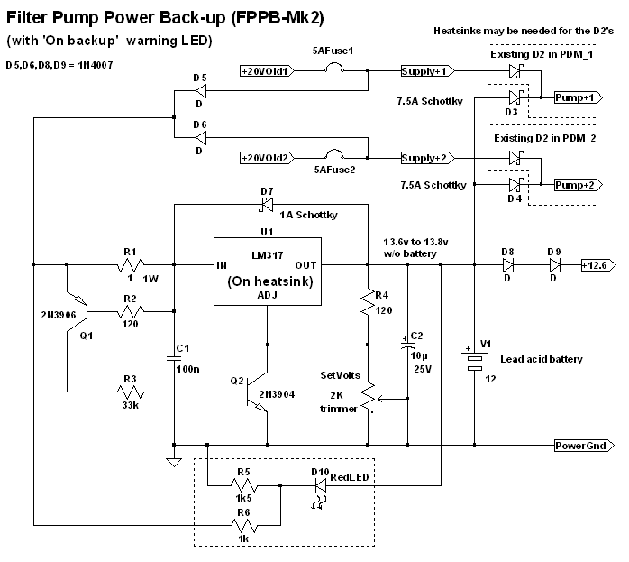

And here's the revised filter pump power back-up arrangement:
I hope I've covered all bases, but may have forgotten one or two features :D

...but not, I hope, for the FSM-F that will be used with the filter pumps? That will use the 12.6V line.
4 input pins of the 6 unused pins can be grounded (as stated on the FSM-F drawing); but would probably be ok left unconnected, as KISS indicated.
FSM-F has two added 470k resistors. If you don't have that value then 390k will do (which I think you have).

I want to make sure I have this right-The Filter Pumps Timer (0-15 min) will get 13.8V from FPPMk4 (what I like to call battery backup). The two channels of the FSM-F for the filter pumps will also get 13.8 from battery backup. The two PDMs for the filter pumps will get 12V from the Vreg.
The battery backup I have is version FPPMk4. There are a couple extra diodes and R5 is 1.8K.

Thanks for the upgrade on the FSM-F, it’s done.
Yes (though the 13.8 will be ~12.6 with the mod).

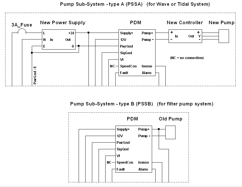

No. They'll get the 12.6V (see FPPB-Mk2). Sorry, I forgot to re-label the '12V' input to the PDM on the PSSB sub-system drawing :(
Superseded by FPPB-Mk2 (which still shows R5 as 1.5k).

Thanks for clearing up the voltage feed for the battery backup. So everything associated with battery backup gets 12.6V, except fot the alarm module. That makes it easy to remember.:)

Recommended. When it comes to assembling it all, are the various 'Vt' connections clear for you? In the various schematics some have been generically labelled 'Vt'; others have been labelled 'Vt1' etc. I've tried to be consistent (but may have failed :D). The principle is that where pumps are paired they share the same Vt; where they are not they have respective different Vt signals.

Somehow, there is 23V coming out of the 2 TTAM lines that connect to Vt in the PDMs. I did not think to check the V before hooking it up. Am I correct to assume that I probably fried the ICs in four of my PDMs? :( I temporarily installed a 0.1uf cap at C10.
Very likely.
Oh dear! That suggests either a) the input to the 78L12 reg has a wrong connection directly to the '12V' output line or b) the 78L12 has failed short-circuit. I suggest you disconnect the 12V input to the PDMs, disconnect the 78L12 output from everything else in the TTAM then power up the TTAM and see what voltage you get at that output. If it's 12V then reconnect that output within the TTAM and see what voltages you get at the '12V' output and 'Vt' terminals of the TTAM. Only when you get 12V at '12V' and Vt should you reconnect the PDMs (one at a time, testing as you go). With a bit of luck the ICs in the TTAM and PDFs might have survived 23V.

There is 12V coming out of the Vreg, so I re-connected everything. The tidal timer seems to work just right! My DMM showed it toggling right along at 11.9V. On the flick terminal, after I slow counted to 35 or so the DMM momentarily showed 0.5V or maybe it was 5V but anyway it looks like the flick is active.
I must have had something hooked up wrong, IDK. Fingers crossed for the PDMs to be OK.
Looks like it. We've all been there, done that :). If the TTAM is now working ok its ICs must have survived, so there's a good chance the PDM ICs did too.

I was about to test the FSM and assumed Vt on the FSM gets connected to Vt on the respective PDM. Trouble is, Vt is shared between pairs of PDMs since the wave and tide run in pairs.
In other words, we have four pairs of PDMs and each pair has a common Vt. (really 5 pairs of PDMs, but I'm not working with the filter pumps now)
Or maybe I’m going about this all wrong.:p
Your thoughts would be much appreciated.
Not a problem. Let's say pumps A and B are a pair driven by PDMa, PDMb repectively and monitored by channels FSMa, FSMb respectively. Connect the single Vt of pair A/B to PDMa, PDMb, FSMa and FSMb. There will, however, be two different Isense signals going into FSMa, FSMb respectively.
