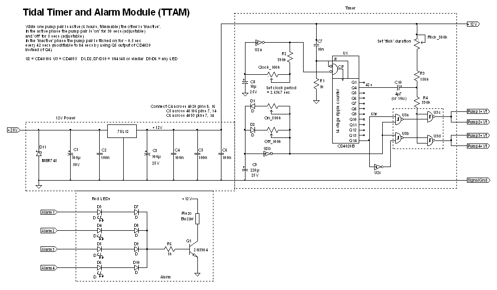

Got the email thanks. Wow, that timer version is ancient. Here's the most recent one which I think represents what you built:
Awhile ago you had me change a cap ,IIRC, to “stretch” the adjustment of the flick because the flick was too long.
From memory the cap C10 value was increased from 330nF to 4.7uF because the flick was too short. Also R3 was introduced to 'stretch' the adjustment. Since then various changes were made to the PDM, which could have affected pump start-up rate and hence the flick. Try with C10 = 330nF (or thereabouts) again.

I can't figure out how to hook up pin 10 or pin 11 in the 4020 in post 2004. I don't understand what CP or the symbol beside CP means. I assume R means reset or pin 11.
I tried to make sense out the fried tidal controller-it really is a bird nest.
Is R pin 11 and is connected to C7 and R1 and nothing else?
Does pin 10 get connected to R2 and U2a and nothing else?

Your going to care about pin 10 (Clock or phase 1) and pin 11 (reset)
C7 and R1 perform a rudimentary power on reset. At power-on the cap can be assumed to be shorted for a short time. Hence, the midddle of the network connects to the reset pin or R. Just don't go looking INSIDE the IC for pin R.
Pin 10 comes from the oscillator made up of U2a.

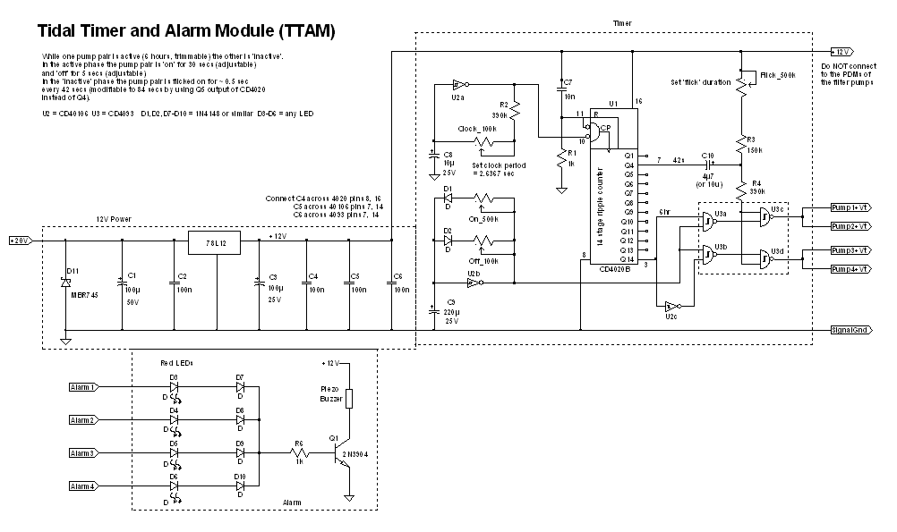

Hi Joe.
I understand your confusion, as the LTspice symbol differs from the one in the datasheet.
Here's the schematic with the relevant pins numbered.
Thanks Alec. It hooks up the way I thought, but we all know what happened the last time I hooked things up the way I thought they should go. Thanks KISS, I think you were saying the same thing but I was still unclear. Now I can go with confidence-thanks all.
The unused even numbered pins on 40106 need to be connected to signal ground, is that right?
I want to add a green LED (power indicator) as well as the alarm module to this board. Can I use the signal ground or should I bring in a power ground?
Er, no. Those are the gate outputs, which should be left unconnected if not used. It's the unused odd number pins which need grounding.

Signal ground is right for the alarm module. BTW it's ok to use a single alarm module for all the pumps (tidal, wave and filter). Just take the 'Alarm' outputs of the respective filter pump PDMs to respective diode inputs of the alarm module (which can have as many inputs as you like).
OK, thanks I'll ground the unused odd numbered pins. Ohhhh that would have been bad!
By "this board" I meant the one I'm working on (TTAM).
If an LED is connected to 20V, would I need to bring in power ground or could signal ground be used?
Signal ground is fine. It's only the pumps themselves and the PDM FETs which pass significant current (Amps) and need PowerGnd. Everything else draws only mAs and can use SigGnd.
