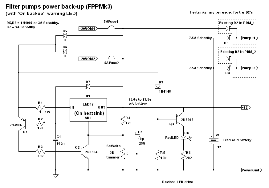

For a flicker cure, try connecting a capacitor (at least 10uF) between the R5/R6/D8 junction and ground (observing polarity). The flicker could be due to ripple on the power supplies, or switching action of the LM317. If that doesn't fix the flicker I'll have another think about the LED circuitry.

What is providing the Vt signals for both PDMs? Are you using the feed timer circuit?
Edit: With both PSs switched off and the pumps running off battery, check that both PDMs are getting ~12V on their +24V input, ~12V on their +12V input and ~12V on their Vt input.

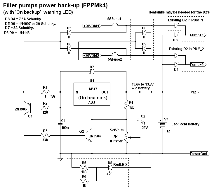

Here's FPPMk3 showing the revised LED drive
The pair of PDMs for the filter pumps have a common terminal point for both Vt connections. I ran 12V to the common Vt terminal point as well as the 12V terminal point. The 12V is coming from our controller.

I've just spotted a bug in the FPPMk3 in post #1996 :o. Here's a corrected version:
Edit: Further correction....added diodes 'D8,D9' should be labelled D9,D10 respectively.

I think my 7812 Vreg died. I get 19.6 V on the input and less than 2V on the output. It did get pretty hot when I left a wire loose and the pumps kept running. (it was either a cathode or an anode wire from the battery backup-I can’t remember). That was a couple days ago, and the system died tonight. Plus, I must have a crossed connection because before the Vreg died, The PDMs were pulsing as if on the tide or wave mode, even though I ran 12V to the PDM’s Vt and to the PDM’s 12V. At this point, the battery backup was disconnected. I removed it to try and pinpoint the source of trouble.
I have to agree....it's dead.
The 'loose wire' perhaps caused uncertainty for a PDM as to whether it should be on or off, which wouldn't have helped. With the diode failures you experienced, 24V may have somehow got back to the reg and killed it.

Presumably you weren't running 12V from that failed Vreg to the two filter pump PDMs? They should be getting their 12V from the FPPMk4 instead. The two sources of 12V should not be interconnected or things could fry.
