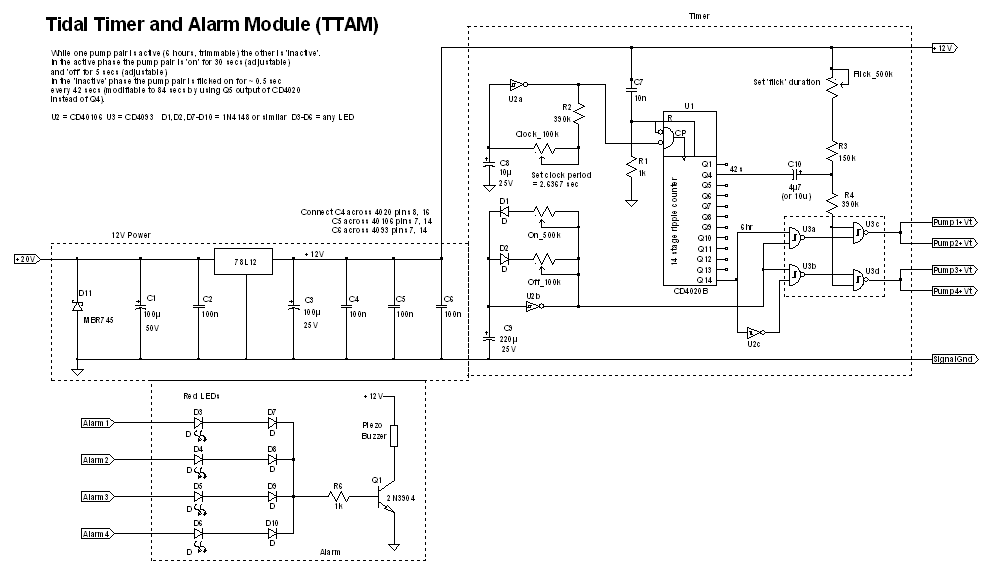

I'm trying to dial in the flick by playing with C10. One 0.1uf gives me almost enough flick with the trimmer adjusted all the way. Two 0.1uf caps in parallel is a teeny bit too much flick with the trimmer adjusted the other way. These are radial caps. This cap has the value I'm looking for, but is a different type of cap. Is it likely to work here?

To save sending off for another cap could you just leave C10 at 0.1uF but replace R3 (now 150k) with ~270k-390k?

I replaced R3 with a 390K, but don't have everything hooked up yet.

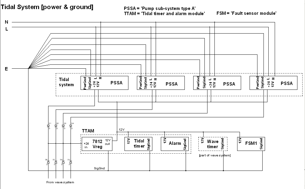

Awhile ago when I fired up the 8 new pumps I did not have the 8 diodes included as shown in the bottom left of the link. It looks like those 8 diodes on signal ground are connected to +24V. That doesn't seem right, but what do I know? Just double checking, can you please have a look?
Right now, I don't have the wave system hooked up because I just want to dial in the flick. I don't need to worry about those diodes for the flick test, do I?

https://www.electro-tech-online.com/attachments/74720/

The 8 diodes (they're not connected to ground!) provide the multiple redundancy you requested for the 24V input supply voltage to the 12V regulator. As long as at least one of the 8 new power supplies is operating the 12V regulator will get its 24V input (minus 0.6V dropped by the respective diode). So you do need to worry about the diodes (well, at least one of them):). No 24V input = no 12V output = no flick, no nothing.

I hooked up the tidal system but all four new pumps ran. The tidal timer seems to be toggling from 3.1V to 15.0V. There is 15.0V at the 12V terminal points. Leg one ofthe 7812Vreg is 23.7V, leg two is 3.1V and leg three is 15V??? I checked and it is a 7812. Last time I hooked it up, it ran like a champ...ugg. Bad Vreg? The only change I can think of is the 390K at R3 in TPASM and I disconnected one of the two 0.1uf caps in paralell at C10. I'll double check that the polarity is correct at C10 in the morning. I'm pretty sure all connections are right, but I'll double check.
On TPASM, I have a row of signal ground terminal points for distribution. I have a seperate row of terminal points for power ground. Should I run a wire to connect the row of power grounds with the row of signal grounds?
Check for a bad ground connection on the regulator. Try ohmmeter with the system off.
Ideally signal and power ground for everything should connect at one point, the power supply (-) terminal.
If this is your point of distribution, then power and signal should be connected together there.
This could be the problem with the 7812.
Leg 2 of the 7812 reg should be 0V, so there is a grounding problem. The reg puts out 12V above the leg 2 voltage, hence if leg 2 is not 0V you get the wrong voltage (in this case 12+3.1). The reg itself seems ok.
Yes, as KISS says. They must go to a common point (as per the star grounding arrangement I posted) connected to mains earth.
You guys nailed that one-thanks a million! The tidal system is back to working like a champ. :)

The flick is a bit much with 390K at R3 and 0.1uf at C10. I don't have anything between 150K and 390K. So I'm thinking of going back to 150K and trying this 1.5uf cap unless it's not a good cap for the job. I ordered it late last week.
Thanks again, you guys made my day.
Joe, two 390K in parallel is (in my head) 150+45 or 195K. Remember that formula works for same value resistors.
You can also try, two 0.1 uf caps in SERIES to get 1/2 the capacitance or 0.05 uf. In parallel, 2x the capacitance 0.2 uF.
