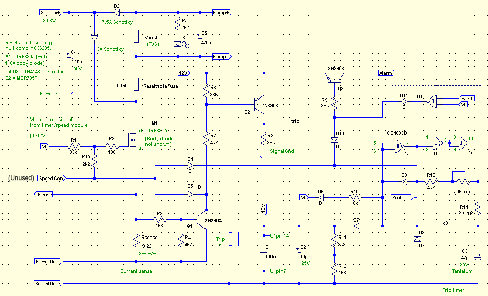

The cathodes of D4/D10 are connected to pins 2 and 4 of U1a
?? Pins 2 and 4 belong to different gates, so can't both be U1a. What do pins 1 and 3 connect to?

When the 'Trip test' button is pressed and the alarm sounds D4 should pull R16 low to keep the FET off for ~30sec. Perhaps there's a dry joint at the D4/R16 junction or at the D4/U1 junction?

U1a is 4-5, 6. U1b is 3-1, 2.
Pin 1 connects to R8/Q2.
Pin 3 connects to pins 8 and 9.
I'm working from the PDM-Mk15 schematic. I found it with a search, but the link was no good, and I can't seem to copy and paste from my documents. The anode of D4 is connected to D5/R1/R2. The R16 I have is in the snubber between the pump leads.
I'm going to pull the PDM from the array and re-flow the D4/D10/pin2/pin4 junction. Worst case this goes nowhere and 1 pump is unprotected. Fingers crossed and thanks.
:oops:My mistake; I meant R15 which, in the latest mod of the PDM, is a 2k2 which goes between D4 anode and the R1/R2 junction. IIRC R15 was added to address a stability issue, but may not be needed since the SpeedCon input is not now used.

Well then I put R15 in the wrong spot. I have it installed between the cathode of D5 and Q1/R7. I did not mention R15 because as I have it, it's not connected to D4. I'm virtually certain that every PDM is the same. Anyway, that PDM is pulled loose from the array, if I'm lucky I'll have some time tomorrow to work on it. Thanks for helping to get this little bug worked out.

Ah. I suspect we're not singing from the same hymn sheet. I think your schematic is slightly earlier than the one I was looking at. But hey, if the other PDMs work leave them as is.

Check C3 has good connections. Check R14 isn't shorted.
I'll post my version of the PDM schematic to ensure we're looking at the same thing.
Maybe you could measure the voltage on both sides of D4 before and after you push the trip.
What is the voltage on C3 before you push the trip?
Yes, that's the schematic I'm working from, with a few differences.
R15 is between D5 and the R7/Q1 junction. The unused SpeedCon is also at that junction.
A snubber is installed between the pump leads.
C3 is a radial cap.
I can't find any problems at C3 or R14. There's virtually no resistance between the positive leg of C3 and pins 5 & 6, R10, cathodes of D9 & D8, R14 and anode of D7.
With pump running, I got 11.65V at the anode and 12.05V at the cathode of D4.
Holding the trip button down, I got 1.24V at the anode and 10.81V at the cathode.

There's virtually no resistance between the positive leg of C3 and pins 5 & 6, R10, cathodes of D9 & D8, R14 and anode of D7. With pump running, I got 11.65V at the anode and 12.05V at the cathode of D4.
All as it should be there.
Not right; should be about 0.6 at the cathode. What is C3 voltage about 1 sec after the trip is pressed?
With the pump running C3 has about 7.80V. When the trip is held down, it shows 10.45V. When the trip is released, the V drops gradually to just below 7V then cimbs a little to 7.80 or so.
This time with the pump running the V at C3 dropped to below 6V and about 1 sec after the trip is pressed there was about 8V. That's holding the trip down.
That's what I'd expect.
Hmm. Shouldn't be that high. That voltage ought to drive U1a output (pin 4) low and sound the alarm/switch off the pump. Can you re-flow the joints at U1a pins 5 and 6?
Re-flowed pins 5 & 6. Rats, no change. Re-flowed the entire D8/R10/D7/D9/R14/C3 junction too.
I'll check U1a now.
Can you confirm how U1a output changes (if at all) when the trip test is/isn't pressed for at least 1 sec?
U1a is 4-5,6.
With pump running, 12.04V at pin 4. With the trip held down after about 1 1/2 or 2 sec. V drops to 10.73. When the trip is released, V is 11.23 after a sec or two. Then V climbs for another 10-13 sec to 12.04.
