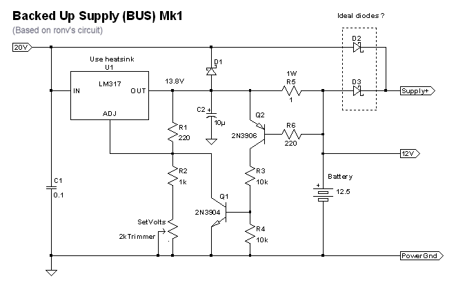

BTW a sim of the ronv charger in post #1513 shows that when the 20V supply fails the battery tries to drive >10A back through the supply via D1. We don't know if the supply can handle that. Looks like we'll need a power diode (D1 re-purposed?) between the LM317 output and the battery.
I think that is an artifact of the voltage source in the simulation since it will have a low resistance to zero volts. With the real supply, assuming its a switcher, the only thing on the output of the supply would be the filter caps in the supply. But we can check it.
Actually why don't we tie it to +pump? Then the diode that is already there would block it from feeding back and we wouldn't have 2 diode drops.
We need to diode-OR the 20V and battery voltage. The diode already in the PDM could be part of the OR, but then it wouldn't be in a position to block the reverse current. Those ideal diodes that KISS posted a link to could be an alternative to the discrete power diodes already considered.
Looking again at the charger in post #1513, the 1Ω current sense resistor is in the path of the battery charge current (as required) but is also in the path of its discharge current so will drop several volts when the battery powers the pumps. Here's a mod which has the resistor in the charge path only. It needs a second transistor (Q2) (unless you can see some other way of doing it, Ron?).
Edit: Joe, don't build this yet; it's a draft only.

Yea, I noticed that when I was drawing in the diodes. The other thing I noticed was the 7812 would be back biased and burn out during a power fail so I think we can just take it out.

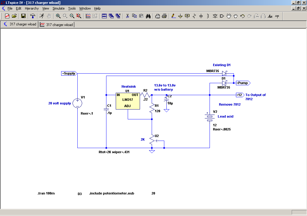

Here is a simple version that I think solves all the problems so far.... Cost reduction:D:eek::D
It's certainly simpler, but means higher power dissipation by the LM317. If, for example, the battery has discharged right down to 9V the LM317 will be dissipating nearly 9W at a charge current of ~0.85A. So the loss of Q1 and Q2 will probably mean a bigger heatsink will be needed, so not necessarily a cost reduction. Joe's choice. Also, there's no obvious protection from reverse current through the LM317 or the 20V supply. Here's a mod showing the connection to the two filter pump PDMs, and with D1 to block reverse current. According to the datasheet the reverse current from the 10uF cap discharging won't harm the LM317.
I thought Joe had some heatsinks for the FETs that are pretty big. The 317 is thermally protected but if the power is to high for his heatsinks we can increase the .22 ohm resistor. I chose it because I figured Joe might have a leftover. :D
I think where the input to the 317 was tied before - on the cathode side of the existing diode protects it.

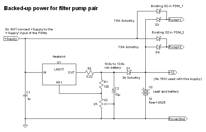

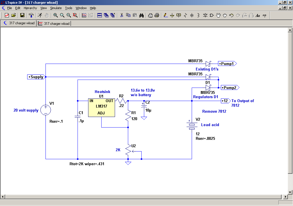

Here's a mod showing the connection to the two filter pump PDMs, and with D1 to block reverse currentAccording to the datasheet the reverse current from the 10uF cap discharging won't harm the LM317..
I don't think D1 is required if the input to the 317 is moved back to the other side of the PDM diode

I guess I didn't know there were multiple regulators. If so having just the 2 pumps on the battery would save a little power for the battery. Joe, I know it is kind of modular. Is it easy to isolate the 12 volts for the filter pumps from all the other PDMs?
Sorry, I didn't show the 2 pumps. So yes, we would need 2 diodes from the battery to each one.

If it is easy to isolate the other pumps +12 from the filter pump +12 we could do that. Otherwise it is probably easiest (at this stage of the game) to just run all the low power logic from the battery when the power fails.
Early on, I put a 7812 reg in the wave controller and another 7812 in the tide controller. There was concern that they would be in conflict with each other, so I disconnectedthe 7812 from the wave controller. The 12V for everthing flows from the single 7812.
Glad the battery is not running a heater! Here's the heatsink. https://stores.ebay.com/Tayda2009/_i.html?_nkw=heatsink&submit=Search&_sid=872591586
I only want to run the two pumps on speed control with battery backup, hopefully on a slow speed to buy more time.
So unless the filter pumps are on a separate board it would not be easy I guess.
